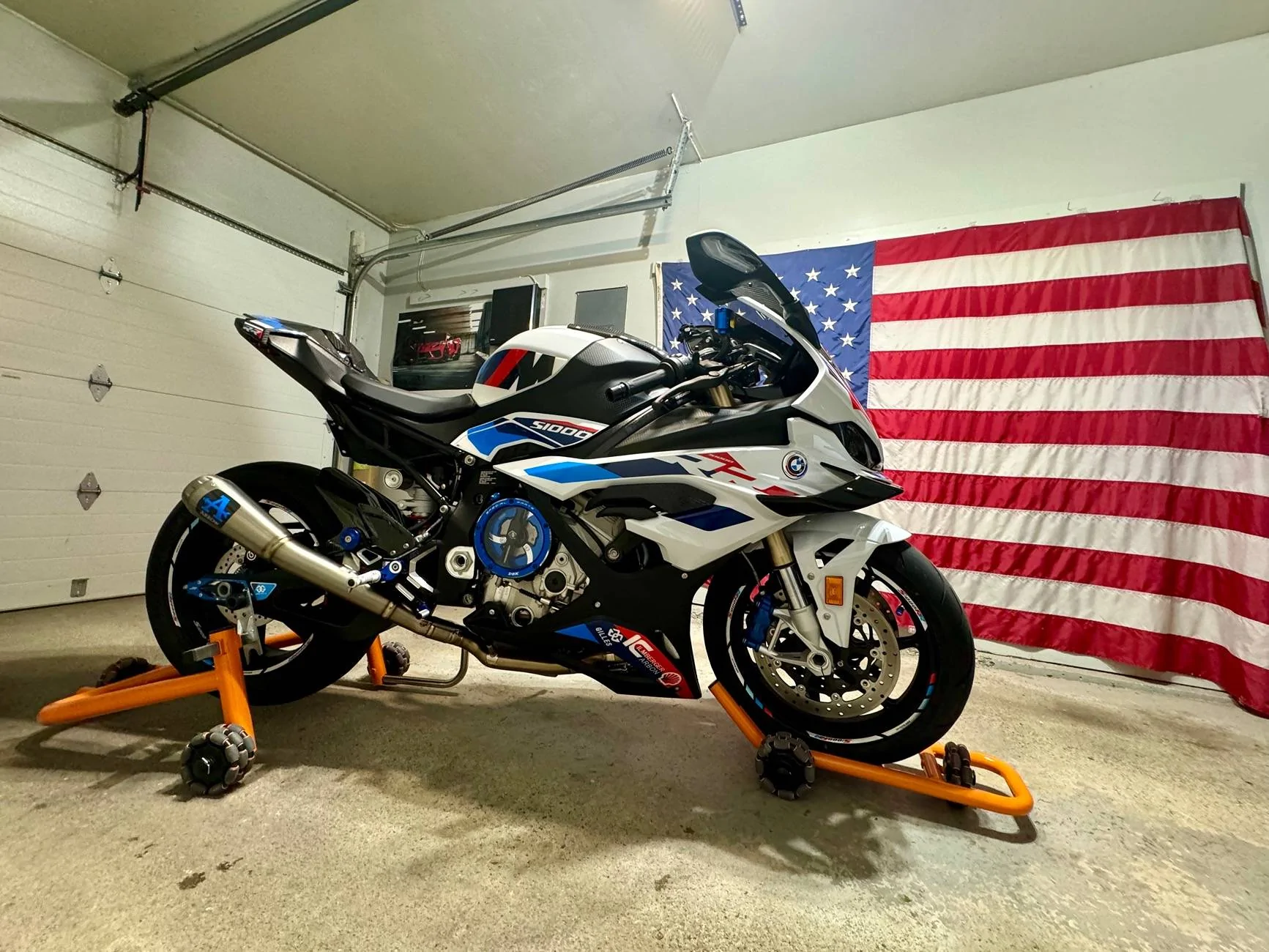

I plan to put this in the cybertruck in the summer.
Links to straps and metal holder you got?
The straps I used don’t have safety latches, only hooks in the end-get safety latched straps. And as far as the front wheel chalk-they make better ones designed to be adjustable to pickup beds-I’d get one of those. The RAMP I GOT on Amazon:
Bike Ramp 89.8"*12" 1500LBS... https://www.amazon.com/dp/B0DJKNQ1X8?ref=ppx_pop_mob_ap_share. CHINA made, but built well and has a 1500lb weight rating of which I didn’t believe but it easily withstood the load of my Panigale at around 400lbs. I would have felt safe riding the bike up as well, but didn’t-clutched it up from the side.

I plan to put this bmw s1000rr in the cybertruck in the summer.
Smaller bikes fit easily (K1300S and friend with Road Glide here). Home Depot ratchet straps work fine. Front tire holder not necessary. BUT you may need to space the front wheel back from the firewall as the fairing may hit the roof (where the cover slides in). I had to use a 4x4 and mine barely cleared. Rear wheel was on tailgate. Friend's Harley is right at end of tailgate.
Be sure your ramp is wide enough if you are loading alone, might need to dab a foot going up/down the ramp.
Unloading trick you probably know: put the bike in first, use the engine as a rear brake via the clutch. Front wheel will not have much traction unloading so rear brake is preferred, but really hard to use, hence the engine as a brake trick.
