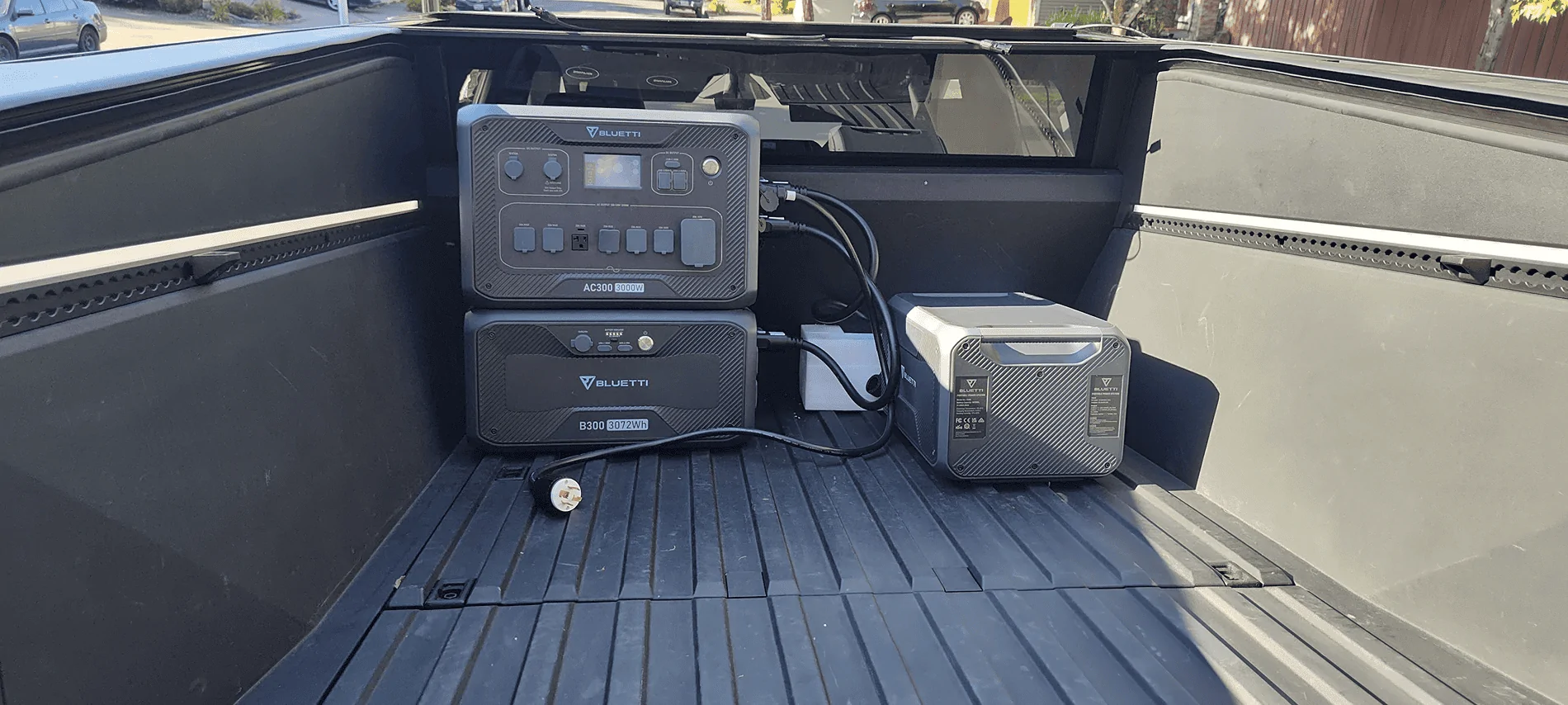

As I posted before, I opt'd out of power share and the $4k installation price to go with a more flexible option. These portable batteries gives me 9 extra KWh (6KWh shown) and can charge up to 3KW. This is primarily useful for remote destination charging such as camping/backpacking where I can add some miles when I park, charge the "range extender" with some solar panels over 3-4 days come back to a full range extender. If needed I can add another several KWh over a couple hours in an emergency.
With 800W Solar panels on roof top. The batteries fit in the bed with the panels for mobility.

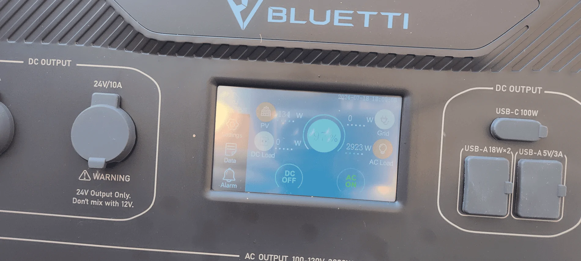

I also use the batteries to charge daily. My commute takes about 4% CT battery so I either charge up the bluetti batteries during the day with solar, or top them off at night when rates are cheapest. The software on the bluettis already supports Time of Use and solar PV priority.

I agree the weight is negligible. It is the aero penalty that concerns me.

That's cool you have experience trying this. I agree 6KWh doesn't do much. On 6KWh I could do 4%. Now I can add 6% per day on 9KWh, but no more. That's about 20 miles.
When you say 10 full sun hours, do you mean you were charging it with solar? If so, how much power were the panels rated for?
This solution won't ever be as good as the official battery extender, but I estimate it'll save 40 miles (either by adding or preventing loss) over 4 days. That's almost half of the range extender at a fraction of the price and I can remove it.

I am able to attach 400W of the 800W possible while driving, but so far I haven't thought of a use-case where I'd need to do that -except in cases where I can't put the panels in the bed. My current plan is to just carry the panels in the bed until I reach the destination.
