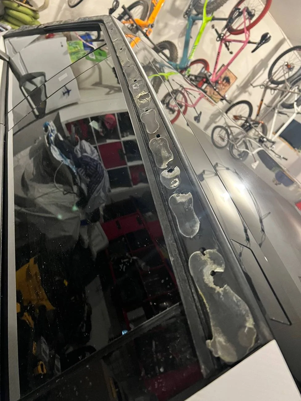

I ran a quick errand tonight, and while merging and accelerating on the Interstate in normal traffic, at about 70 mph, I hear a large ripping sound and the metal panel liberates and flies into traffic behind me. I was not able to stop as I was in the middle of a highway split. I rolled the window down and felt for it, and yes, the trim was gone. I looped around, next exit off/on, back to my original exit off/on, stopped with the hazards on, and located the piece, by that time run over multiple times with tire marks on the white wrap. I threw the piece into bed and drove home.

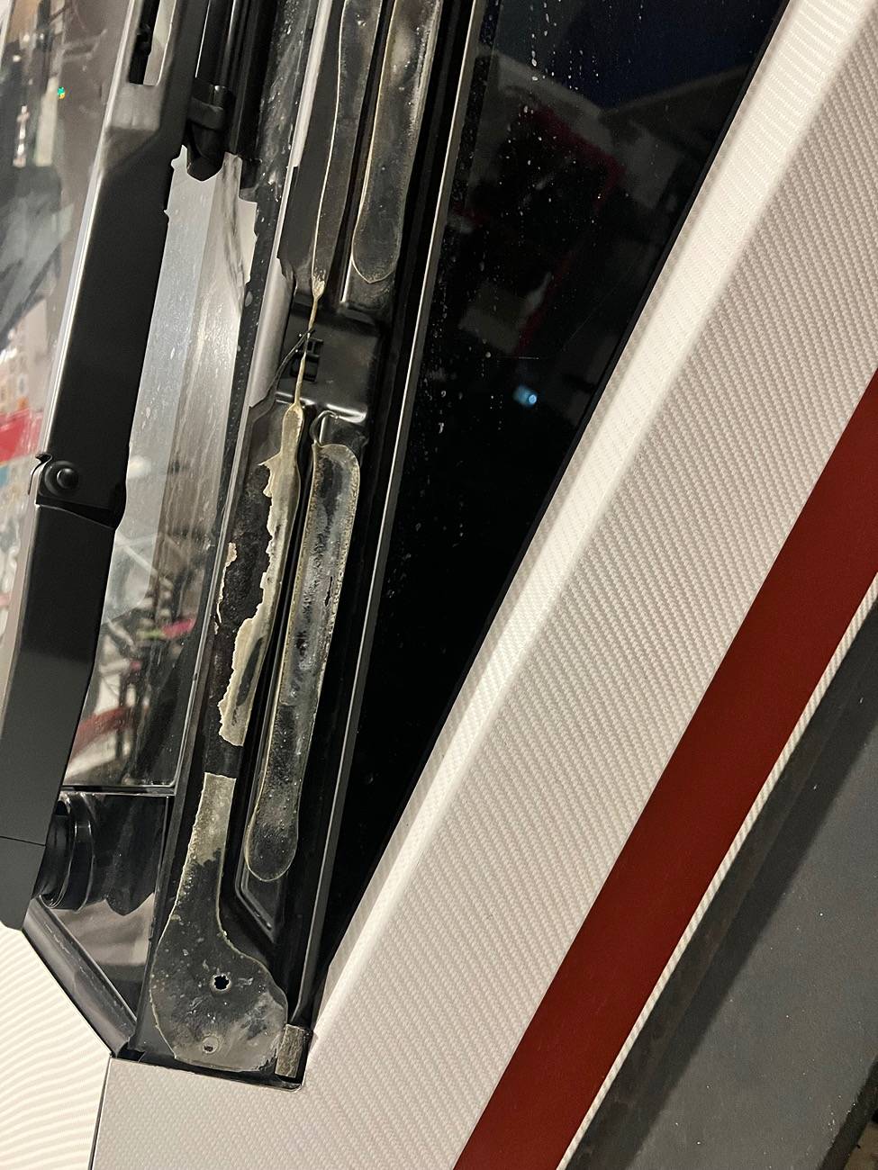

So the trim piece did not come off as one would expect (as the bed sail panel did on some trucks). The stainless portion separated from the plastic subframe that mounts the trim panel to the truck. The subframe is still there, all clips are in, and you can see the glue spots that once bonded the metal to the plastic, 17 to be exact.
I scaled the metal portion, 5 pounds. So imagine, a 9 foot long 2 inch wide 1/16th thick piece of stainless steel in the shape of a boomerang liberating at 70mph on the Interstate. This could have decapitated a motorcyclist behind me, or could have gone through someones windshield. Someone was lucky tonight, including myself.

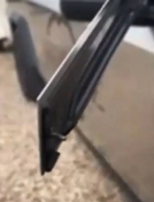

I believe Dirty Tesla had this happen, but his only bent backwards and did not dislodge.
The common issue is due to the trim piece being anchored at the front by a bolt, which is adjusted to make the trim flush with the body. It’s secured with Locktite, but an insufficient amount can cause it to loosen.
The problem with this, and the sail appliqué also, is that becoming slightly loose can get it to catch the wind, and then physics takes over.

The wrap was done last June, so too long ago to cause an issue now. The last one that was active in that area was Tesla Service when they did the wiper motor mod, and installed the new assembly that ended up with its base not being completely flush with the windshield. Maybe it put some undue pressure on the leading edge of the boomerang, that over time started to separate the glue?
The tech today also spoke about the road salt causing havoc on the wiper sprayer valve, maybe salt (we have more salt on the roads than we have ice and snow) was also a contributing factor to the ungluing?

Let me chime in here, this has NOTHING to do with the wrap as my wife had the same thing happen on the passenger side of the truck going 20 MPH on a side road. When I picked up the truck in June of last year, I made sure to tighten the bolts, but come to find out it is indeed two pieces, one is held by a bolt and the other by glue. When I mentioned to SC we should change out drivers side just in case, SC they stated they are unable to change it until it comes off.
SO in this case, if my drivers piece decides to fall off and hurt someone I will sue.
