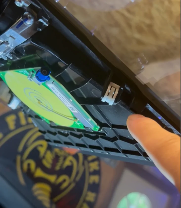

I"ve had some off-gassing issues too. It's mostly garaged and in WA so sun is not super extreme minus Summer. I just spent some time out in the sun due a near by wildfire that forced evacuation so I was in full sun for 4-5 days. The dry wipes and constant UI alerts about front facing camera got irritating.
The glare shield least on the foundation is fairly brittle plastic if anyone attempts to clean this themselves. Having a Hansshow mirror I didn't want to mess with a Service Center on this.
Putting the glare shield back in I took my time. Still managed to see both tabs fall on the floor board and as I removed it the back little hinge tabs they have were starting to break.
Tip: Do not use super glue - even more off-gassing and its not worth it.. I temp put mine up with some UV Tape until I can get a replacement part in, but this is like $48 shipped.
I feel like this needs a little redesign to make it more serviceable or switch plastics so its not so fragile.

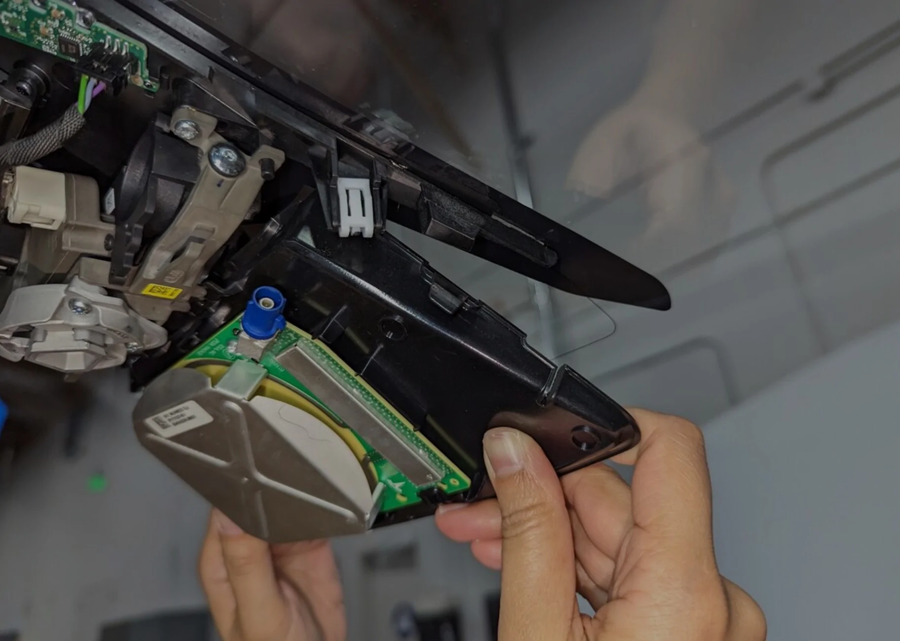

Back tabs
Tesla Roadster 2nd gen Damn BA Wiper wipes 1757351622204-ev

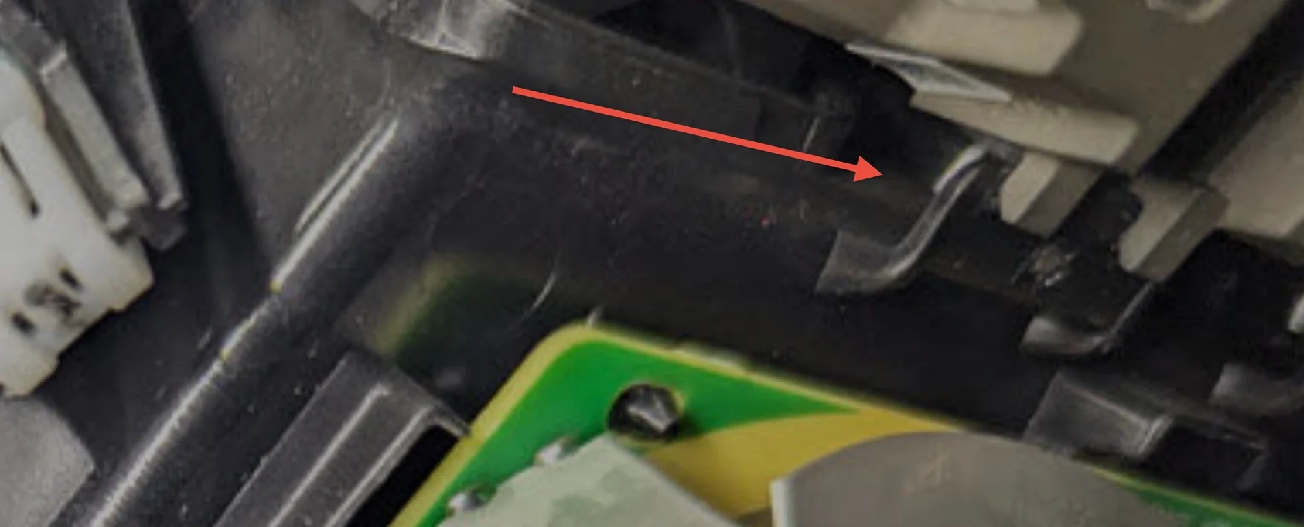

Per service manual -(Mine does not look like this)
Tesla Roadster 2nd gen Damn BA Wiper wipes 1757351658222-bj
Then mine
Tesla Roadster 2nd gen Damn BA Wiper wipes 1757351897789-iv
Least to me, the back little hinge deals should just be a plastic fin that goes into a lip or something. They are super prone to cracking. The 2 tabs in the front didn't even survive putting it back up and it's not like I was muscling it around.

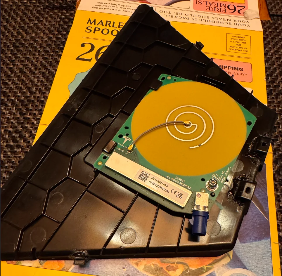

I got my new Glare Shield in and went super slow putting it in and had success.
Glass is clear, no dry wipe, or glare alerts so far.
