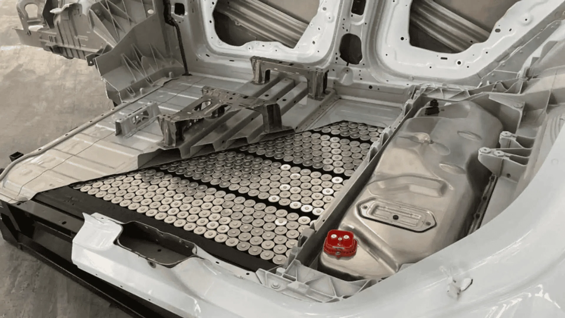

Hi everyone, I have been wanting to put these predictions together for a while and now we finally have some concrete data. We do still have to make some assumptions on the Cybertruck itself as well as what 4680 yields will be in a year so this will be a range. TLDR at bottom.
Lets start with what we know.
The standard range model Y has 34/35 cells in a row (literally counting them from the Munro video above), 6 cells in a group, 4 groups in a structural pack.
828 cells at around 95 Wh per cell = ~78kwh for the texas made model Y. From insideEVs: "4, 23S9P modules making a 92S9P pack".
3.8V per cell (per UCSD teardown). 92 in series = 350V, 9 of those in parallel for the 78kwh.
46mm diameter cell is approx == 64 inches long on a chain of 35 cells. Or around 5 1/3 feet.
STANDARD RANGE Model Y battery pack
4 groups
3 bandoliers per group
34/35 arrangement cells per band
23S9P * 4
23S9P == 34*3 + 35*3 = 102 + 105 = 207 == 20.7kwh per group
828 total cells
35 x 4680 cells in the longest string. 46mm diameter ~ 1.811 inches.
model Y wheelbase == 113"
cell string length = 63.5"
string length ratio to wheelbase == 56%

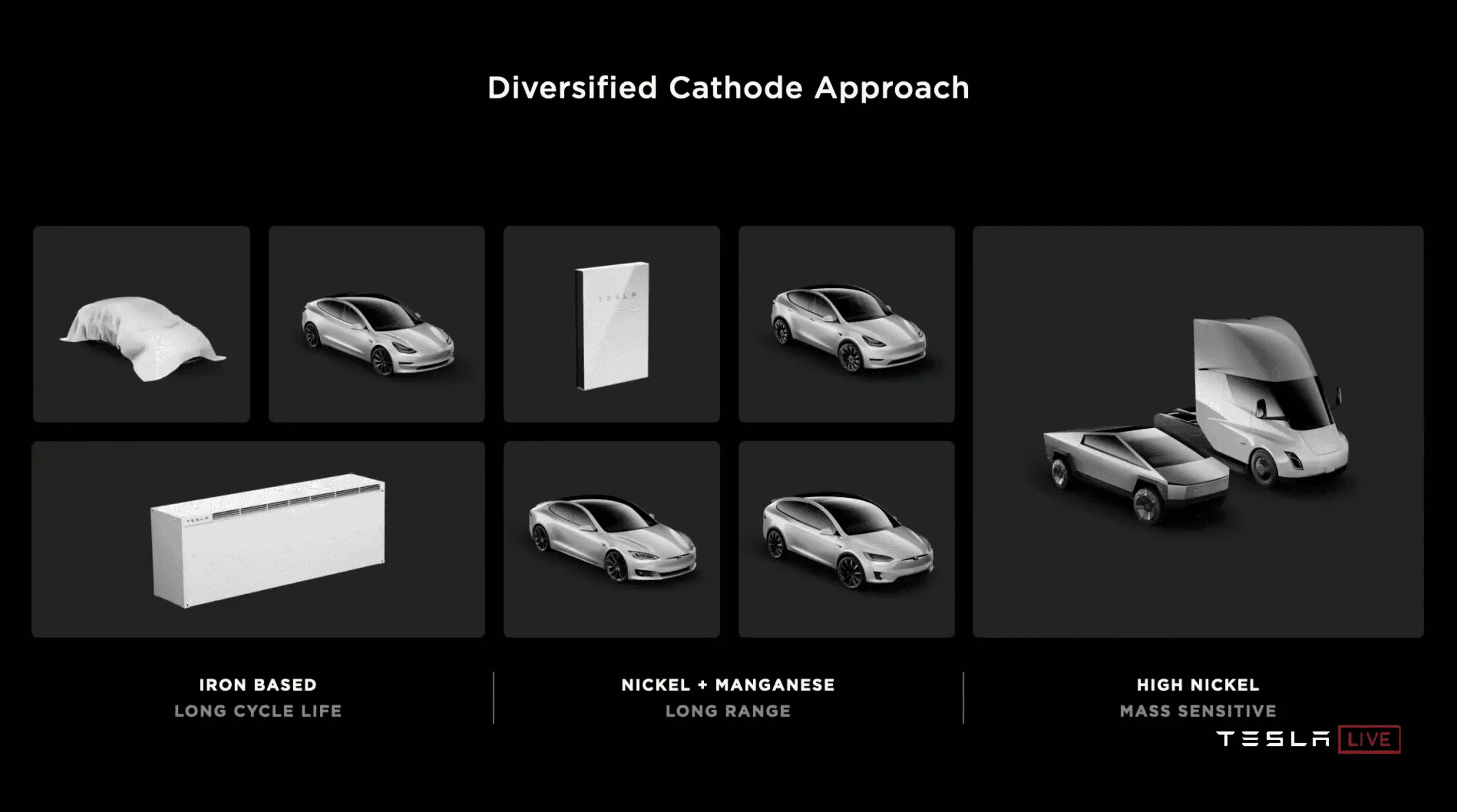

This is true, I want to leave room for not only yield improvements but also a higher nickel chemistry as outlined at battery day:

This is obsolete w/ the UCSD teardown from the limiting factor showing that first generation is 86Wh per cell. Agree that this yield will improve over time. Also the cell chemistry makes a big difference too!
Usable on the new 4680 cell is more like 81.5Wh. So 177.5kWh pack / 0.0815kWh per cell = 2177 cells. That is a prohibitive amount in my humble opinion!
