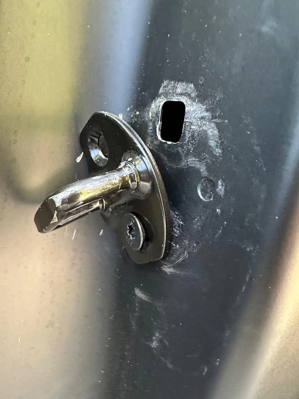

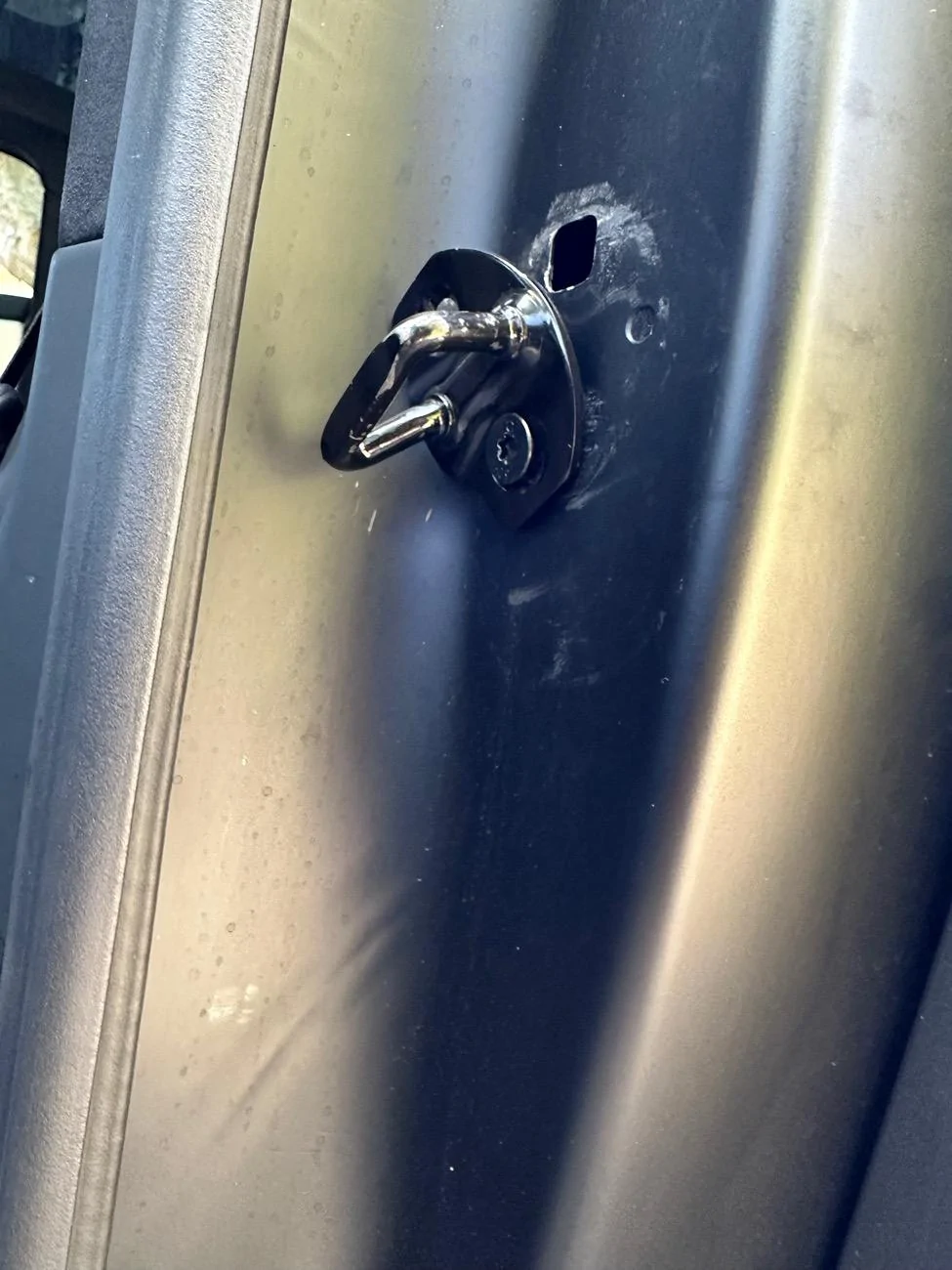

I have a feeling this is fake, for one why is the photo of a screenshot of a photo.
Secondly the person claims the door swung open but you can clearly see the latch has a bolt still attached so it couldn’t completely swing open.
Clearly the person is lying to some degree. I’m not saying the person didn’t have an issue as you can clearly see the latch missing a screw and the other screw is loose, but something isn’t lining up.

Oh boy - so many skeptics here. Let me try to clarify a few concerns:
1. First off, I attached screenshots because my photos were “live”, I’ve attached actual photos here. And shared small snippets of video (There’s a limit to file size).
2. I stated that a Tesla engineer told me not to complain. This was via social media and the person I was referencing was not actually a current Tesla employee.
3. My car was picked up last night and they have taken it to the SC to review the failed latches (both drivers side and rear passenger side) and to fix body damage and damage to our window resulting from the door not closing.
4. The latch is still hanging by a screw. What likely happened is that the door when closed was latched but because these screws became loose, the door replaced when taking a turn (and applying pressure on the door latch) which causes the latch to fail in full and to send the door flying wide open.
5. I have a loaner and will report back the findings. I have also filed a formal complaint with the NHTSA and will report back any response from them - including any recall notices.
6. I waited 4 years for this car, and I booked my reservation the moment I saw it. I am obsessed with the design of this car. And this is my third Tesla - I have a model 3, and bought my parents a model 3. I am also a shareholder of TSLA stock and believe in the company. I even purchased the tent - and was so excited to have this car be my dad van.
7. Howver, from the other nights incident - I’m just so shaken. This could have ended so tragically with my child in the rear seat (car seat) right where the door failed. And the fact that the latch on my drivers side door is also loose tells me this is an issue with the entire way the latches are designed. Putting this in context to the accelerator pedal that can dislodge, the wiper blade motor that fails, and the rear panel that flies off tells me that this car- despite being so delayed, was rushed to market. As much as I want this car, and as much as I want this car to succeed, it’s just not responsibly designed or built - and it’s just a matter of time before it costs someone their life. This is why I am sharing my story.

Regardless of the circumstances here, I'm a little amazed at how light the door latch hardware is, and especially that it uses some kind of nuts behind unreinforced sheet metal instead of a welded boss that reinforces the back side of that panel and would allow replacement of that part without access to the inside.
Someone forgot the thread lock....
And this is the way all 4 latches are designed. We used only two doors and while the rear passenger door latch failed, my drivers side door is also loose and failing (though it still latches but it causes the door to be gapped and shakes when driving. When driving you can hear the noise of air - as if the window were cracked.). It’s insane!

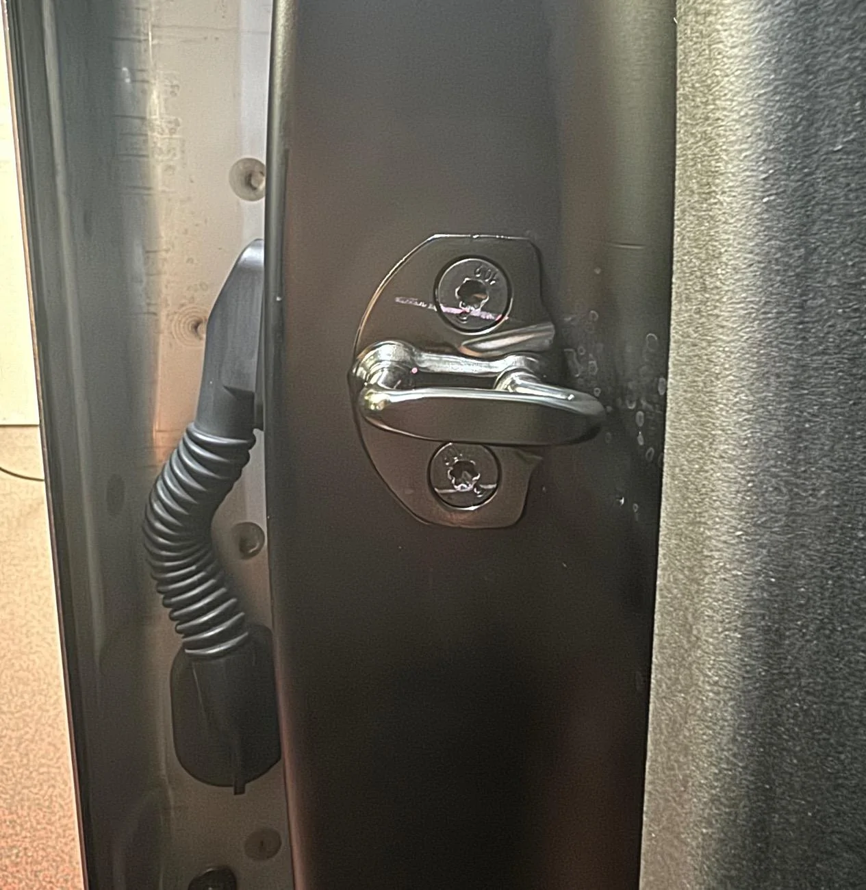

Checked all my doors to be sure. I noticed in the OP pictures there are no torque marks on the bolts. That seems odd.
The latch design is fine, your bolts were evidently improperly torqued. My latches are rock solid.
If you believe you've found a defect, open a service ticket instead of relying on internet randos (including me, hahahaha)
Agreed. It sorta happened to mkbhd on his first review (the bolt was loose so the door didn't shut all the way). A lot of the bolts were loose, or became loose over time until they updated the process.
