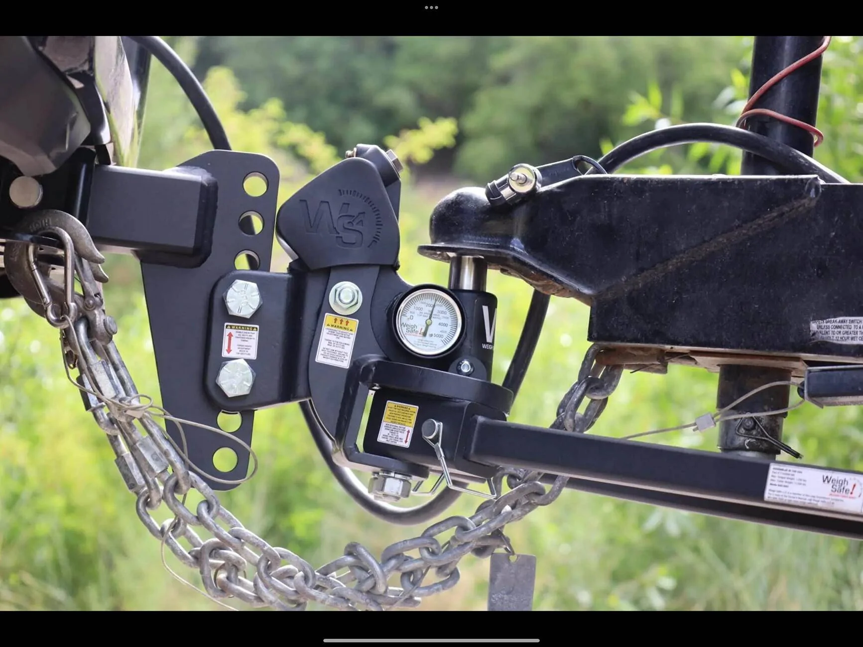

How is that ? There are no attachment points to the vehicle utilized other than the receiver, so entire weight is transferred through the receiver whether WD or no WD.Are we talking anti sway hitches or weight distributing ones?

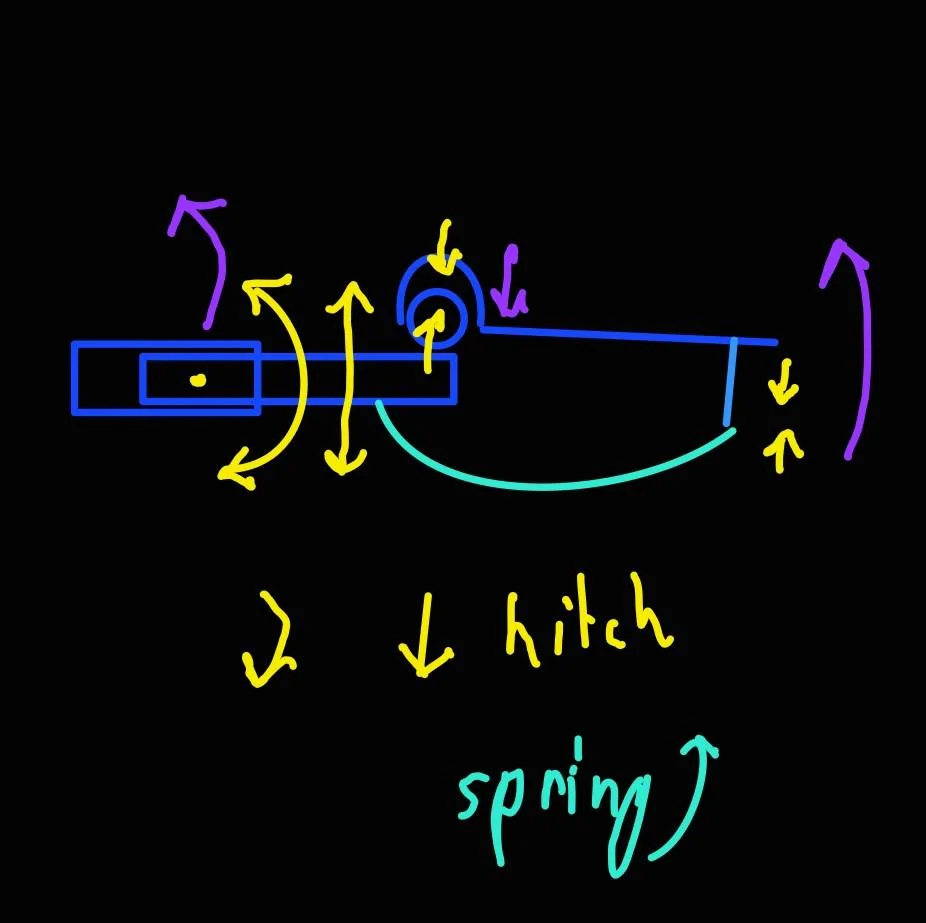

Weight distribution hitches produce torque opposite of the tongue weight while also decreasing what the receiver would perceive as weight.
Image the trailer was reduced to a point load on the ball and you lifted on the spring arms. That reduces the torque at the pin/receiver and total weight the point source is applying.
