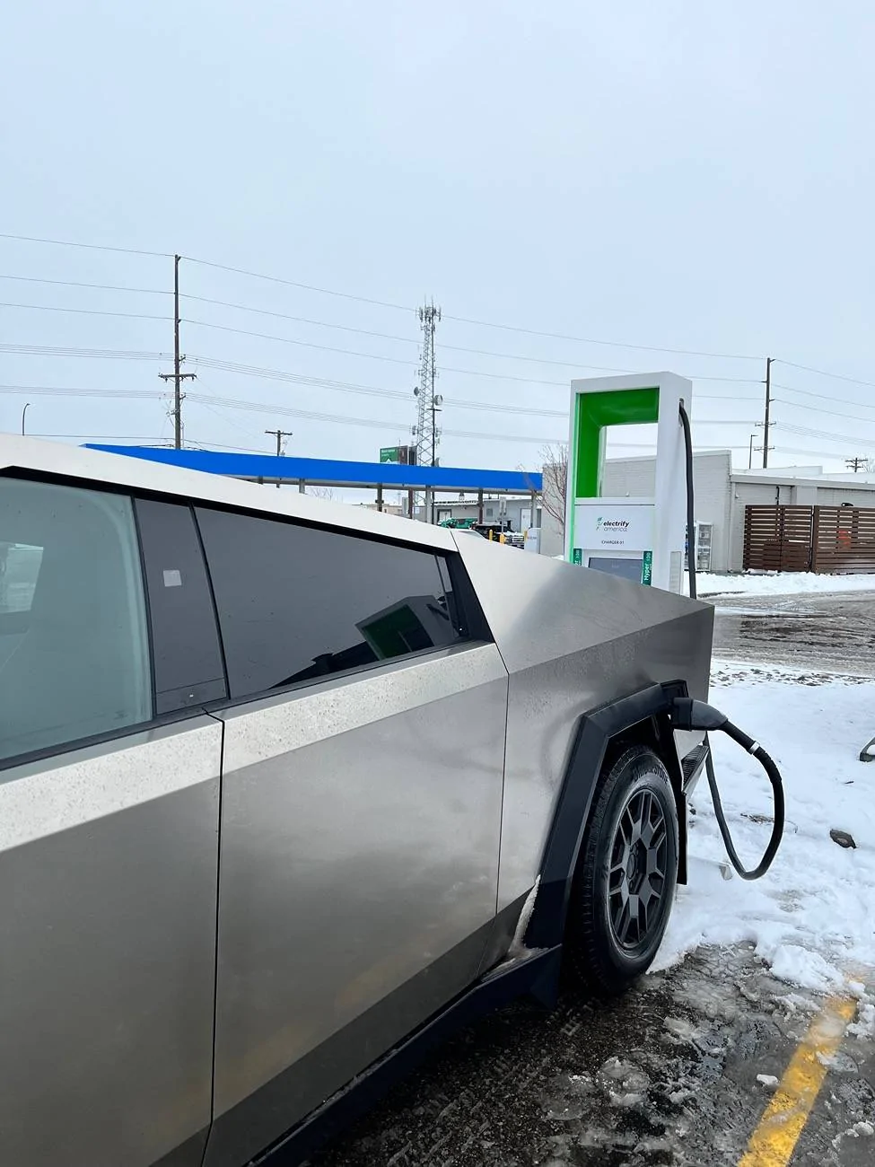

I got my A2Z adapter and did a brief test while out running errands. It worked for the few kWh I ran the test for. I’ll try and do a better test at the end of the month when I spend a few days in Island Park. A CCS adapter isn’t required for my trip, but it will provide more comfort in case I want to change plans. It will also be nice for my summer camping trips to Craters of the Moon.
