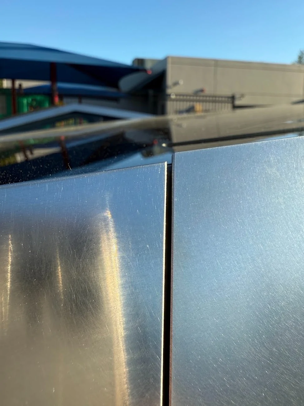

Just had my recall service done for the cantrail, and the fit is just horrible. None of them sit well, and the service center denies fixing that. They basically told me i should be happy with what I've got, and that's better than avg.
Did anybody figure out how to fix that? Any service center that could perform the alignment? Aftermarket?
This feels horrible, and I'm very disappointed with Tesla and my local service center for the way that's handled.

Maybe it's the pics, and to each their own, but it doesn't look that bad to me??

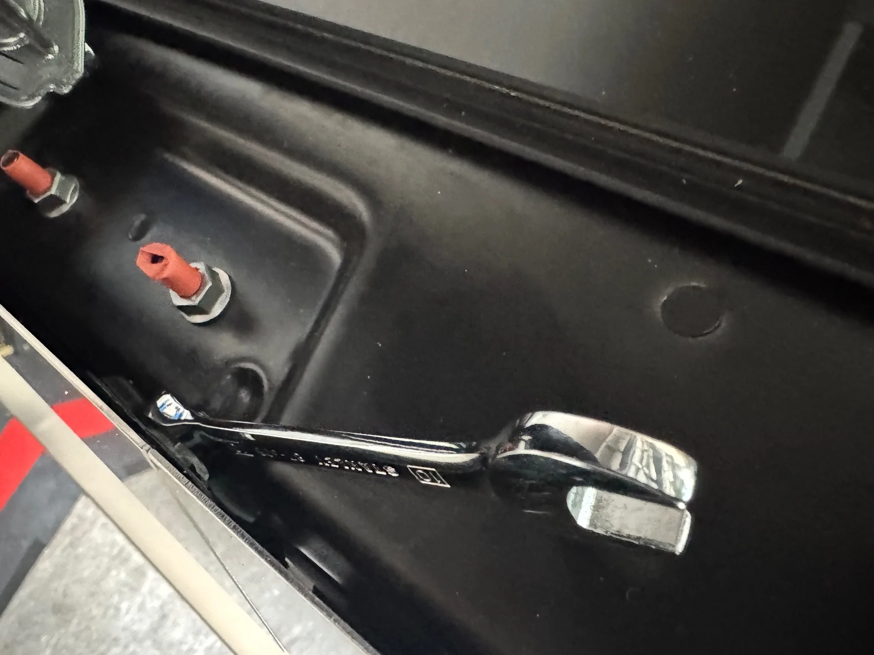

If you pull up the appliqué along the top edge of the contrail there is a bolt (believe 8mm). You can loosen the bolt and adjust the end of the rail up or down. See pic where bolt is located. BTW I adjusted mine that way.

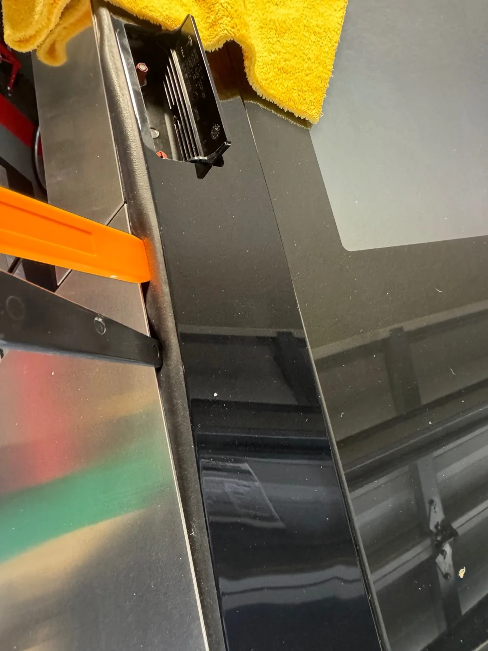

also, FWIW, that triangular area where all 3 panels meet up is an engineering fitment and fishing nightmare to get perfectly right.
Can you elaborate? What applique? Any pics?

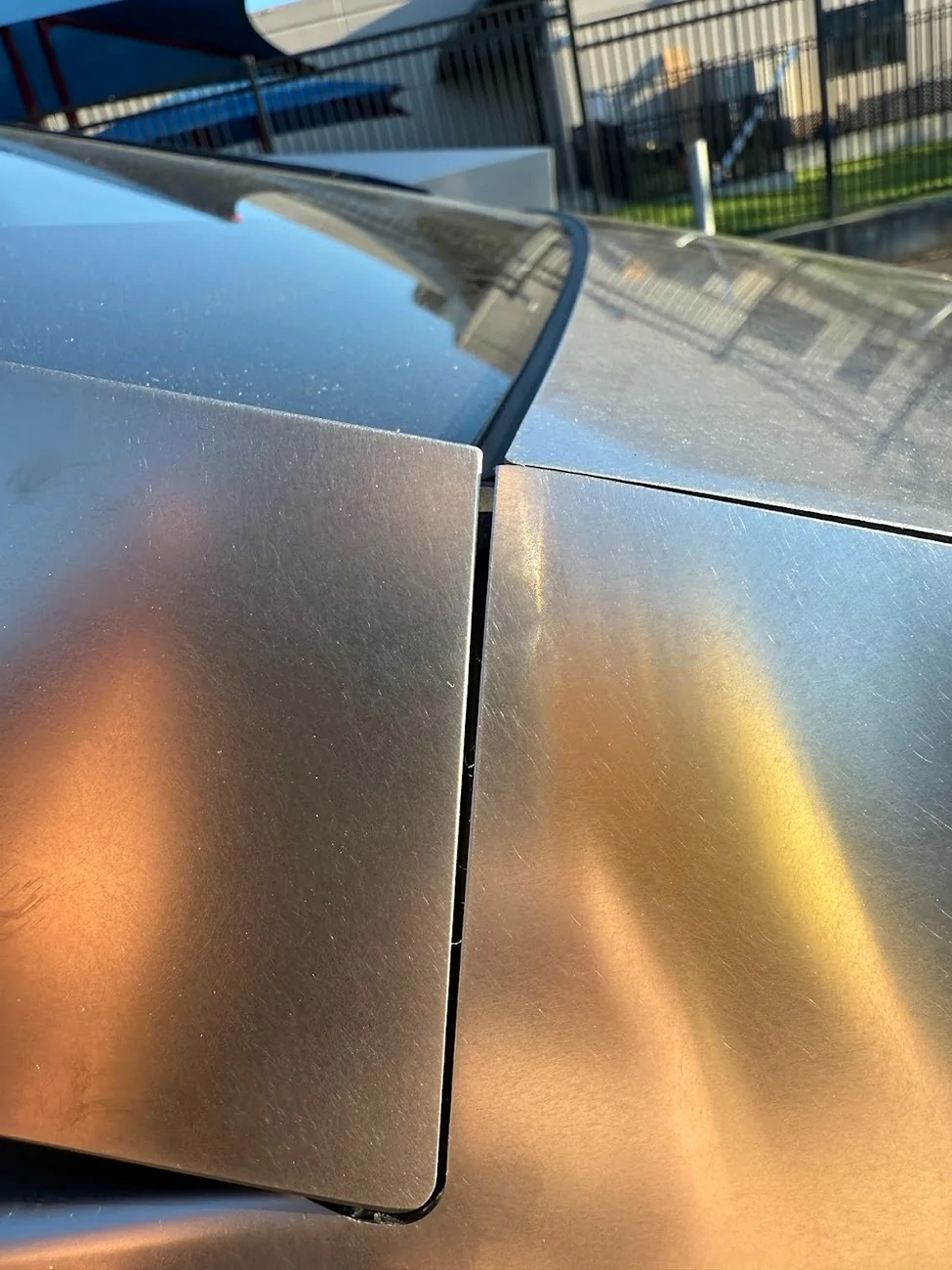

Fully sealed and flushed on my foundation CT going in before the cantrail recall
huge gap is what I got back, and after complaining they re-measured the gap and said “it’s within spec”
fuck tesla service, no honor in their workmanship
