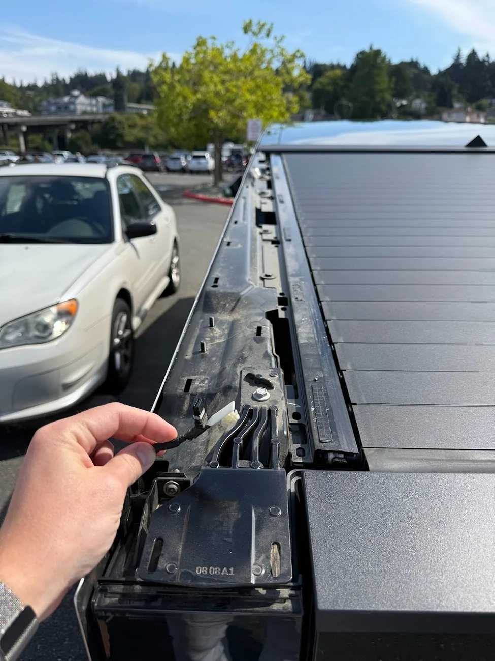

I dont have the link but you can find instructions on YouTube “adjusting Cybertruck panel gaps..cantrail alignment”
This is super helpful! I did not know loosening those nuts allows us to adjust the alignment of the cantrails...I may have to do this for the rear of my cantrails (they are just a tad higher than the rear quarter panel).
When loosening the nut, you just push / pull the cantrail to get it in position and then tighten the nut?
The forward and rear bolt affixed to the cantrail ends allows slight up down movement. It penetrates a slotted brace for this purpose. Use gloves when pushing down or up. If the rails are badly aligned it might require sc removal and alignment.

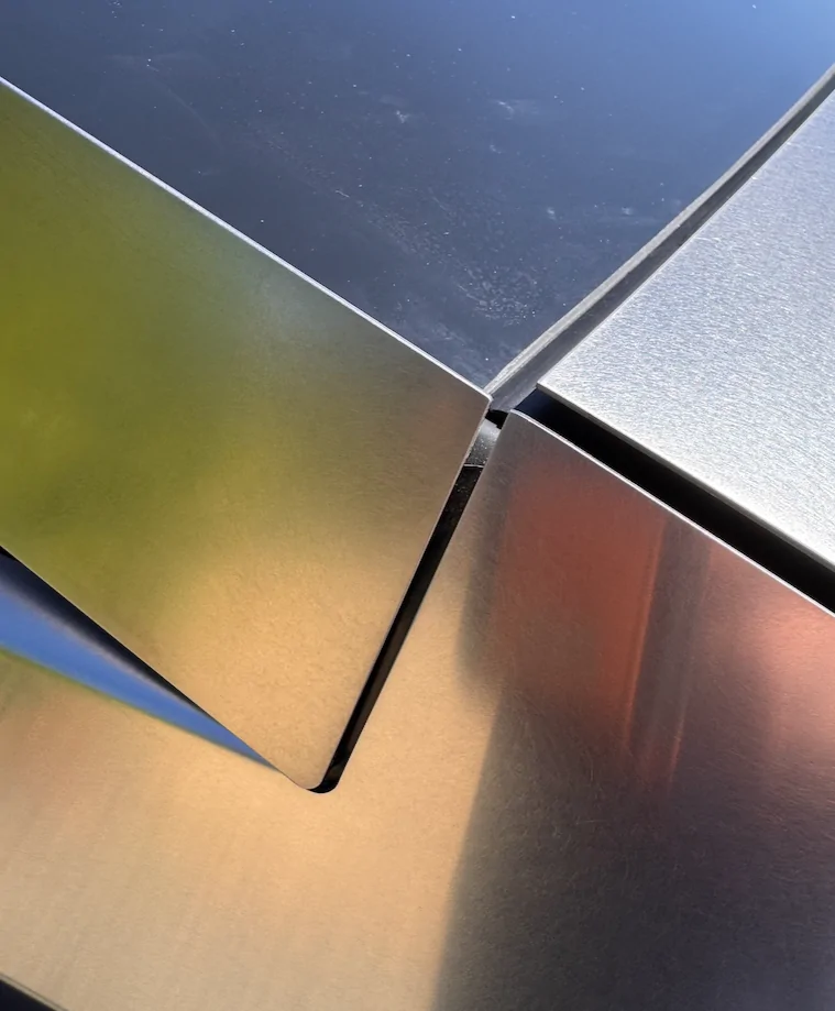

Fully sealed and flushed on my foundation CT going in before the cantrail recall

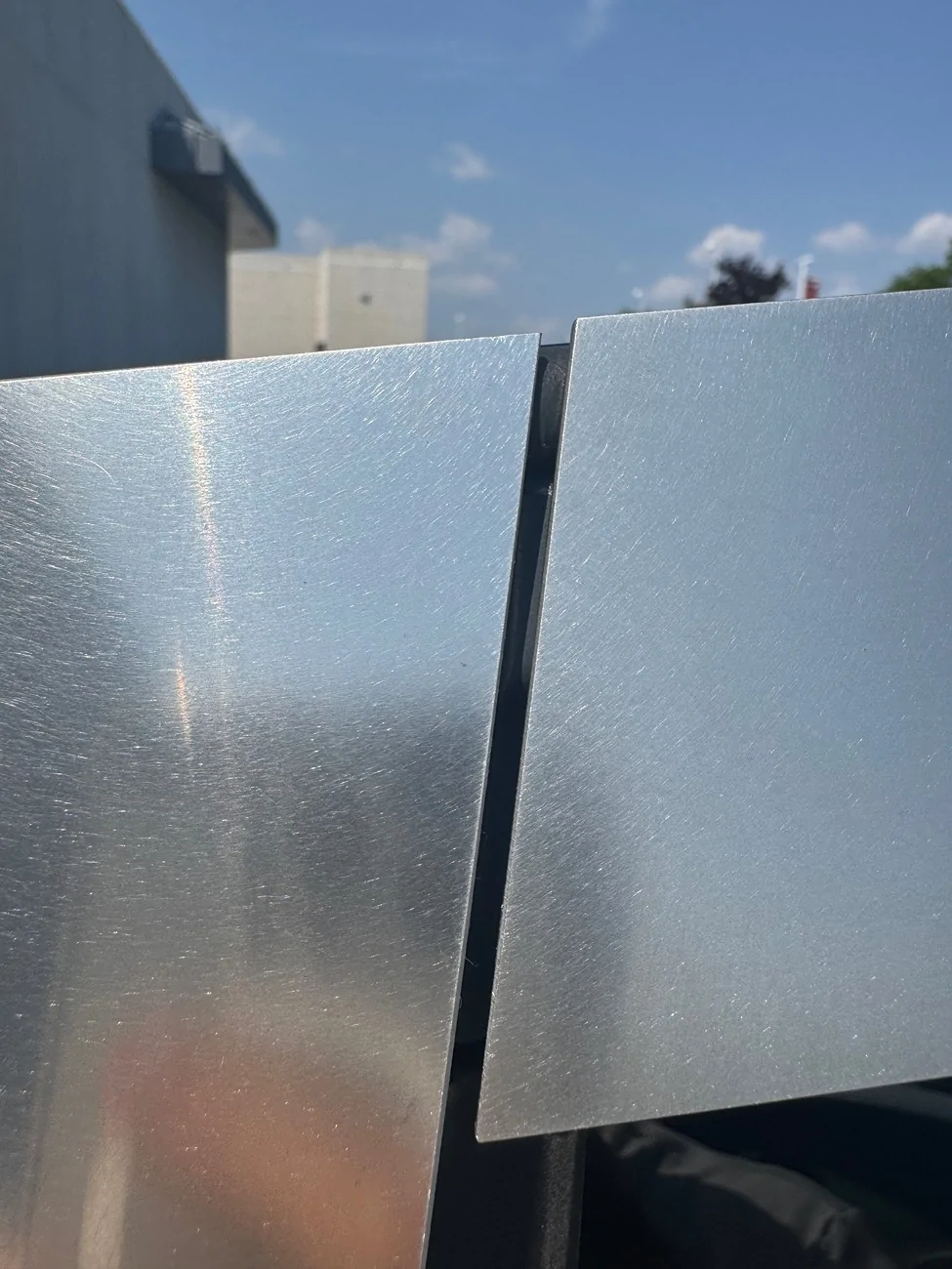

huge gap is what I got back, and after complaining they re-measured the gap and said “it’s within spec”
fuck tesla service, no honor in their workmanship
Thats how my passenger side looked when I got the rig. I told them when swapping to the new contrail if we could do something about that, instead I have a gap in the front now and these dimples where the stud is welded I guess. I'm not super happy about it but letting the mobile tech check I just feel like this is going to turn into a multi-month journey unless I can get one with a extra 2mm on it.
