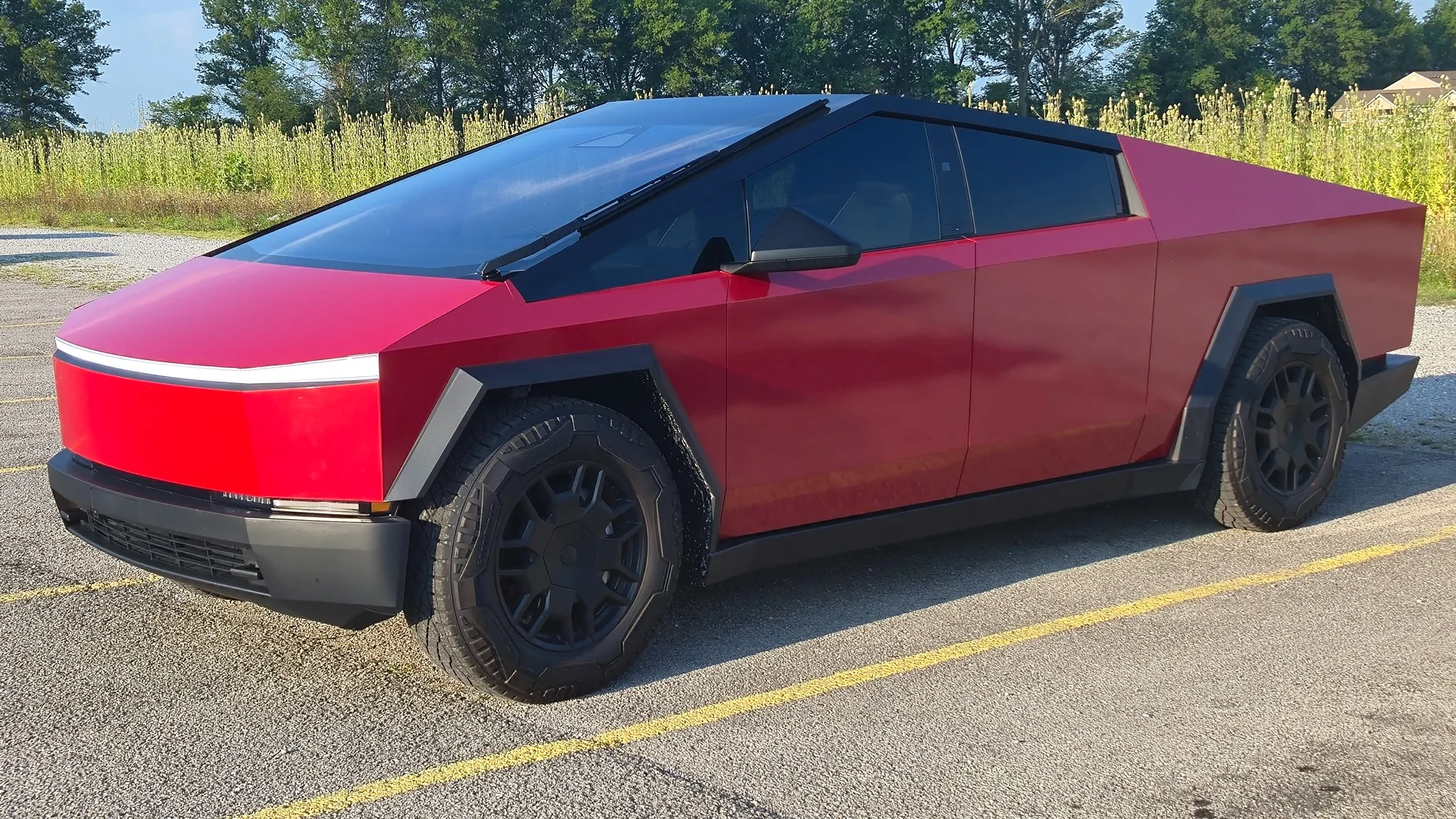

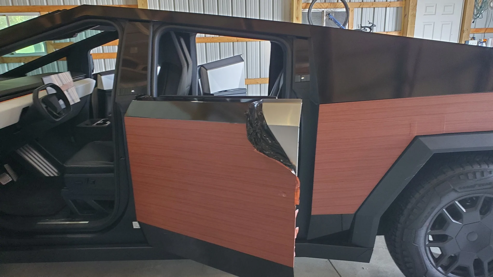

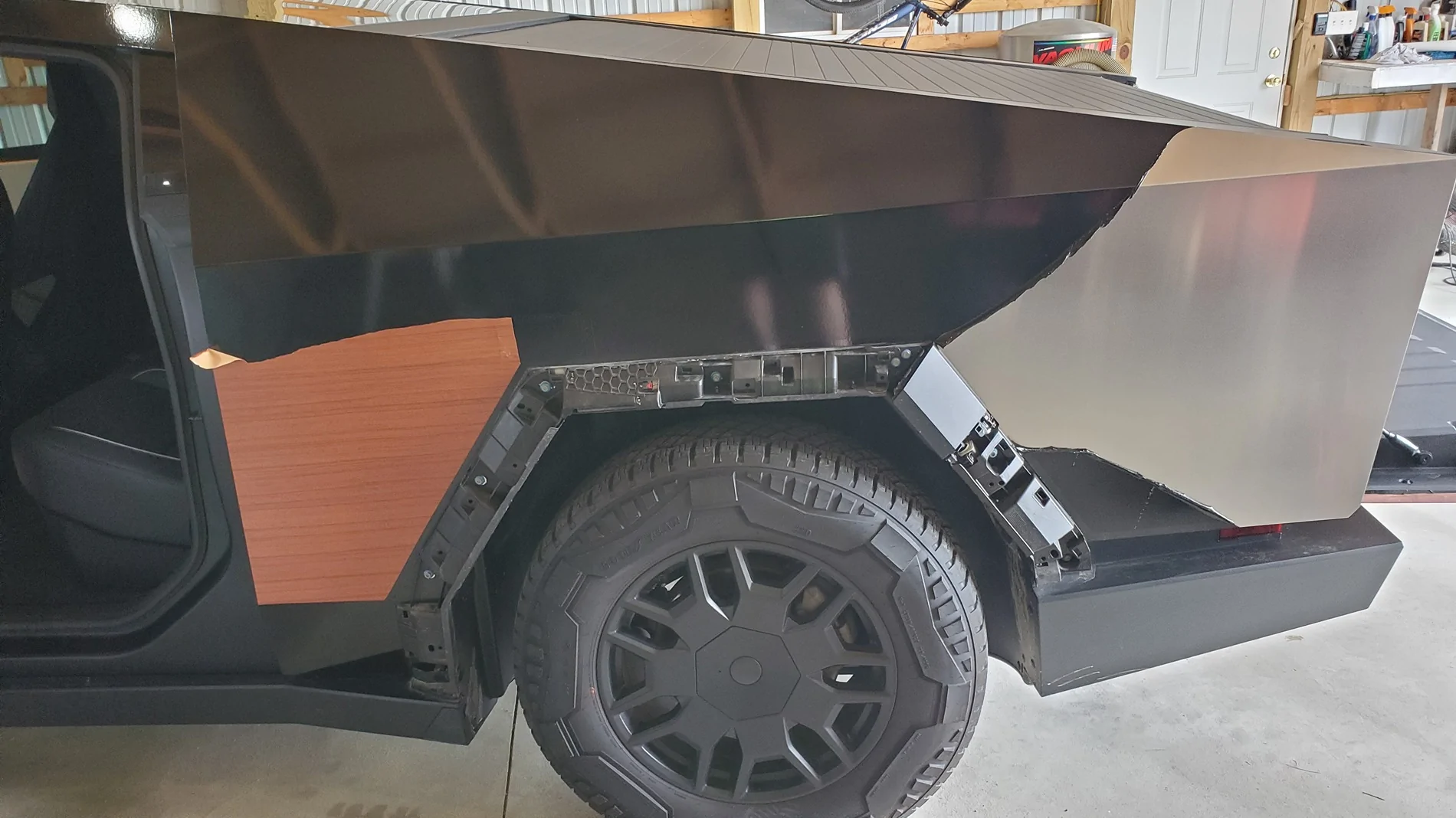

So it went pretty easily! Took me probably 3-4 hours to remove it all. It's mostly just muscling it off. I'd pull it out in the sun to warm it up a bit and then bring it back in the shade to work. I'm not sure it made much of a difference. I did try a heat gun on a stubborn spot to see if it miraculously became super easy, but no. You just have to pull and tug, and that's all there is to it.
Left no residue. I just wiped the panels down with alcohol before putting the new wrap on, but if I was leaving it naked I don't think even that would have been necessary. The woodgrain was another story, I would never put that directly on the stainless. It's clearly not meant to be removeable and left a lot of glue, but since it was over the other vinyl it didn't matter.
And now it's red! Just like getting a new truck. This is the 3M 2080 G203 Gloss Red Metallic. It really has a lot of metallic in it and looks very different depending on lighting. I LOVE IT
