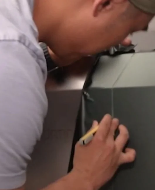

The way it was cut from the edges seems like it would only be < 1/8" from the edges. Is that normal and would it peel off?

It gets folder over on the side then heated to set. You can see them folding it over in the video when they open the door.
Doing it like this also hides the silver color when you view from an angle.
With the CT and it's nearly 90 degree angles on the edge, chances are it will lift in less than a year though. The alternative it cutting further out so you can wrap around the back edge. but you end up using more material for each panel and obviously taking more time.

Thanks. Gotcha. I 100% get that they were trying to hid the SS edge ... for some reason I though the fold over would be at least 1/4". I've never looked at wraps close but I thought that is the way it was on my PPF.
