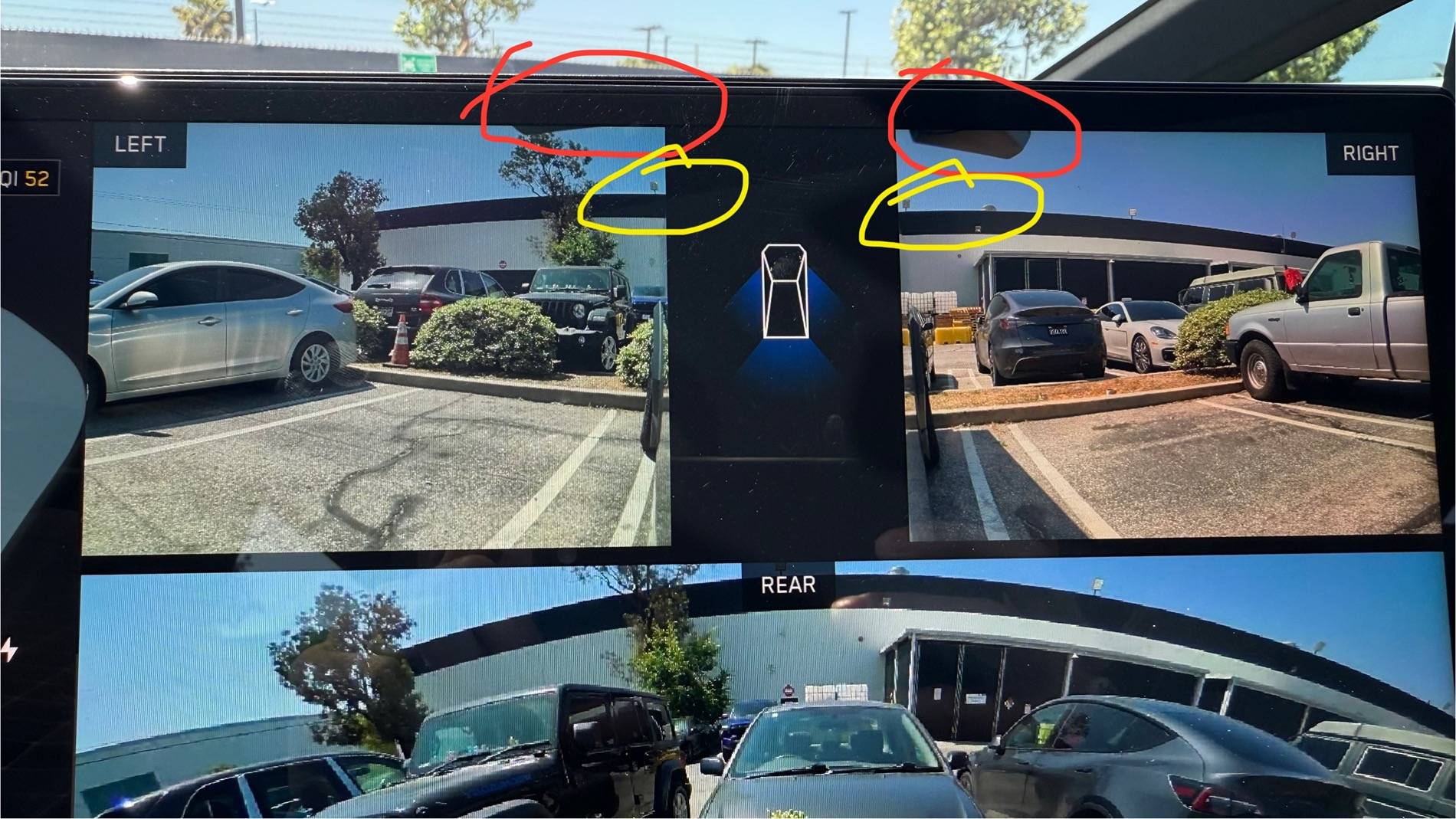

Anyone else Side repeater camera not aligned?
yellowdc2
Andrew
Mar 24, 2025
Will a camera calibration fix this?
left camera you can’t really see the side mirror compared to the right side camera. Is this an issue for lane hugging?

Mine use to be like that until they fixed it. Luckily the camera went out so when they fixed that it’s perfectly aligned now.

I’ve been wondering if that’s part of the line-hugging issue too. Seems like a physical re-adjust is in order, but I’ve never had my wheel arches off to see if there are adjustment screws under there. Mine rides perfectly in the center of the lane but given the number of people who have issues with line hugging, there has to be some sort of systemic issue. I need to look and see if the re-install instructions for the side repeater cameras has an alignment section…
Update: Doesn’t appear to be a physical adjustment, but it doesn’t say to erase the calibration at the end of the camera replace instructions. Oddly it says to clear the forward-facing camera input… Maybe there isn’t a separate calibration for the repeaters, B-pillar, and rear cameras?

Are your side cameras alignment spot on?

Are you hugging one side of the lane still or it pretty center when using FSD, after the fix.
