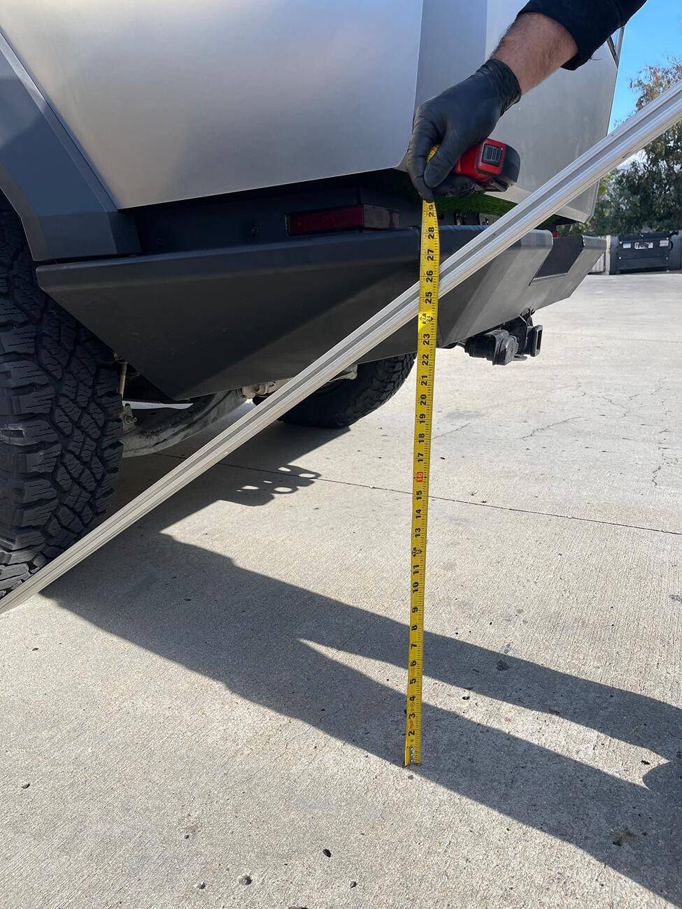

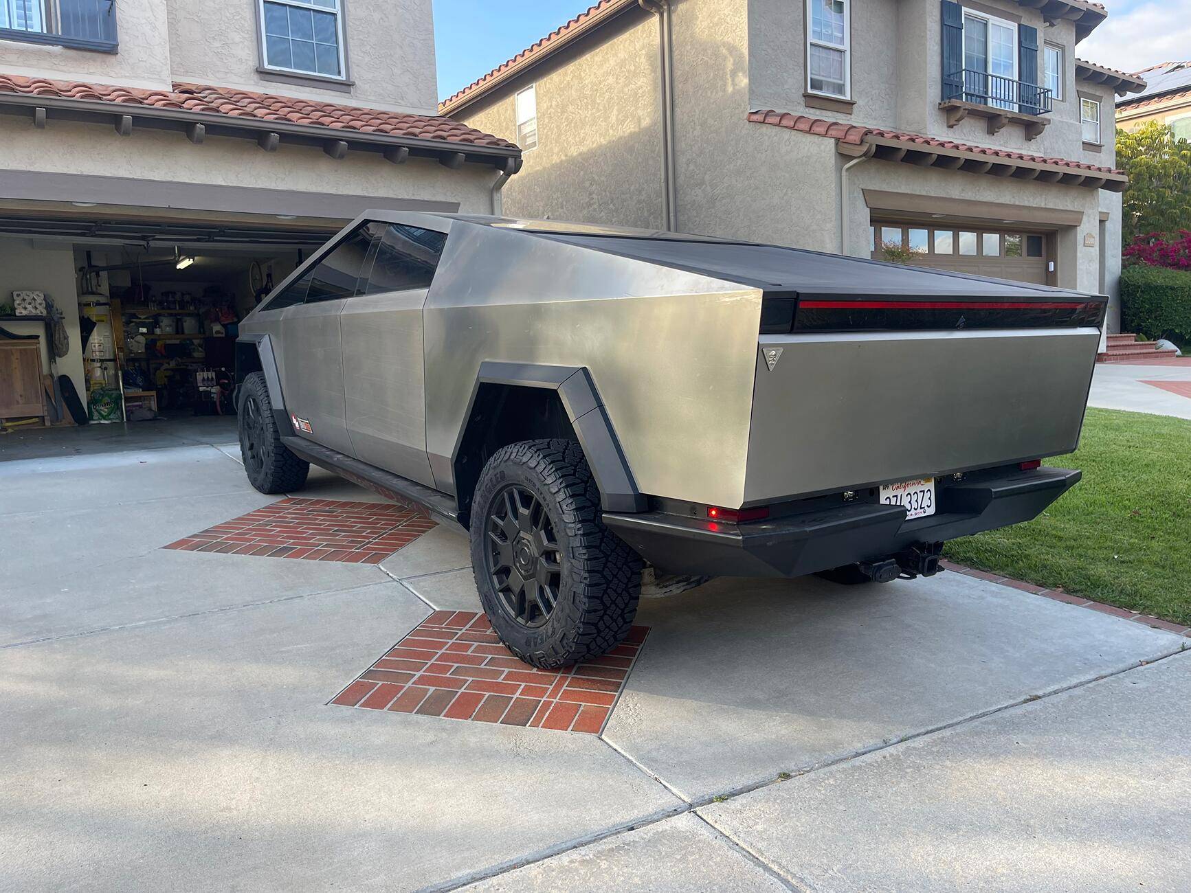

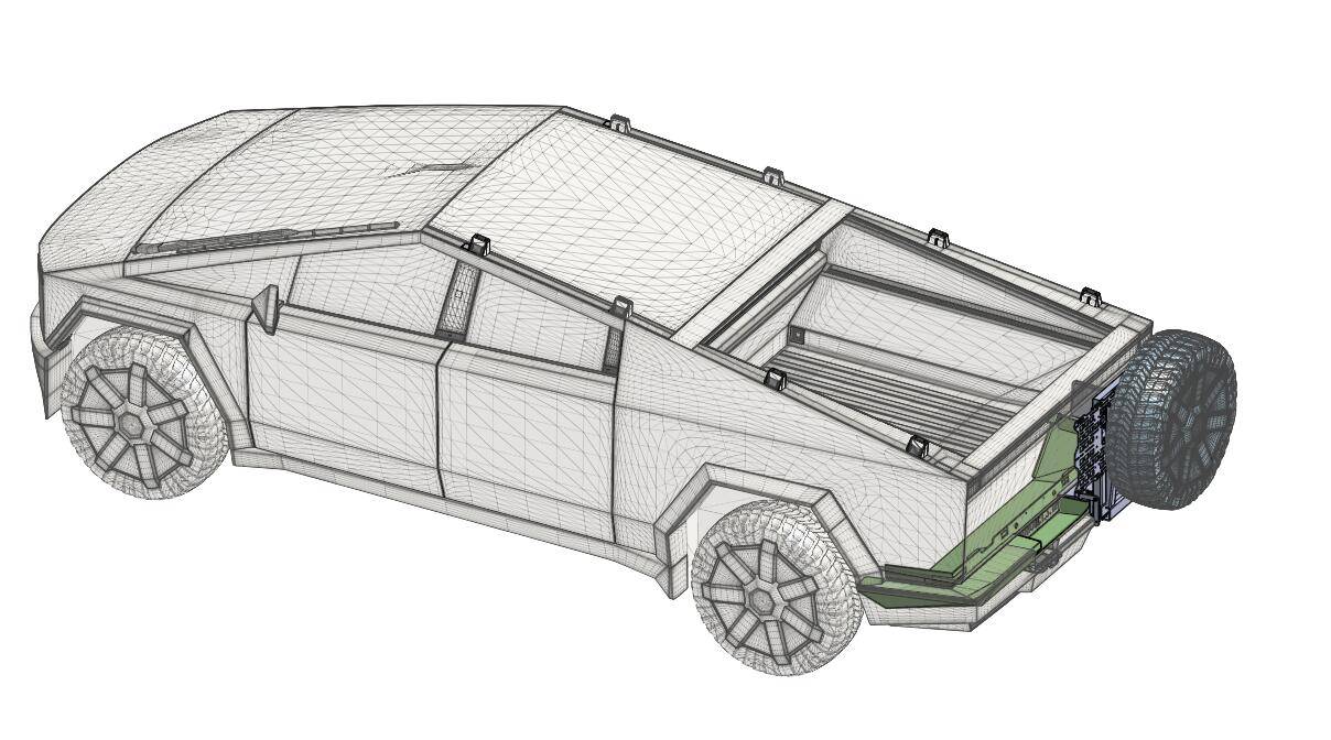

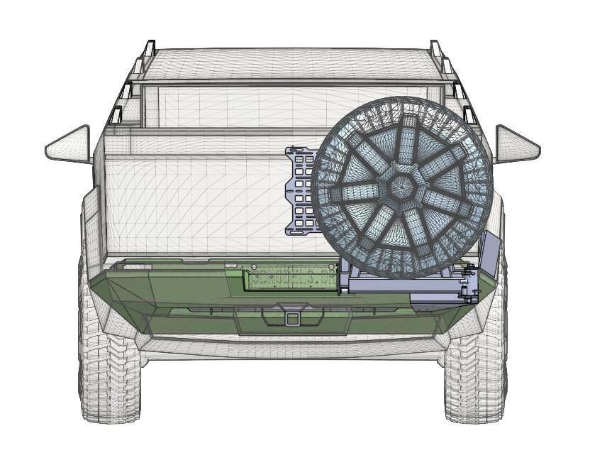

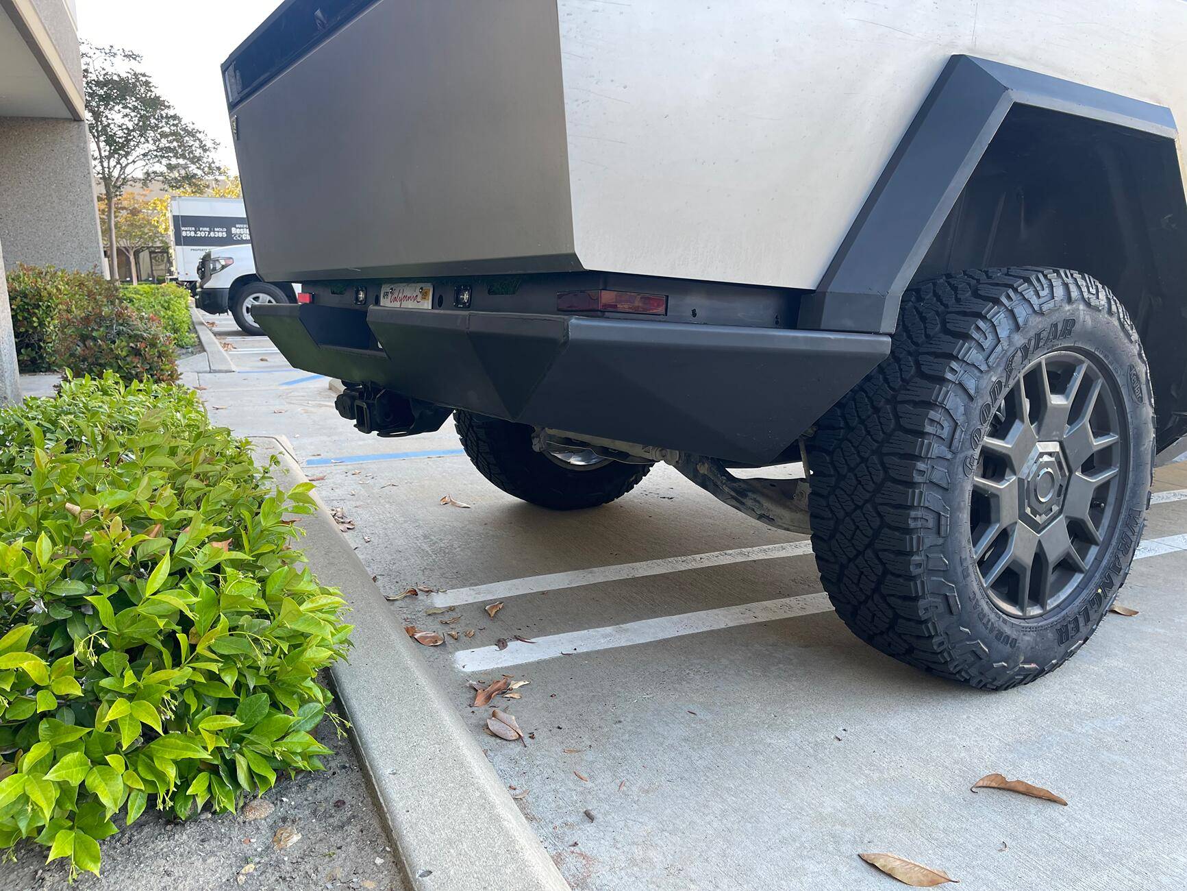

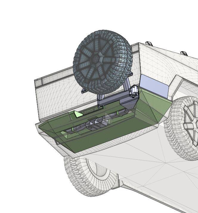

Yes, we have a new heavy-duty offroad rear bumper going to launch this week for delivery end of May!
  • Best on market rear departure angle!
    • 27" on the corner vs 213" on the OEM (similar to competitors bumpers we have seen)
    • 21" at the lowest point vs 16" rear bumper diaper.
  • 1/4" thick aluminum rear bumper weights in a 65lbs
  • mounts to factory frame locations with no modifications
  • You can remove the factory tow hitch if you won't be towing and want better clearance, or It uses the factory tow hitch, to avoid voiding warrantee and it is certified by Tesla for towing.
  • Optional stainless steel rear tire swing away on the passenger side and swing away molle shell on the driver side. Both have rear quarter panel "stegosaurus" vertical protection plates.
  • Have I mentioned we've been build offroad bumper, sliders, and other parts since 2005
  • The swing away rear tire carrier has 3x locking positions (Closed, 90° to clear rear bed or open to use the folding table option) so it's not wild when released. Also 2x locks when closed to make sure it never comes open without your direct input.
We haven't put on the site yet because we don't want to tell you next month and then take 12+ months to deliver.
Let me know your thoughts!
