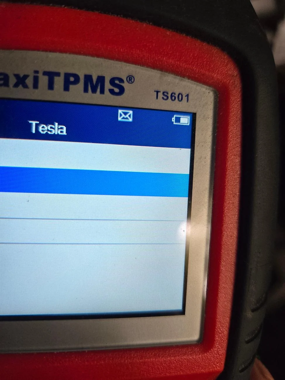

They to be programed to match antennas. I bought the programmer. Then I program them before installl
If u want programmer info?? Get back to me
Yes please share the programmer info ?
Info only: Tesla OEM TPMS don’t need programing. The car/truck will automatically recognize them and knows which TPMS is at what tire location (right/rear, left/front, etc).
