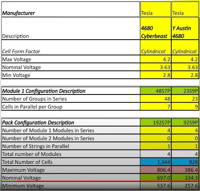

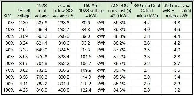

192S 7P = 1344 cells
192 * 4.25 volt = 816 volt
Quick playing around in a G-sheet
Tesla Roadster 2nd gen 4680 Structural Battery Pack explained - How does it work? 5raQwb0
Via YT video below:
Tesla Roadster 2nd gen 4680 Structural Battery Pack explained - How does it work? L0rYSJD

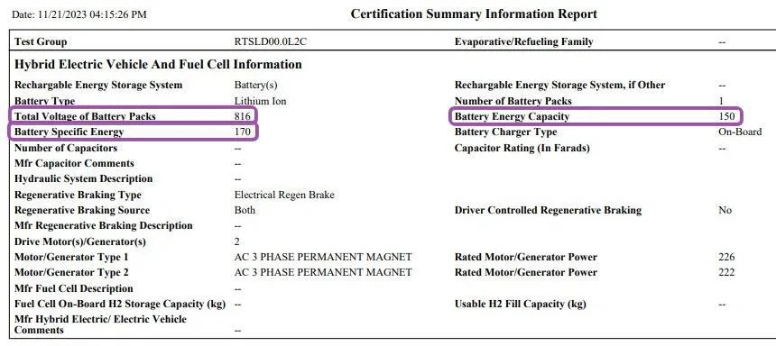

EPA website below confirms the Voltage architecture is 800 Volt. Also, we get more info that the Battery Energy capacity is 150 Ah and Specific Energy is 170 Wh/kg.
Tesla Roadster 2nd gen 4680 Structural Battery Pack explained - How does it work? kUZ0EY8
