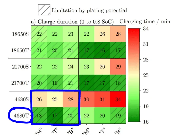

I'm the author of some of the graphs John used in his video
I recommend reading these two papers, the amount of ohmic losses heat generated inside the cells due to the tabless electrode is greatly reduced to almost nothing
Also as shown there, the most likely explanation with all the data we have is that Tesla is being extremely conservative with the 4680 charging curve and I tried to do some speculation/calculations oh how much it could improve
https://iopscience.iop.org/article/10.1149/1945-7111/abd44f
https://iopscience.iop.org/article/10.1149/2754-2734/ac97e0

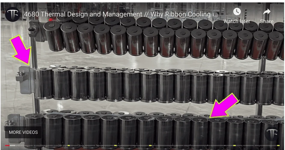

PS any idea why the 4680 to date are still using side of cell cooling instead of top across the tabs, which would seem better given the shorter thermal path? Is it only because of the surface area to extract heat, and/or because it's easier to manufacture? Or is it because it just doesn't need any more cooling capacity than that anyway because there is less ohmic heating?
Thanks man
Yeah, because it's more effective, the second paper goes into detail on the why, and also recommend this video that is a summary of the paper
But the TLDR is, while cooling the bottom seems more effective because the thermal path is shorter, the performance is worse due to the smaller surface area
You have to think about not only about thermal transfer, but also electrical insulation. I have no data to back this up, but I imagine if you could have a finned stack attached to the bottom of the cell, or being the bottom of the cell with coolant flowing through it, bottom cooling would be the most effective one
But when you consider that whatever you are using to cool the cell has to be electrically insulate, and that usually goes against thermal conductivity, it's better to go to the longer thermal path but allowing more surface area to make up for the worse conductivity between the cell and the cooling ribbons
From worse to best according to the paper it goes:
Bottom cooling (B) < side cooling (M) < top and bottom cooling (T)
Top and bottom is way too complex for a high volume manufacturing, take a look at the image bellow, I highlighted the most interesting part, these are shortest charge times for the 4680 with the tabless electrode on the last row, from page 8 of the second paper, keep in mind as the author says, these are theoretical times that likely won't be achieve on real life
Cooling from the side 18 minutes, from the top and bottom 17 minutes and from the bottom 20 minutes, it's clear that there is a diminishing return point
