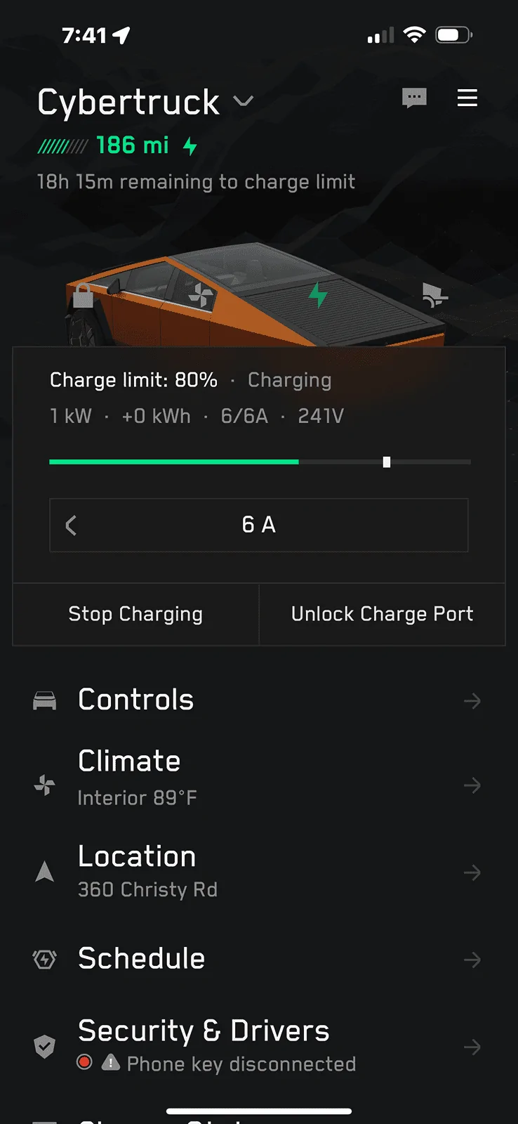

Cyber Truck only charging at 6A with a 50 amp breaker and 220 Connector. Do I need a service call.

What kind of charger are you using?
What do you have the current set to in the vehicle or app?

Set to 48A in vehicle. Using charger that came with the truck.
Just dropped to 5A on app.
If the car detects too much heat at your charge port or in the wall outlet.
Are you using a NEMA 14-50 wall outlet? What brand is it? What is the gauge of wires feeding it?
I would start a new charging session and see what the initial charge rate is.

Bad 14-50 adaptor. I swapped it from the SC, works now
