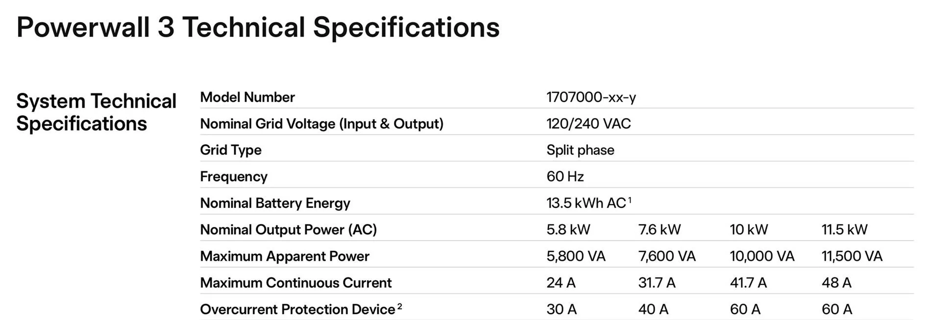

Each PW3 adds 11.5kW of power. Four of them gives 46kW.
Each Powerwall 3 has 13.5 kWh of energy, four of them will give you 54 kWh of energy. Each Powerwall 3 can deliver up to 11.5 kW if configured that way. Our Powerwall 2 units can only deliver 5 kW for example, which is why we started with 3 and ended up with 4, so we can run everything we wanted, including both AC units. :/
Tesla Roadster 2nd gen 2025 AWD and Powershare - First impressions IMG_0150
3,489
3,010
Each Powerwall 3 has 11.5 kWh of energy, four of them will give you 54 kWh of energy. Each Powerwall 3 can deliver up to 11.5 kW if configured that way. Our Powerwall 2 units can only deliver 5 kW for example, which is why we started with 3 and ended up with 4, so we can run everything we wanted, including both AC units. :/
Yah
Energy: 13.5kWh each
Power: 11.5kW each

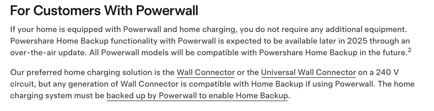

Anyone heard any updates on Powershare with Powerwalls?
