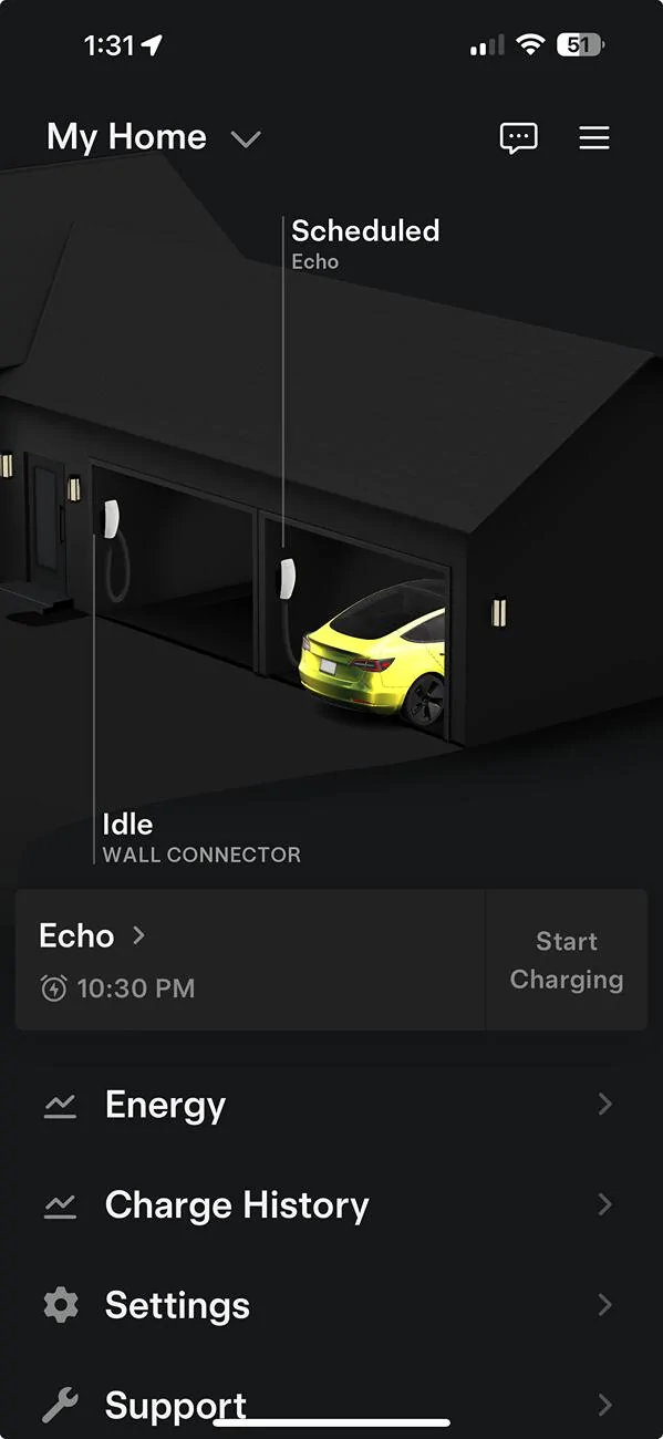

WiFi from the wall connector, aka “charger” is used for app connection shown below:
Tesla Roadster 2nd gen Wifi wall charger for the home. 1736447494233-u0

I don't know what to tell you man It didn't work for me automatically. And I've been using it without the wifi being setup for a few months now until yesterday something I saw here reminded me about it oh that garage scene in the app someone posted an image of the screen, and I realized I have never seen that on my app. So yes, I did have to manually add product and choose wall connector. I did also find the old installation instructions in order to scan the QR code. something I did do the first go around but without add product it didn't get me very far with the setup.
