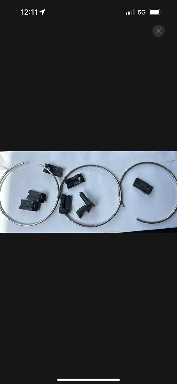

I have had my truck since November and I kept hearing a rattle. I took off the wheel covers (for the first time) and all 4 covers had broken plastic clips? this normal? Nothing other than city miles. No damage
