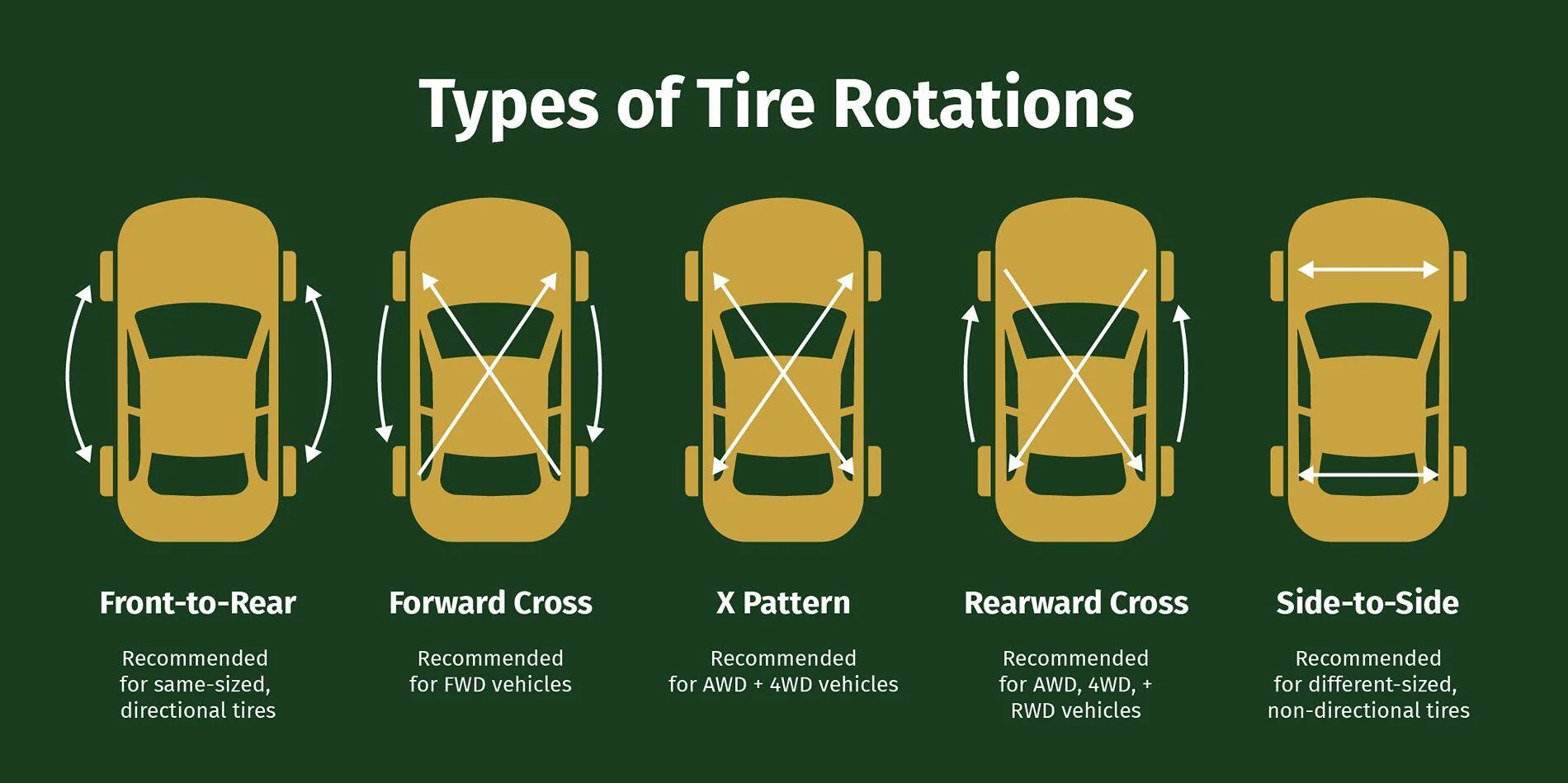

Just wondering if there is an ideal pattern for tire rotations for this vehicle?
Are we going for the X Pattern or Rearward Cross?

Since the ATs are not unidirectional tires then the X mounting rotation makes sense. But unless you have a lift or relying on a tire store to do the rotation you may have to go side by side or fronts to back (and backs to front). Of course if you have access to jack stands and a 3/4 ton rated car jack/or bottle jack you are set.

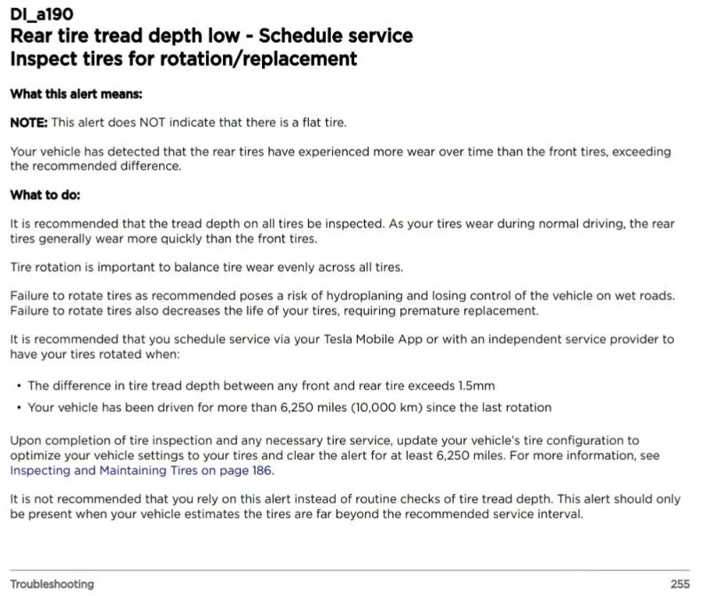

I looked in the manual but didn't see any recommendations so I guess they want you to go with the tire manufacturers recommendations (eg directional or not making the big diff).
Found this interesting warning message that mentions rotation. Likely track the rotation speed diff / delta between the front and rear.

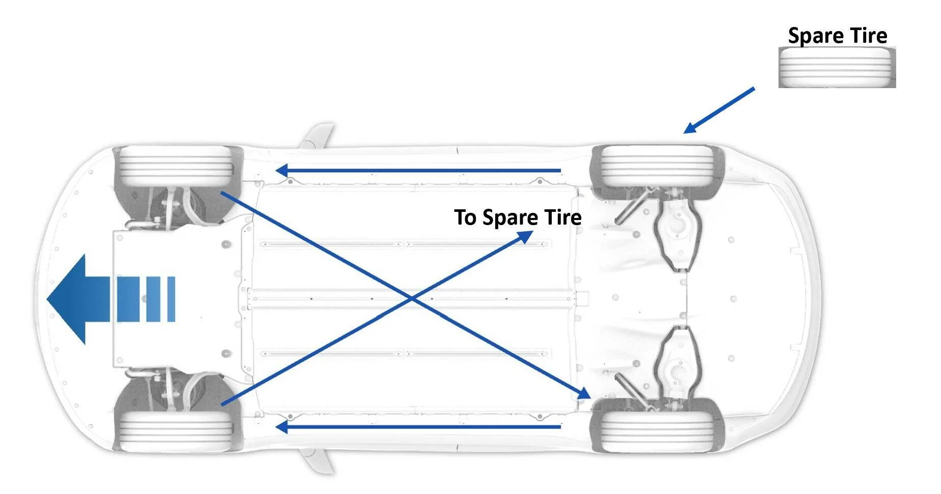

Rearward cross with a spare.
With a spare tire, one could rotate tires like this.
The good news, it is easy to do with only one jack (if you do it yourself) and theoretically you can get 25% more tire life.
The big question is when you need new tires, do you buy 5 and keep a spare that can be rotated in or just buy 4 and stop rotating the spare in all together?
