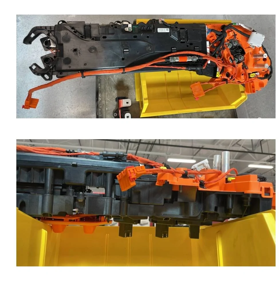

It's a big chunk of the Power Conversion System
https://epc.tesla.com/en-US/catalog...ea94-4f47-b74c-8331800d6185?part=1816026-S4-J
Tesla Roadster 2nd gen What is the device cluster assembly? SmartSelect_20250114_093402_Firefox
https://service.tesla.com/docs/Cybe...UID-0DEC6C08-C88C-4C78-AB8E-C90D6E58A49C.html
Tesla Roadster 2nd gen What is the device cluster assembly? SmartSelect_20250114_093707_Firefox
