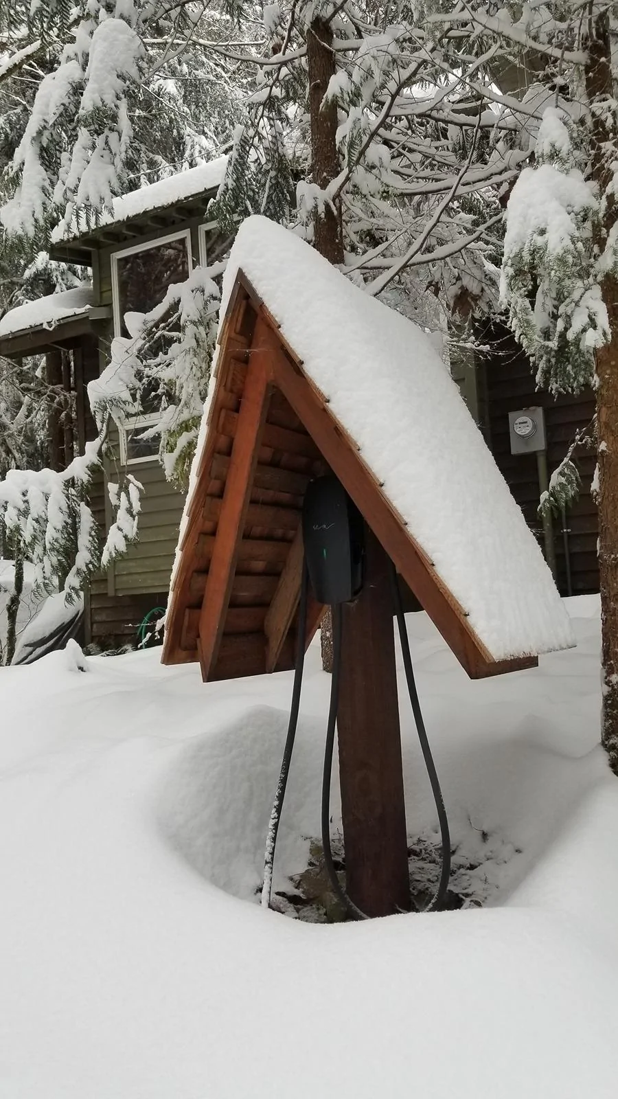

I did this installation myself. I dug the trench from the power meter/panel inside the house, installed plastic conduit, installed a pressure treated 6x6 from my lumber pile, built a roof for it it with scrap lumber from my woodpile (I had to buy the copper flashing and cedar shingles) and installed the Wall Connector Tesla mailed me for free since I had a referral. Then I wired it up with a 60 amp breaker, 35 feet of AWG 6 wire, AWG 8 ground (only needed AWG 10 ground) and appropriate conduit hangers.
Tesla Roadster 2nd gen What did you pay for basic home charger installation? 20201002_121516es
Cost of all the electrical equipment was less than $150 (if I had to buy the Wall Connector it would have been around $400 more). Cost to build the roof was around $200.
Note: The Wall connector is rated to be mounted on a bare post, out in the weather. I wanted a roof to shed tree debris and snow, to reduce time spent cleaning it. The structure is designed to last 50 years with minimal maintenance. The Wall Connector has been performing flawlessly for 5 years so far.
Here's a photo in the winter:
Tesla Roadster 2nd gen What did you pay for basic home charger installation? 20240117_131424

I did this installation myself. I dug the trench from the power meter/panel inside the house, installed plastic conduit, installed a pressure treated 6x6 from my lumber pile, built a roof for it it with scrap lumber from my woodpile (I had to buy the copper flashing and cedar shingles) and installed the Wall Connector Tesla mailed me for free since I had a referral. Then I wired it up with a 60 amp breaker, AWG 6 wire, AWG 8 ground (only needed AWG 10 ground) and appropriate conduit hangers.
Very nice!
