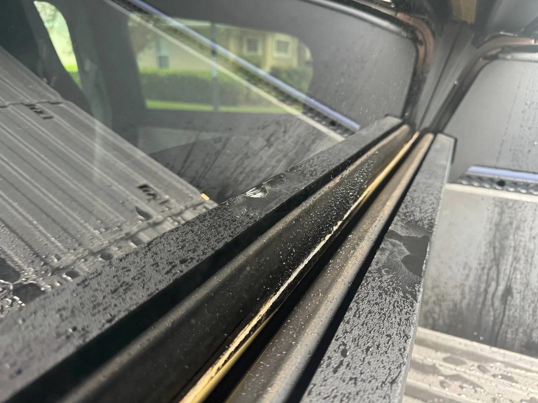

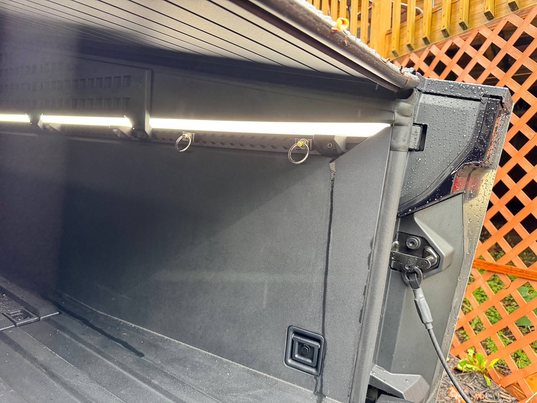

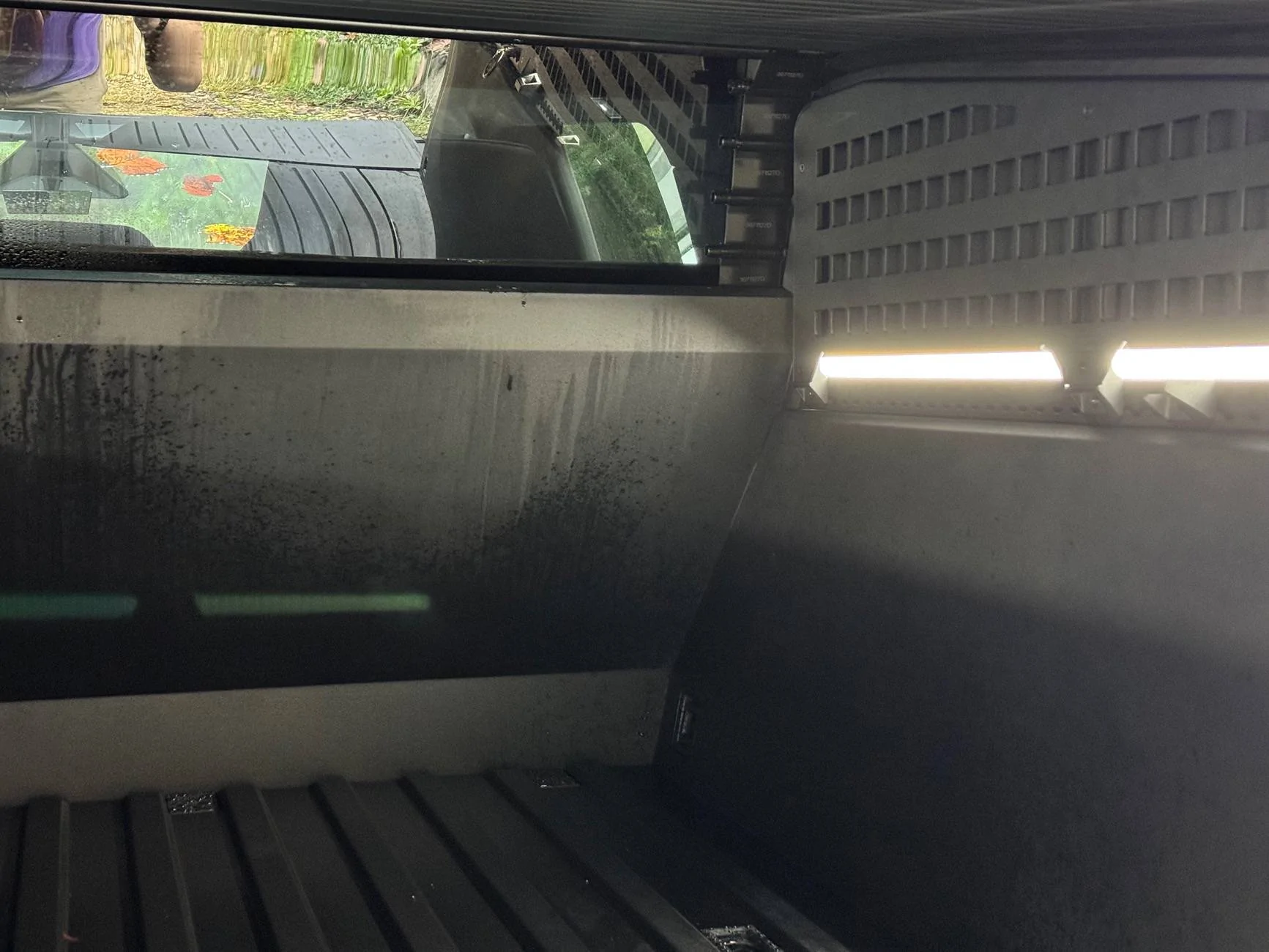

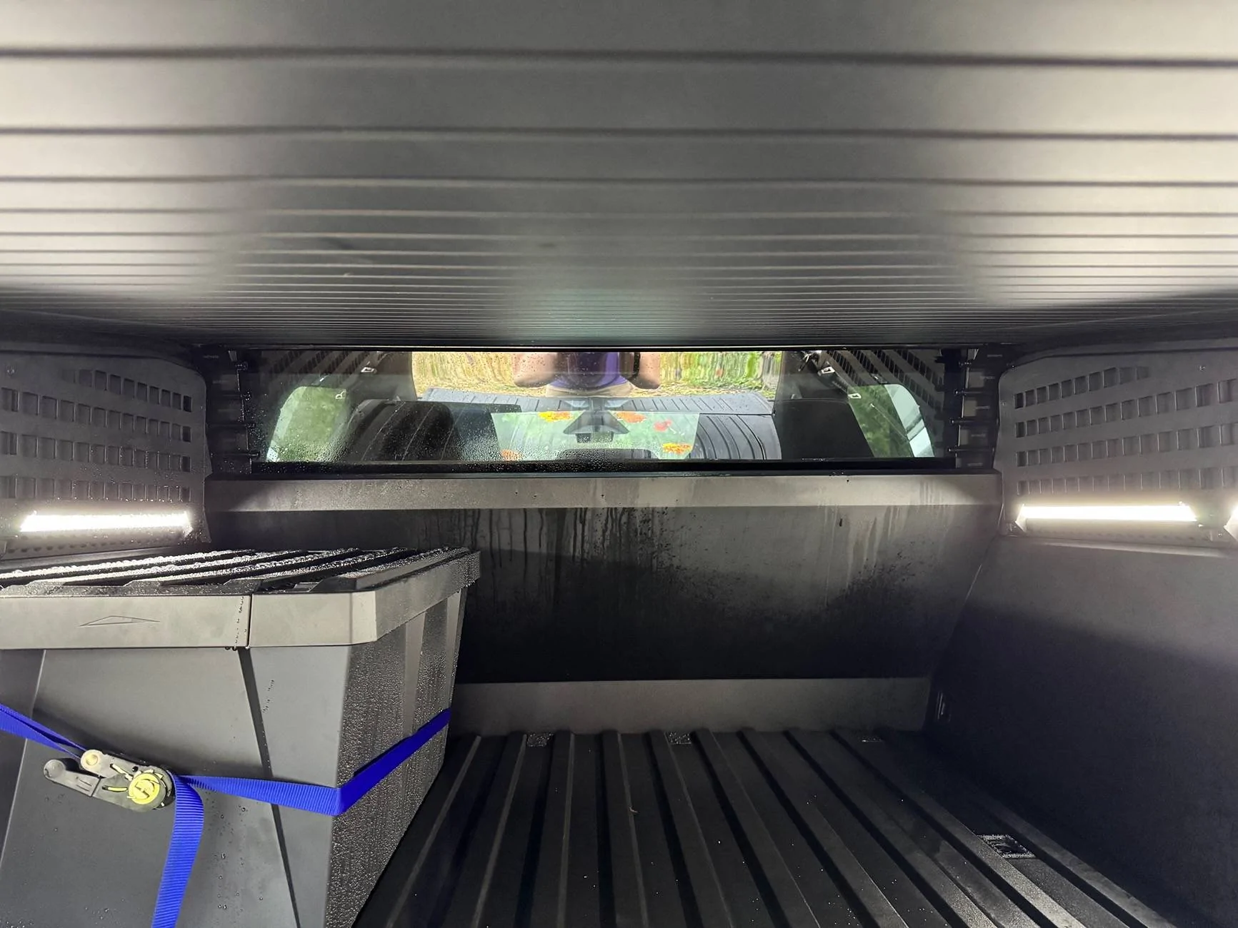

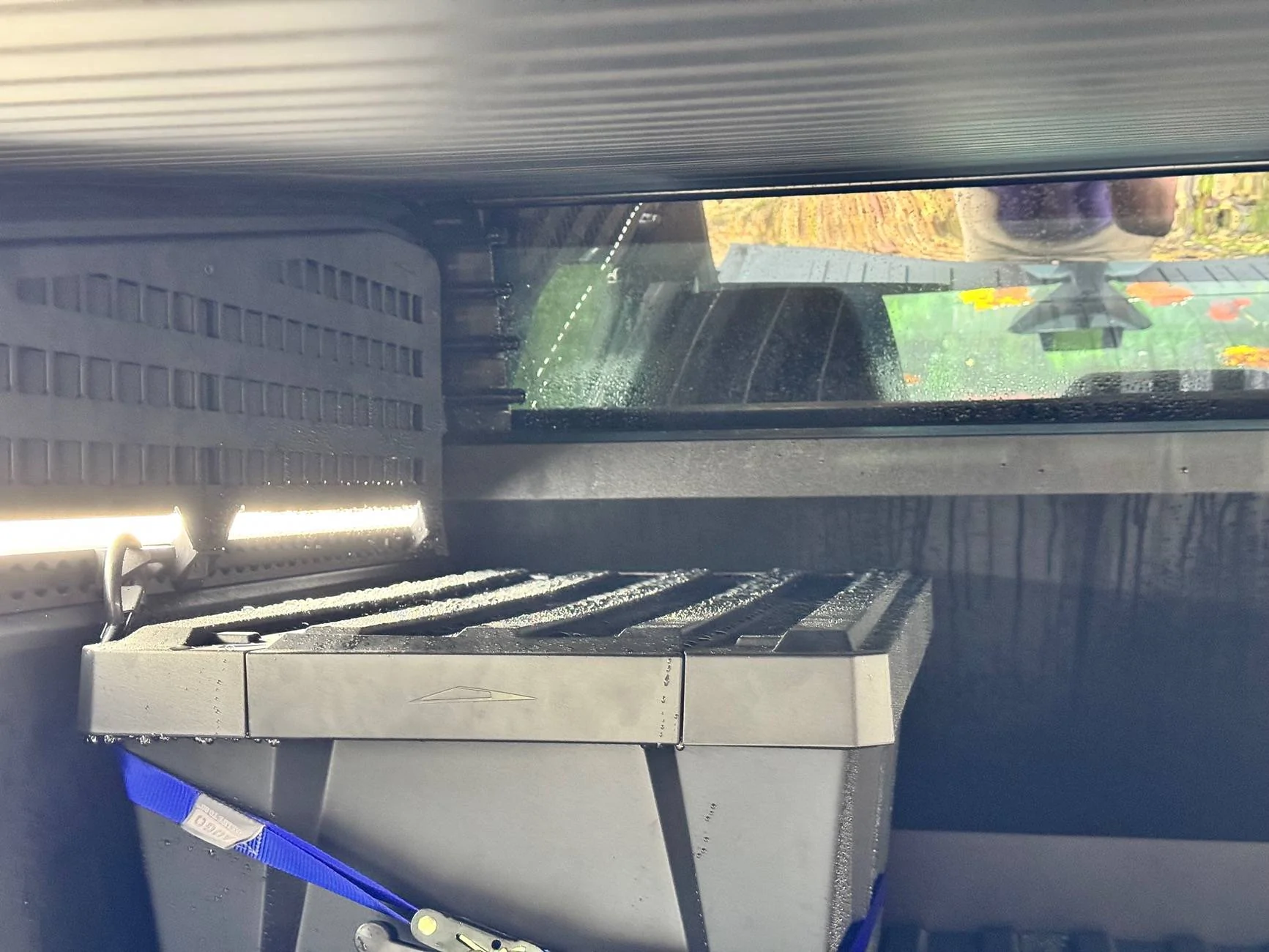

Got mine in service for the same issue. Water pours through the back, and some through a few of the L-track holes too.
Gonna send my advisor this thread to get their thoughts on this being the likely cause.
Tesla Roadster 2nd gen Vault cover question - missing piece? IMG_5251
Tesla Roadster 2nd gen Vault cover question - missing piece? IMG_5249
Tesla Roadster 2nd gen Vault cover question - missing piece? IMG_5252
Tesla Roadster 2nd gen Vault cover question - missing piece? IMG_5250
Tesla Roadster 2nd gen Vault cover question - missing piece? IMG_5247
Tesla Roadster 2nd gen Vault cover question - missing piece? IMG_5248

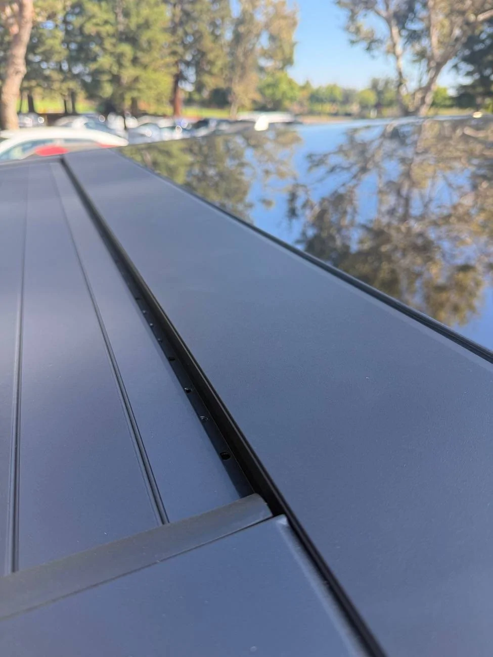

Tesla Roadster 2nd gen Vault cover question - missing piece? IMG_2721
This is mine

I had mine (vin 25xxx) in service center today. Showed the missing slat (28 vs 29). The service center advisor has never heard of the issue. He went and checked couple of trucks on the floor. All of them had 28 slats with holes in the back. No known recall was issued and it considered "normal".

I think those holes in the top slat position is actually the first fix. It is a gutter to direct water to the sides (the holes don't open to the bed but to the bottom of the slat so it flows out the sides). On my truck I noticed there was a gap between the felt weather stripping and the cover so am thinking there could be a fix coming for that.

Interesting theory. If the slat with the holes is a fix, it is very odd one.
