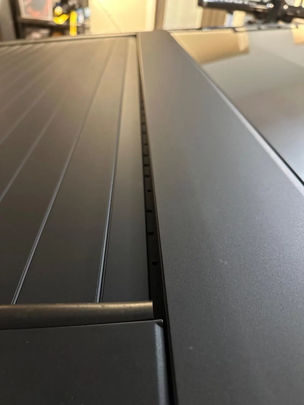

Does the top (forward end) of your vault cover look like this? It looks like something is missing and mine leaks like crazy in the slightest of rain.

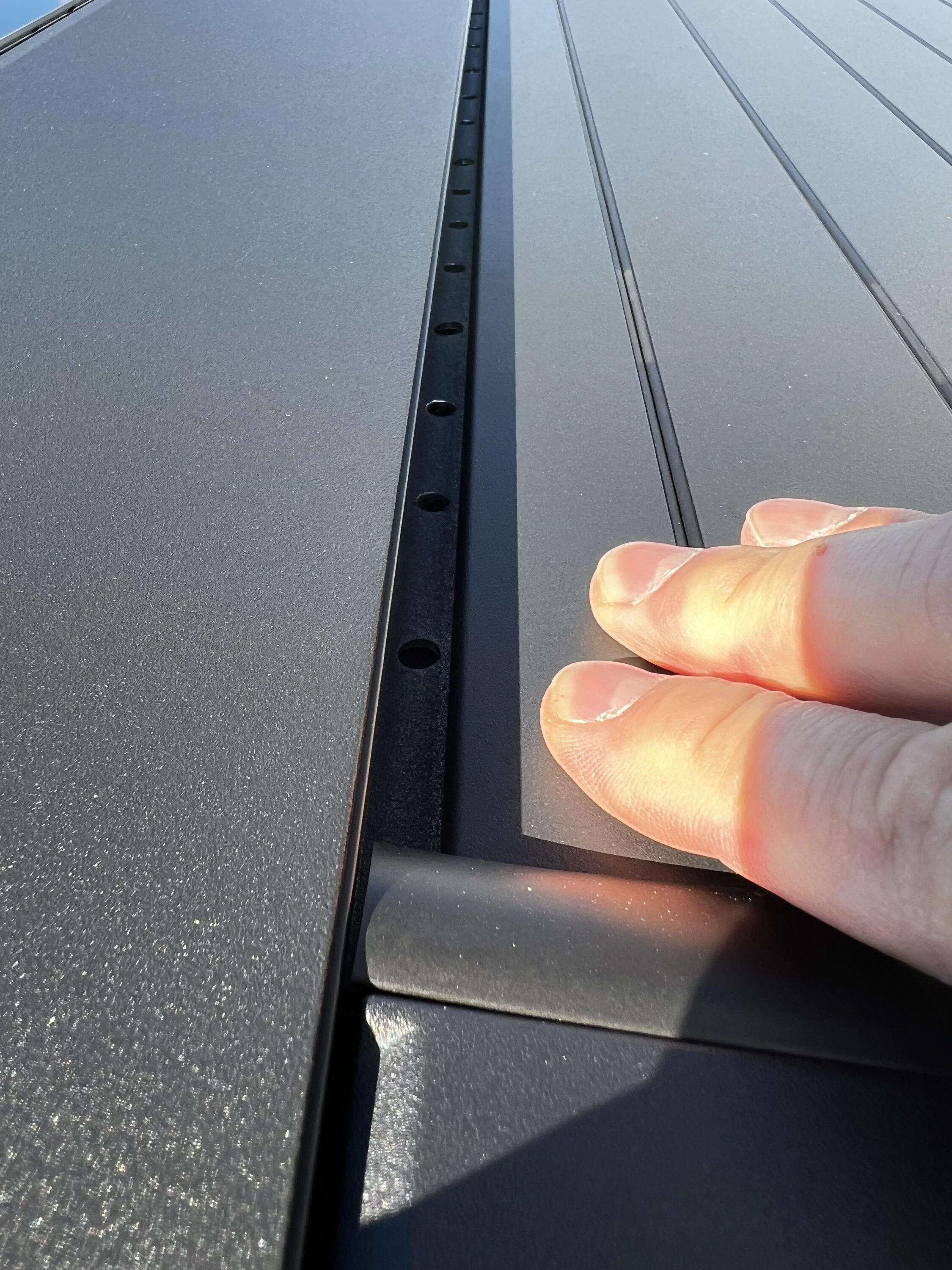

Here’s a better pic. It looks like something is missing. Can someone confirm if this is normal?

That doesn't look normal. If your tailgate was in the up position when the photo was taken, I wonder if you might be short one slat. I would have Tesla Service look at it.
Otherwise it might be deploying too far (past the tailgate) and require calibration. This looks like something that could happen if it was calibrated with the tailgate dropped.

I had a closer look at mine and determined you are not missing a slat, it looks like one of two things is happening:
1) The trim piece in front of the tonneau is too far forward (less likely)
2) The tonneau is calibrated to compress the tailgate seal too much (more likely).
It could also be a little of both. I calibrated my tonneau cover the second day of ownership and it stopped as soon as the compressible rubber seal touched the tailgate (it might have compressed it a mm or two). If it had kept going until the seal was well compressed, it would look just like yours.
No harm in having Tesla Service look at it (they won't charge you a penny). It seems like more of an aesthetic issue. I can look down into the crack and see that piece with the exposed fastener heads in it when my tonneau is closed, it's just about 1/2" less closed than yours.

I recently noticed this on my tonneau as well. The top slat is slightly askew, so the “perforations” are only visible on the drivers side. Oddly, the bottom of the tonneau is straight and flush to the tailgate.
I don’t recall seeing this gap before, so I’m guessing that the slats have a “break-in” period? ?‍♂
I’ve no idea if this gap causes water intrusion, it never rains here lol
