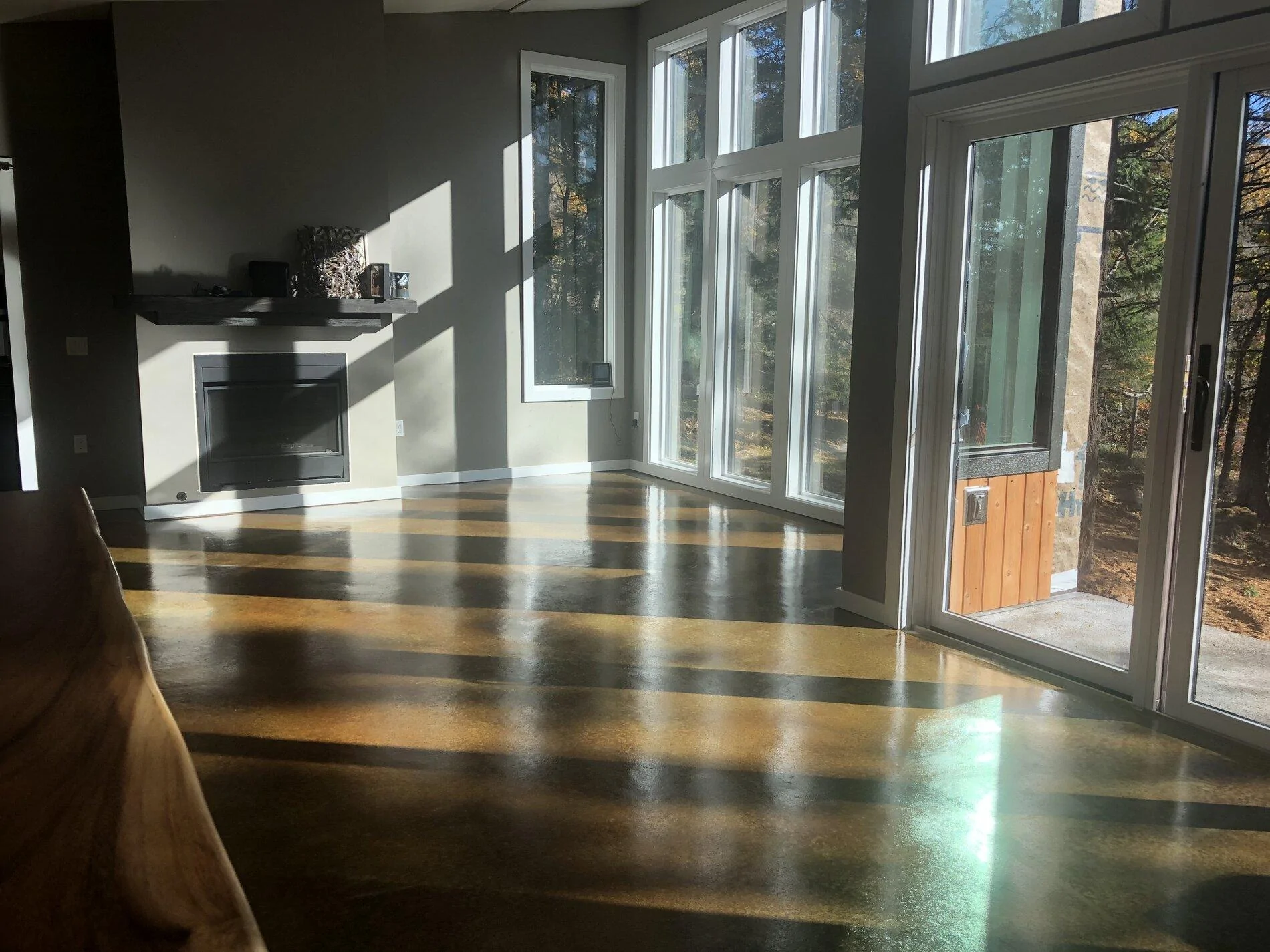

Depending on how you use your CT get out your calculator and consider battery life span and replacement cost. We completed our home up in the sticks over a year ago. Being in the construction trade, I've seen most of the designs from partial to fully off grid using wind, solar and even hydro. I went with silent concrete hydronic floor heat (tankless LP gas) and cooled by heat pump through a plate heat exchanger. The upstairs floor is 1 1/2" stained concrete over 1 1/4" PT plywood and downstairs is 4" concrete over 2" foam board. We love our stained concrete floors. 12k of solar panels feed back into utility when not needed. A 12k LP gas generator as backup gives us peace of mind. Our well pump is controlled by three phase soft start frequency drive. A majority of solar installers will recommend this system as the most cost effective, lowest maintenance and efficient. The home is ready and waiting for CT with charge and discharge capability. Good luck with your home.

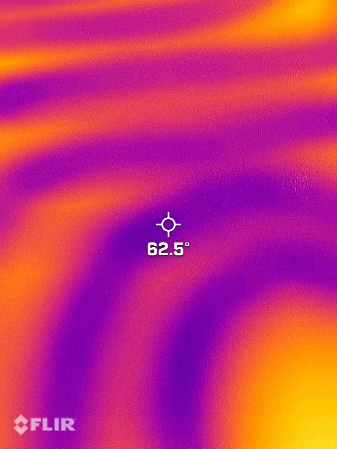

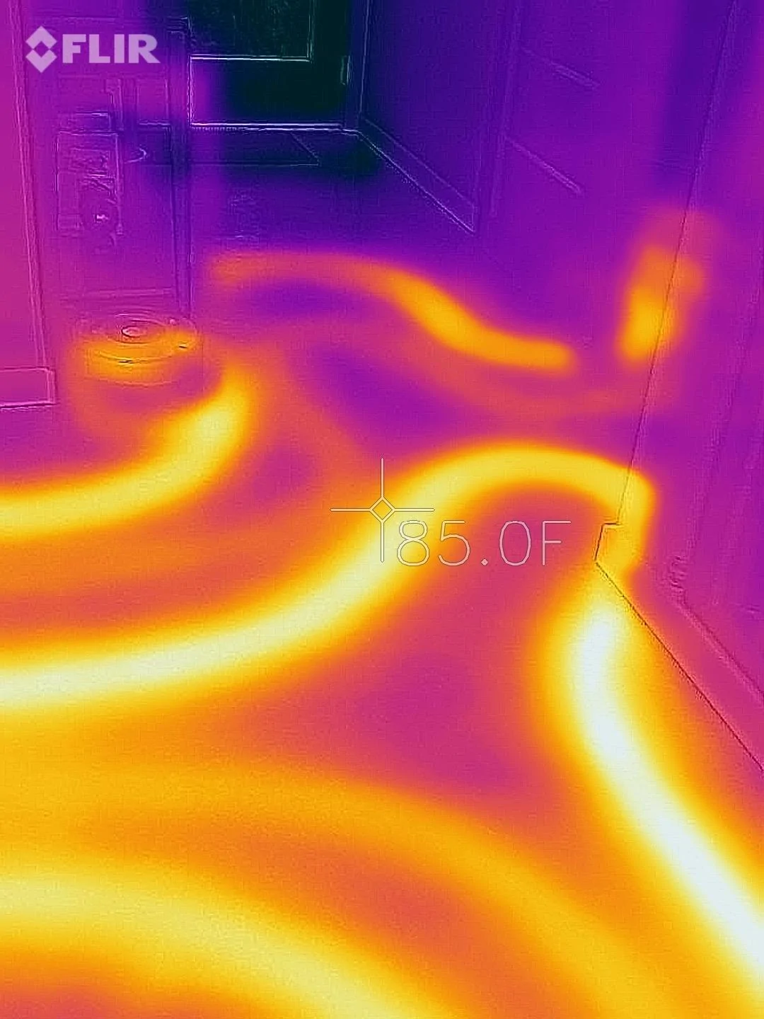

For a second all I saw here was a Roomba with some squiggle lines and thought you’d mapped your Roomba tracks.
Do you have it so when all that sun heats up the floor (and the fluid inside) that it can circulate it around to the rest of the house, without even running the heat? (ie, just run the pump)
This is a feature I have seen in some setups, but the cost seemed very high just for that feature...
Also, how many zones is your 1st and 2nd floor broken up into?
I found I really love radiant floor heat when I lived in Korea...
Yes the pumps circulate passive solar in winter and works better than expected. 3 zones on each level.
