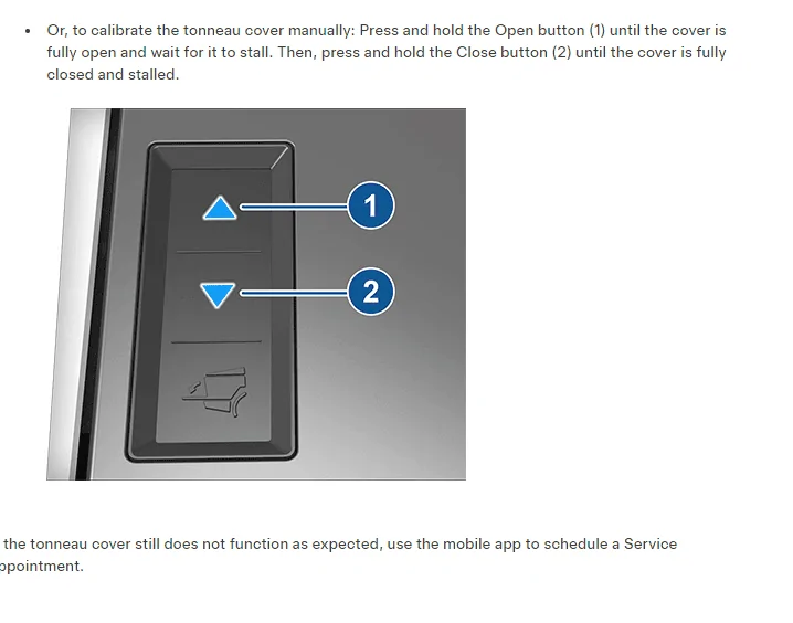

When I took delivery my Tonneau cover wasn't working correctly. My delivery-person went into the service menu and clearly navigated to the Tonneau calibration - which quickly addressed the issue. Now - 2 weeks later - it's sticking again. I'm assuming I can't go into the service menu - is this something logging an appointment could resolve - or ideally - be resolved remotely?

Manual calibration worked for me when I had your issue:
Tesla Roadster 2nd gen Tonneau Cover Calibration? 1721763815642-um
This has never worked for me unfortunately. Always have to put it into service mode and calibrate on the touchscreen.
I am actually starting to believe the issue isn’t the tonneau and my bed may be a smidge off

Adding to this thread because it seems like the place to say this. My tonneau worked fine at delivery, and for over a year after. At some point on a road trip, the function to fully open or fully close, stopped working. The bed light also failed to come on when the tonneau was opened by holding the button down. I was planning to schedule service when I got home, but I noticed on the screen in the truck that the tonneau button did not say open anymore, but Calibrate. I touched that, told it to do it, and everything is back to normal.
The instructions are a bit nebulous because they don't specify whether you do a full press and hold, or a half press and hold (the button has a detent with a half press).
