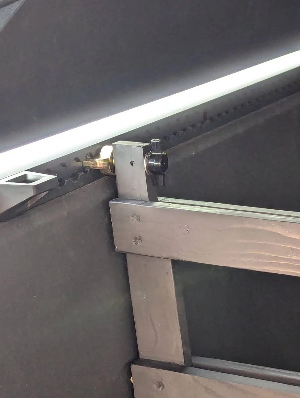

A little unconventional, but I set out to build my own cargo divider just because. It was a quick prototype that I ended up sanding and staining as I won't have time to build a more "proper" one for the time being. I think it turned out pretty good!
It's made of white pine (though any softwood would work), and uses some standard L-track hardware. While not as fancy or quick to move as the OEM divider, all it takes are two hand screws to set/remove.
Parts list with cost:
- L-track threaded attach points: 2 for $12 (https://www.amazon.com/gp/product/B07W8ZXHYB)
- Thumb screw bolts: 2 for $9 (https://www.amazon.com/gp/product/B0CRZ9F9KQ)
- About as much wood as two 2x4s (8 foot) would yield, so like $10 except that I make my own wood so it was free for me
Total: $21 + some for the paint
Pros:
- basically free
- very light cause it's pine
- can be extended to have 2 more attach points at the bottom and flipped 90 degrees to act as a table
- customize the height if you have a floor mat
- DIY
Cons:
- none, this thing is great
- fine, it'll snap in two if you smack it hard enough, but then I'll just make another for free as the hardware won't go anywhere

Dude.. don't pay attention to the haters... just getting those angles right would drive most people insane. Add to that getting things flush with the sides, top, and bottom. This is fine work. Could you cut some plugs to finish those screw holes a bit? Sure.. but then the haters would say "stop being fancy, it's a work truck". As it is, that's an impressive piece of construction from someone who knows how much of a pain that is.
Sure, the guys who do crown molding would be able to do this in their sleep but normal humans would find this tricky.
If it works out for you, you could sell the plans for a couple of bucks. Maybe add some mini cross braces to spread out those tension forces when something impacts.
Anyway, good job.
