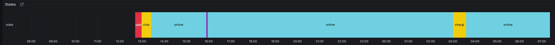

Just ran 1 charge to verify it's collecting:
