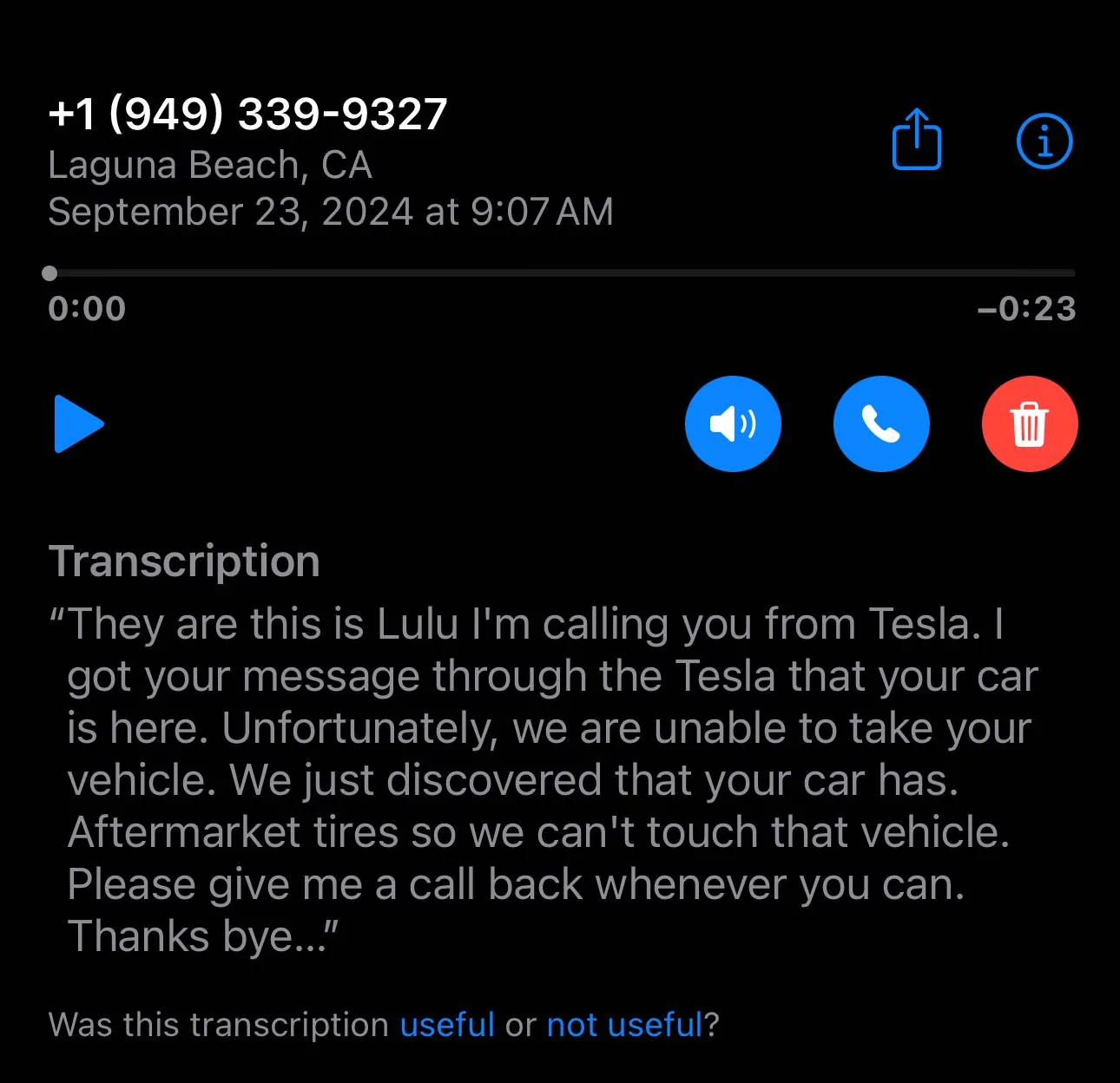

I was planning on purchasing non-OEM tires for my CB as I hear they burn through tires every 6K miles, however, I recently discovered that Tesla refuses to work on vehicles with tires that they don’t personally certify, even when the sizing, speed rating, etc. is the same. Has anyone else heard of this? They refused to work on my Model S because I have Bridgestone tires (exact same specs as OEM). They called them “after market” as though they were modified but they are not.
Tesla Cybertruck Tesla Refuses to Work on Vehicles With non-OEM Tires IMG_3050
Update: to add more context, service request was because the front driver’s side tire (one of four) was rubbing the fender when the steering wheel was turned. Vehicle has OEM wheels. Issue was later determined to be a worn bushing on a lower control arm.

I'm pretty sure that there's more to this story than non-OEM tires. I suspect that in this case, there was non-OEM wheels and that the Service Request was for something with the wheels.
There have been hundreds of thousands or maybe millions of Teslas with non-OEM tires installed, and AFAIK, Service has never rejected one.
Even Tesla recommends to go to Discount Tire these days for tire issues.
So, for tires, as long as they are just standard types, I'd expect no problems. But change the wheels out and add spacers and expect Tesla to work on the brakes, that may be a different thing.

No, these are the standard wheels.
But yes to the repair having to do with tires/wheels as the fender and front drivers side wheel were rubbing. Had to take it elsewhere and found that the lower control arm had worn bushings causing the entire arm/ wheel to shift about an inch or so forward and backward.
