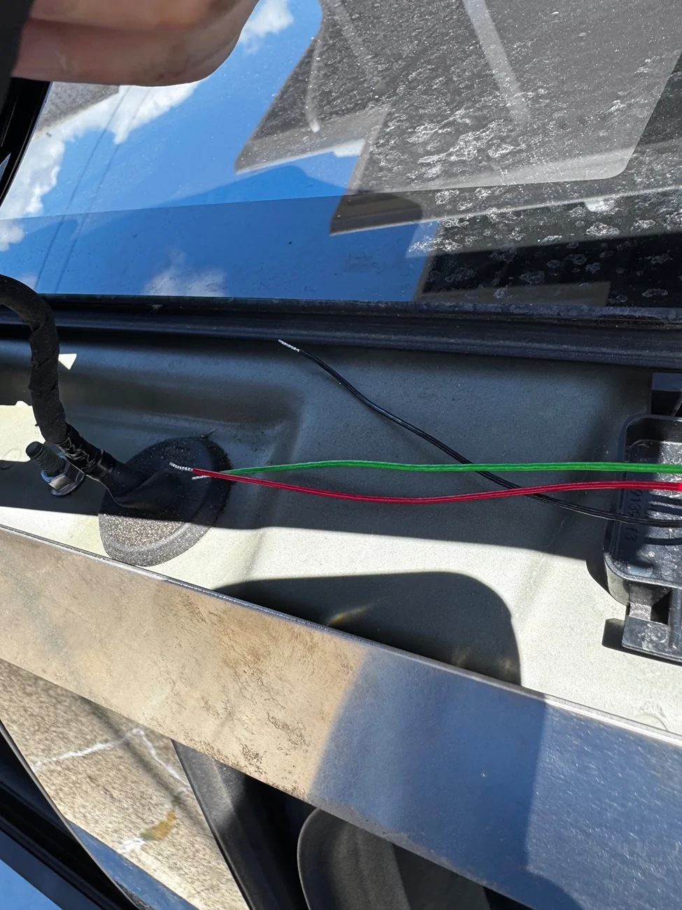

What about last week lightbars. Are you saying it's an early lightbar? There was no connector on the lightbar, just three bare wires.
Same, installed two weeks ago and service left me with the three bare wires, no soldering or connector.
so this was the phase one light bar, they should had given you a packet and install instruction, and 3 wires with a plug on the end that you would have to solder and insulate. phase 2 light bars that came out in Feb along with the new adhesive, have the plug on them and all you have to do is remove the passenger's side B Pillar Camera cover with a 10mm and plug it in, i would ask for the wiring kit with the plug from the service center.
Oh I did. And they have been going back and forth. I’m the first one installed at this service center.
