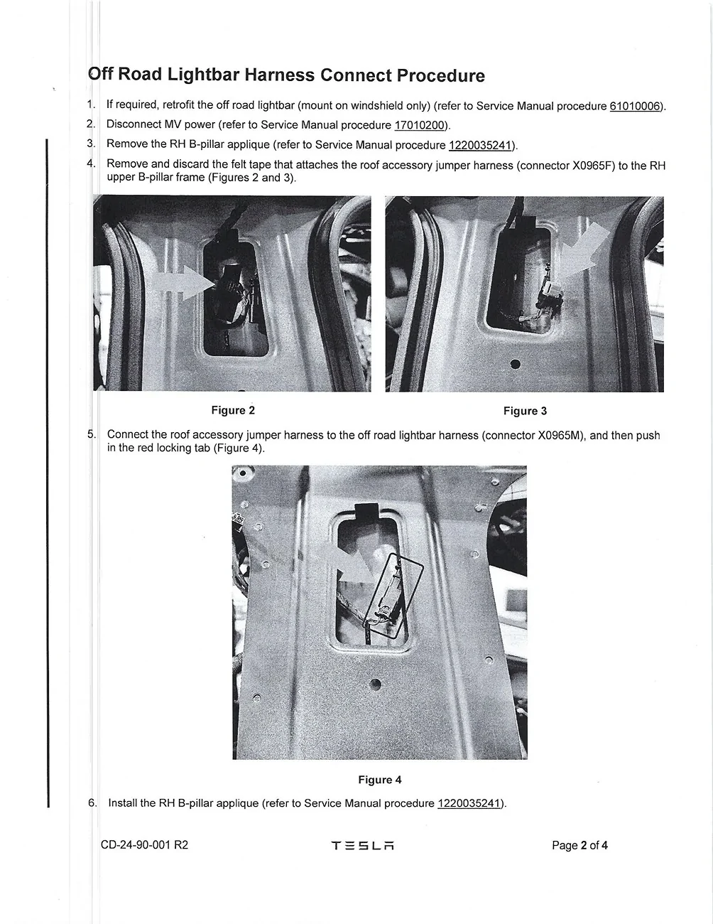

Here are the steps YouTube video's didn't mention (or have to do in each particular case):
  1. I did NOT disconnect MV power as discussed in instructions below
  2. ONLY had to connect jumper harness to off road lightbar harness under right side B-pillar (did NOT have to connect any wires on roof as some other CT owners had to)
  3. Get in and make sure all doors shut

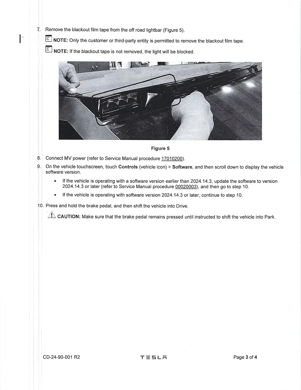

  5. On touchscreen, touch Controls > Outlets & Mods > Power Feed (place ON)
  6. Shift into Park, and release brake pedal
  7. Exit vehicle and allow lightbar configuration update to complete (Doesn't mention how long. I waited a few minutes before reentering)

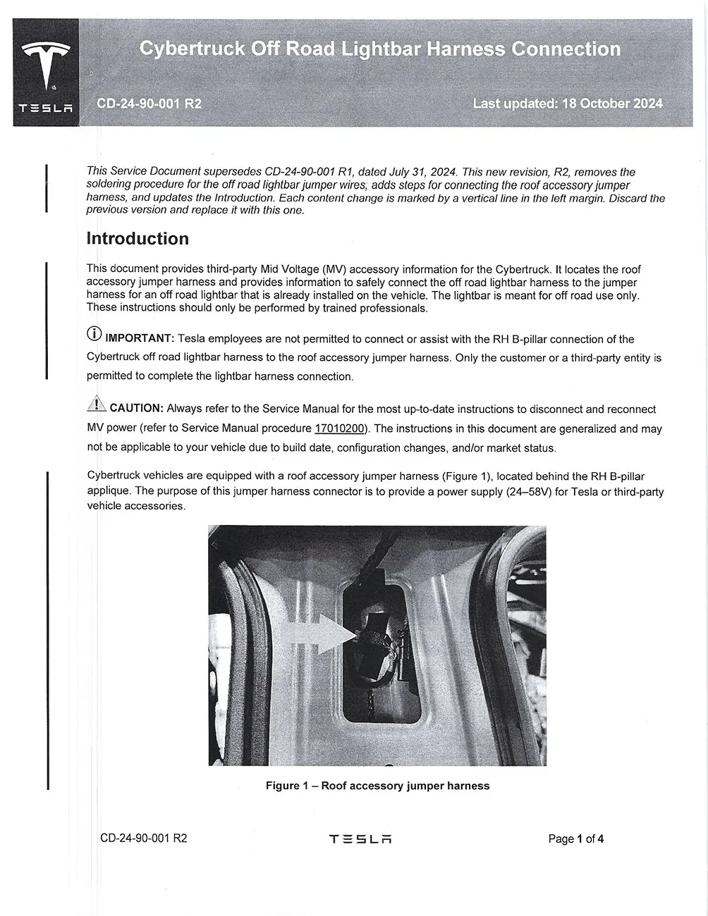

Tesla Roadster 2nd gen Tesla Lightbar Install Page 1
Tesla Roadster 2nd gen Tesla Lightbar Install Page 2
Tesla Roadster 2nd gen Tesla Lightbar Install Page 3
