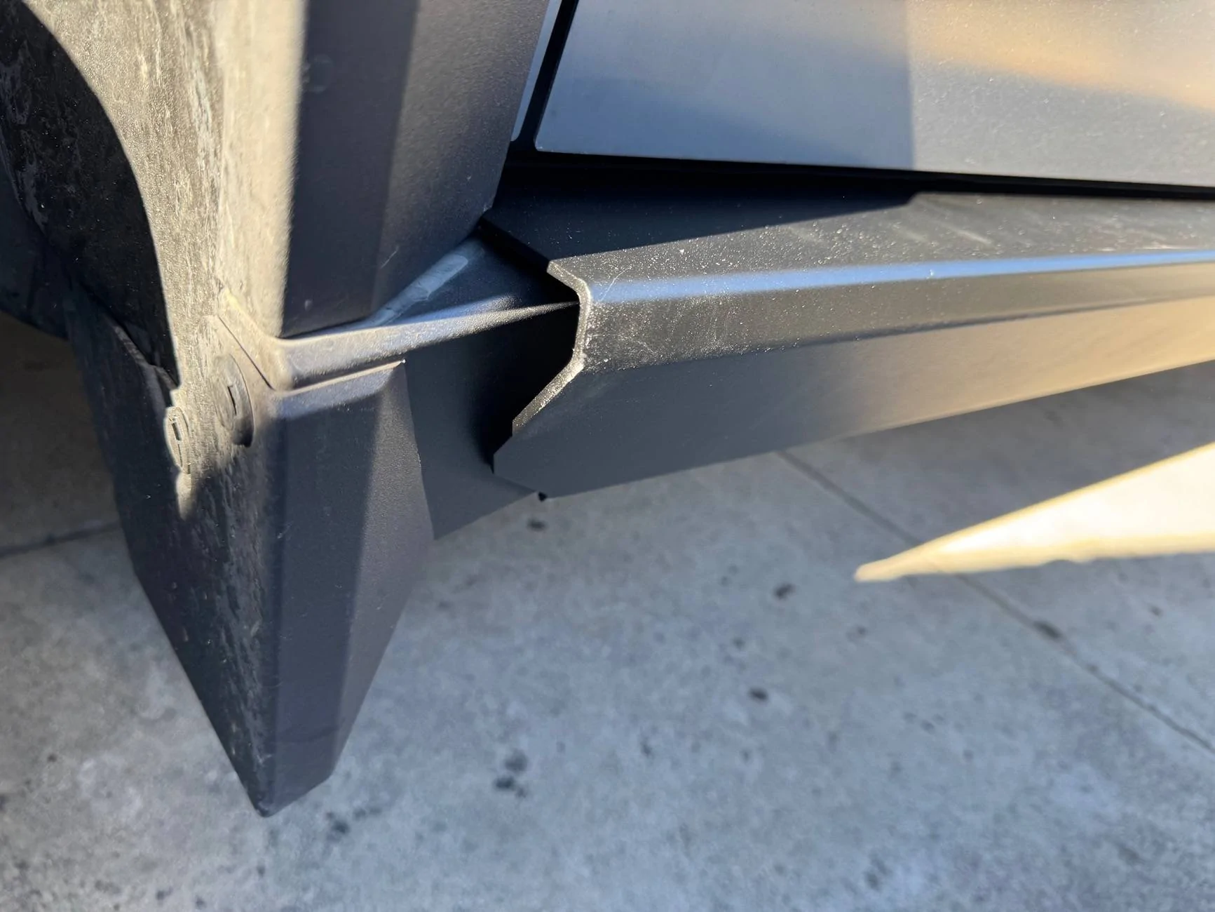

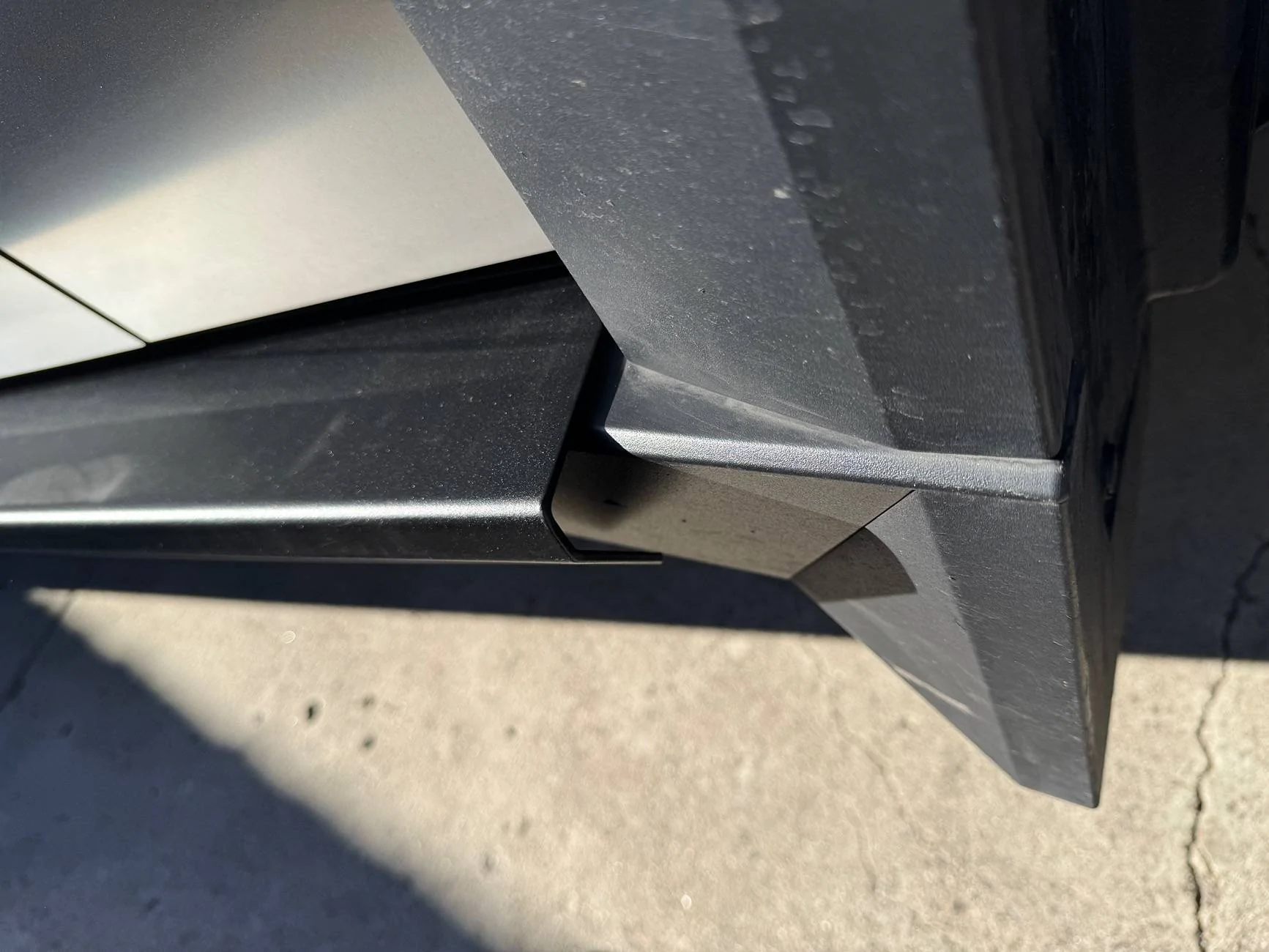

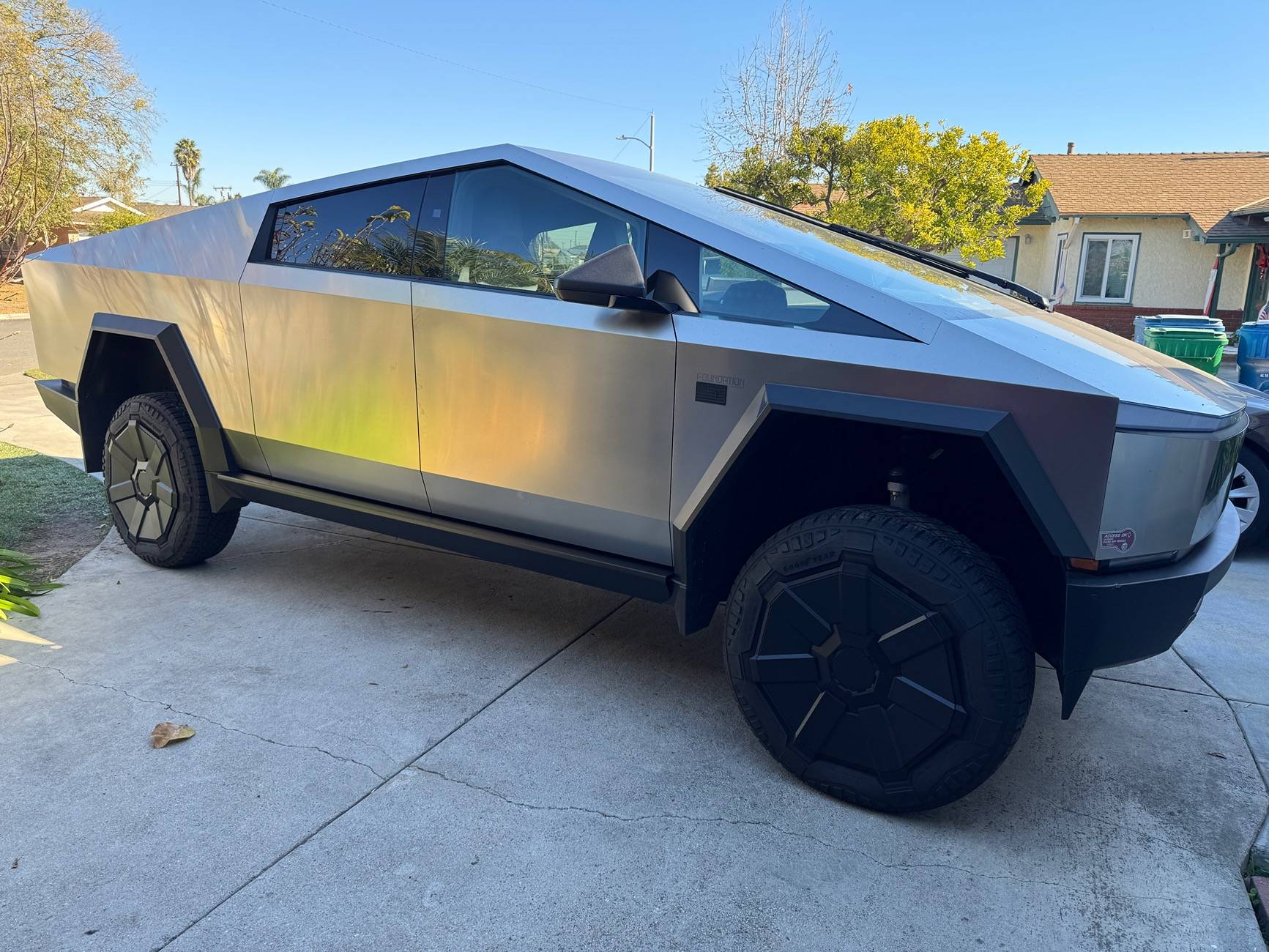

Hey All,
Installed my side step today and it is easy as T-Sportline described. It takes me about 1hr to install both side. I pre-ordered mine when they unveiled it. All I need was just side steps, and this is exactly what I want, comparing to most out there. For the price, $700 plus tax, cheapest I could find. Made from powder coated matte black carbon steel, 1/8” thick. Overall, I would recommend this.
The minus is the bolts and washers are zinc coated, not stainless steel. I could replace them with stainless hardware later down the line if they rusted. The gap size at both ends are large enough for small animals to hide in side. I will 3d print the caps to avoid future issues.
I used undercoat paint to add protection. See pictures

Any 3d print design files to cover the front and rear gaps and blend with the fenders and mud flaps?
Not yet, I am working on it.

If they protected those stupid plastic rocker ends I would buy in an instant. I down 2 since June.
It would looks better too with the end covers are there. It's an eye sore every time I glanced at it. I can live with it until I design and 3d print to cover the void.

The bolts are a proper automotive zinc coated bolt spec - keep in mind, the stock Tesla bolts all over the truck suspension are coated carbon steel as well, not 'stainless steel' bolts. Stainless bolts are not as strong or durable, btw - so we (and OEM's) tend not to spec stainless in load bearing situations.
As for the end caps, first -- unless you're right up on top of things looking for it, this doesn't typically catch the eye. If we get super close to the trim, we risk parts rubbing. There is not room for 'nesting' animals, ha ha. It's enough room to let water rinse through. For those that prefer a different aesthetic, we also have side steps.
