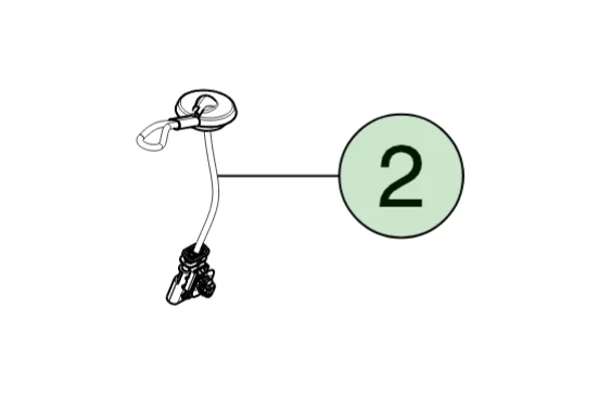

Can anyone tell me what the part is called, that little pig tail that was not used here in this post. It is the connection for the upper light bar and I can not find it in the parts catalog. I am getting the roof appliques for crossbars on my 2025 all wheel drive CT installed in a few days and I was told the I also need to get this pigtail because the 2025 did not come with them.

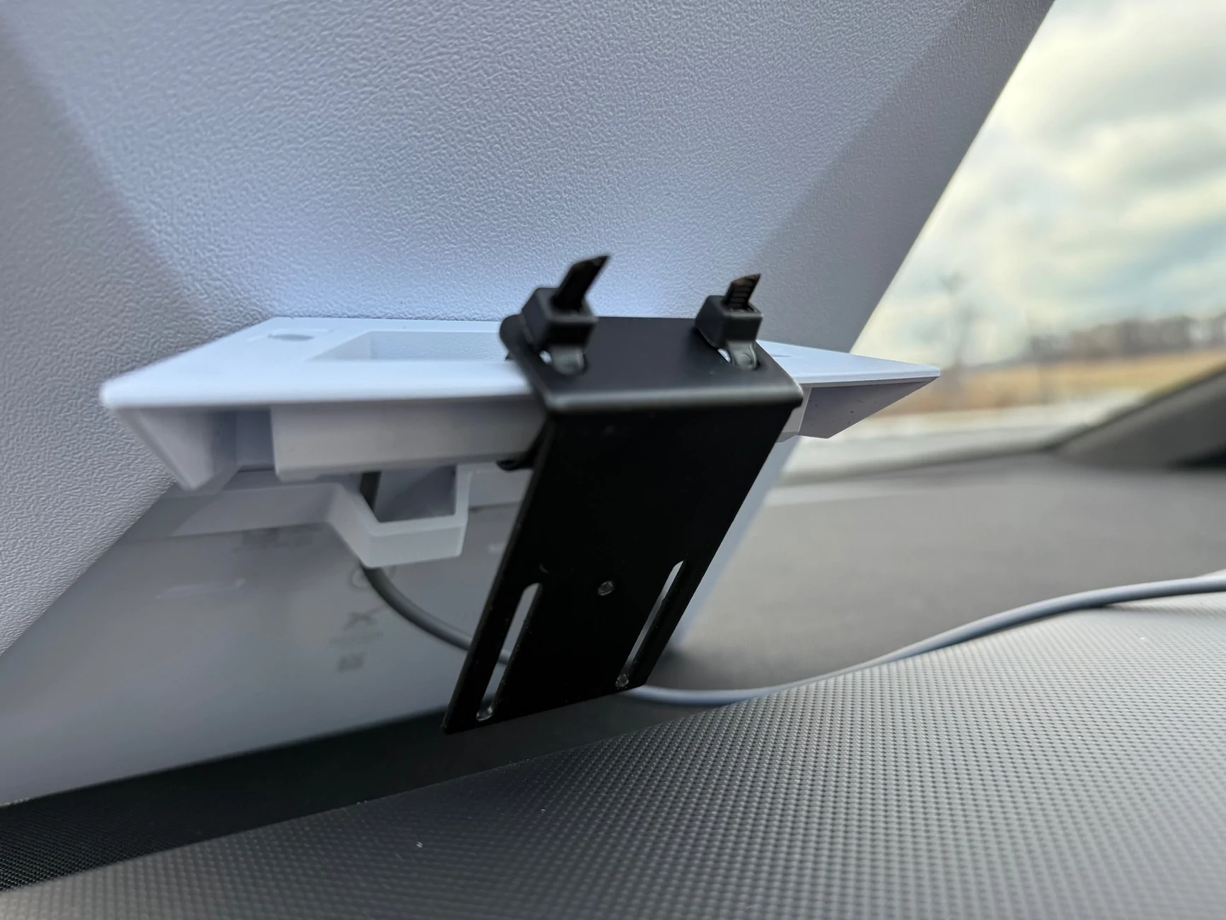

After moving it around a few times (on a crossbar over the roof and inside the cabin on the dash and on the glass roof), I think I’ve settled on this. It’s just easy this way. It’s safe for occupants, doesn’t interfere with the doors or lightbar harness, and is easy to remove if needed.

I found the simplest install was to add a piece of Velcro to the back side and place it on the dash. Never have signal issues. The cable stays managed inside the center console where it’s plugged in. It’s easy
I used a rack ear from a piece of network equipment, and a couple zip ties. This slots between the dash pad and the front console frame - it never moved at all - even when doing some pretty gnarly trails. I ultimately mounted it on the inside of the rear top glass roof with a 3d printed mount and suction cups though.

3,498
3,013
HARNESS-ROOF ACCESSORY JUMPER
1866224-00-F
Sold by Tesla; None
1 Order In Quantity 1 Repair Quantity
Unit Price: $10.00
Tesla Roadster 2nd gen Starlink wiring through crossbar door SmartSelect_20250728_213049_Firefox
https://epc.tesla.com/en-US/catalog...acd31f90e97?part=1866224-00-F&autoscroll=true
