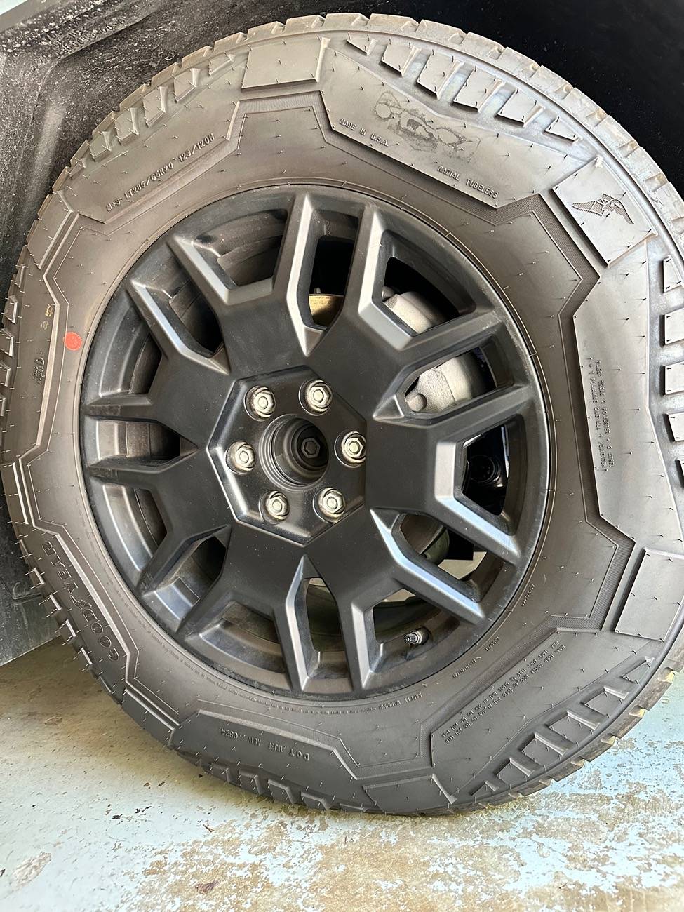

Here's the solution to our "1st World" problem OP. It's pretty easy to operate yourself, or, you can hire someone to point the business end at the issue and press the spray button.
https://a.co/d/0ONj51A
Here's the result.
Tesla Roadster 2nd gen Rust in the centers of all four wheels. IMG_1767

Did you have to do any prep work To remove the surface rust?
No, other than a quick wipe with a damp paper towel to check for dirt. You can spray Rustoleum directly over light surface rust.
But if that light rust bothers you, you can use this instead. The color doesn't match quite as well but it's supposed to chemically "transform" the rust. I didn't bother because I've had some much success just using the other product by itself.

Just leave the rust. It's always been there. It will always be there. Every car. Every manufacturer. Every motorcycle. Every truck. There will always be rust there. Or, I suppose, you could go through the effort and sand the rust out, grease the area, and enjoy seeing a greasy, dirt-filled area instead... Get the little covers from Abstract Ocean or somewhere and cover it. They are nice little covers and look good. Or, put your big covers back on and move along. My 2 cents.
You are correct, Ty!
I only painted mine (just the part of the hub exposed by the wheel, with absolutely no prep work) because I hadn't put hubcaps or wheel covers on my truck yet and didn't like the way the rust looked. I already had the paint and it took about 15 seconds per wheel.
Incidentally, I installed a set of the little aftermarket hubcaps not long after I painted over the rust. Months later I pulled off the hubcaps to install the OEM wheel covers and the hubs looked just like they did after I painted them - no rust.

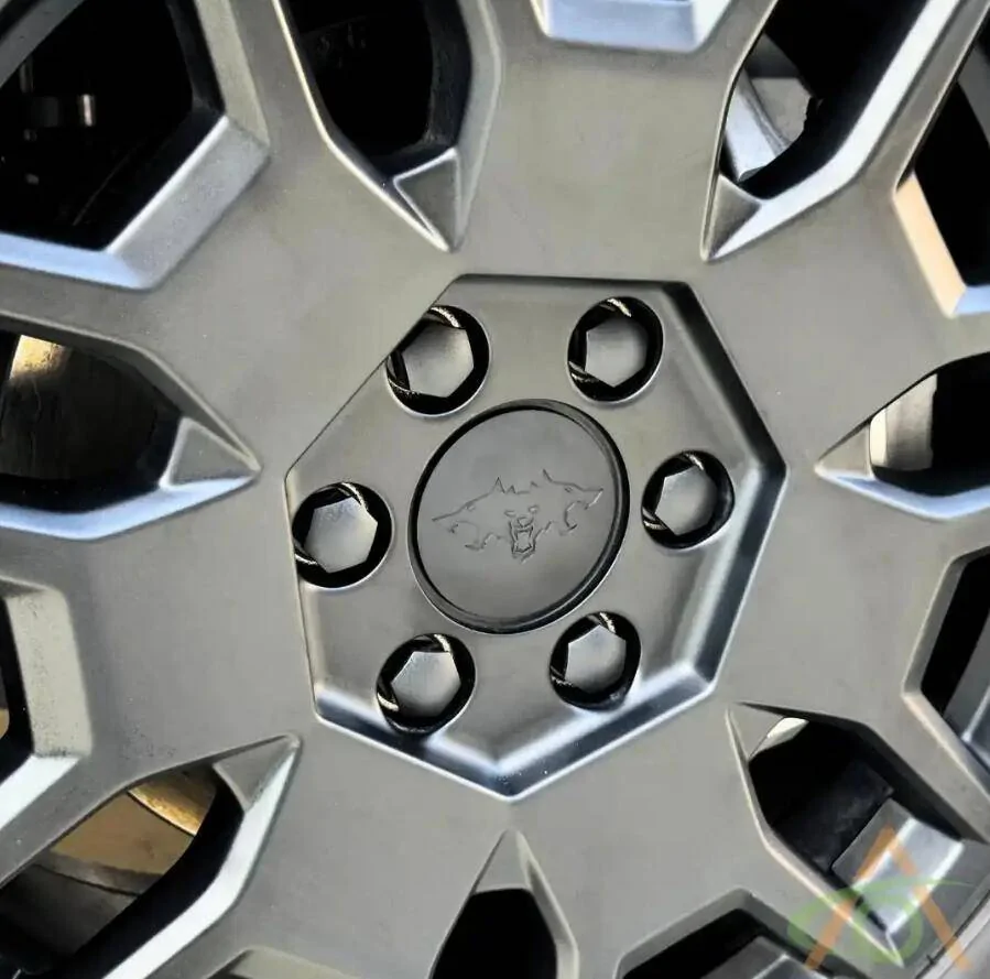

Good to know. I thought about doing that but didn't feel like taping off the wheel or lifting my beast. So, Abstract Ocean to the rescue: Center Caps
