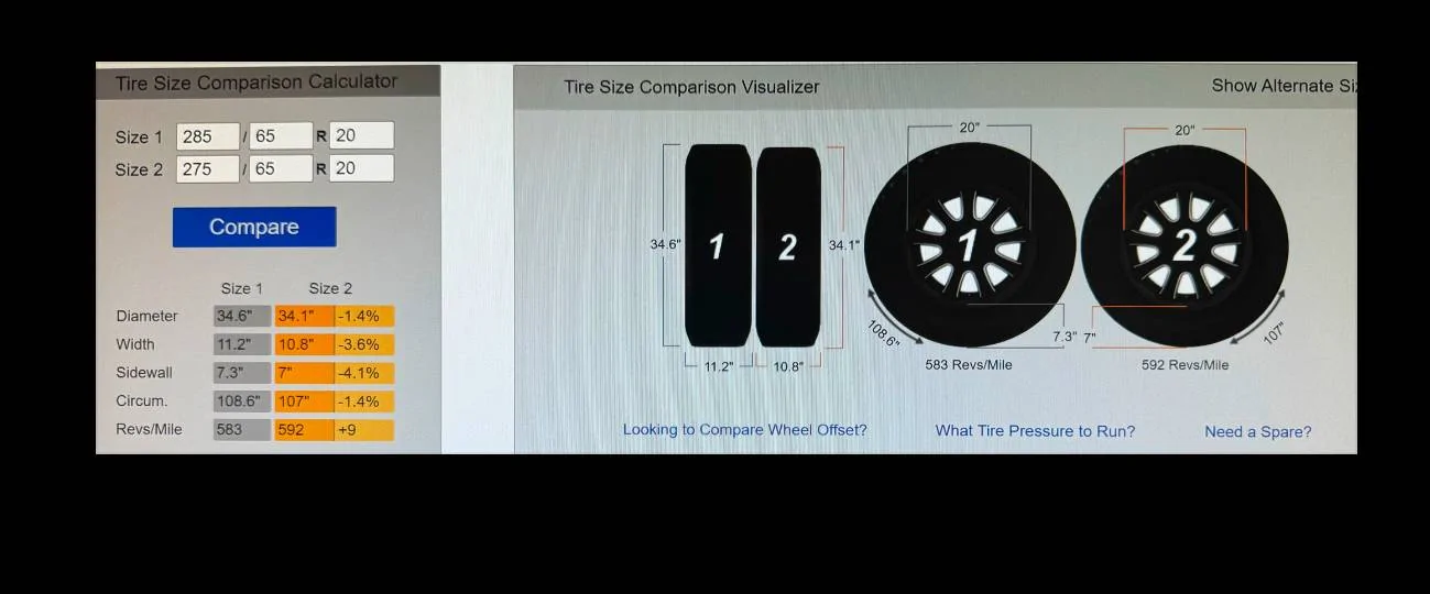

I do not see blizzak or nokian snow tires that fit the cybertruck 20" wheels. I still show the duratrac wranglers (different from the straight duratrac) tires as being snow "winter" tires. What am I missing, lol?

It’s not an exact fit - you have to go down to a 275 tire it’s a touch smaller but it will fit the stock 20 inch rims- ends up being a 34 inch tire instead of 35

ok thanks for the information.
after doing some quick research it looks like the blizzaks are better in ice and the nokians are better in snow.
i think i'm going with the Nokian Hakkapeliitta LT 3 non studded for my vermont winters. I also got the snow chains from the tesla store as part of my $2500 store credit package. I think i should be good.
Since I'll be driving less than 50 miles away from my house usually with the truck, the nokians seem to make sense. The duratracs aren't as loud for longer trips though. Is that the consensus?

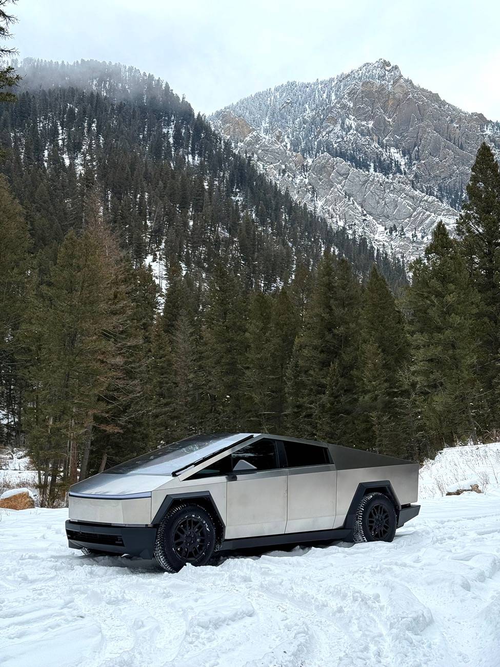

How did it go?
Got 480Wh/mi on the road trip home with Blizzak LT winter tires. Traveled between SLC and West Yellowstone, 35°F start 24°F end, 2200’ elevation gain, and no wheel covers. This includes preconditioning for two supercharger stops. It was a little windy, from varying directions.
This equates to roughly a 256 mile range at a relatively fast highway speed, assuming use of the entire 123kW battery. Most of the trip was 70-80mph speed limit, last 100 miles was 65mph.
Zero critical FSD disengagements over 350 miles. Very minor issues with lane choice and speed. So much smoother than my Model 3 Is currently.
