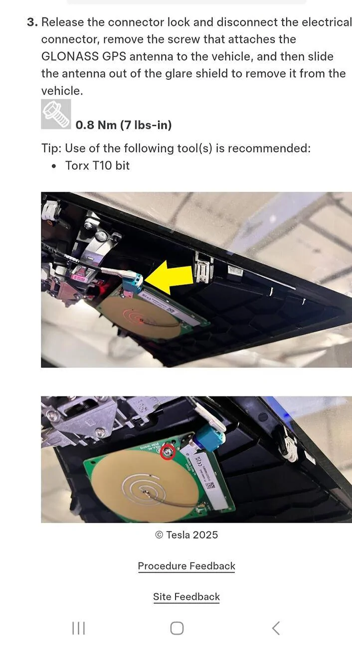

I note that the GPS antenna is above the mirror, and seems to be sensitive to interference. My truck complained a couple of times about degraded GPS performance, so I moved all wiring away from the antenna and it seems good now.
