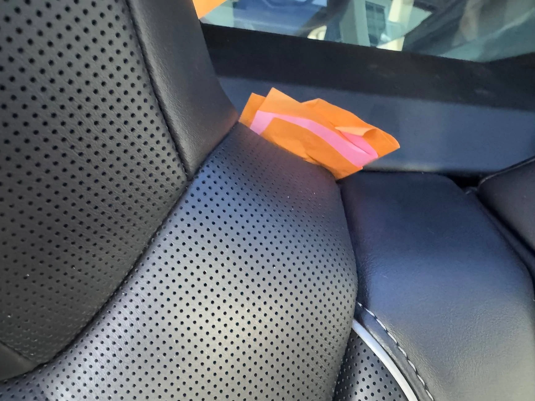

Just took delivery of a new Cyberbeast but there was a rattling in the rear that was driving me absolutely insane.
Turns out the plastic trim at the back of the seat is loose, so I put some shims between the seat and trim which fixed it.
will take this to the SC later and see if I can get a permanent fix.
hope this helps anyone else that might have the same problem.

Yup I have the same. I noticed the black plastic behind the seat is broken. Will have them replace it

you could at least use some black paper, LOL.

I feel like every Tesla owner should have a roll of this, it takes care of any rubbing issues, got a few pieces in the CT, the worst being the side of the drivers seat rubbing the center console.

You can also put leather polish on the seat between the center console stops the noise.
