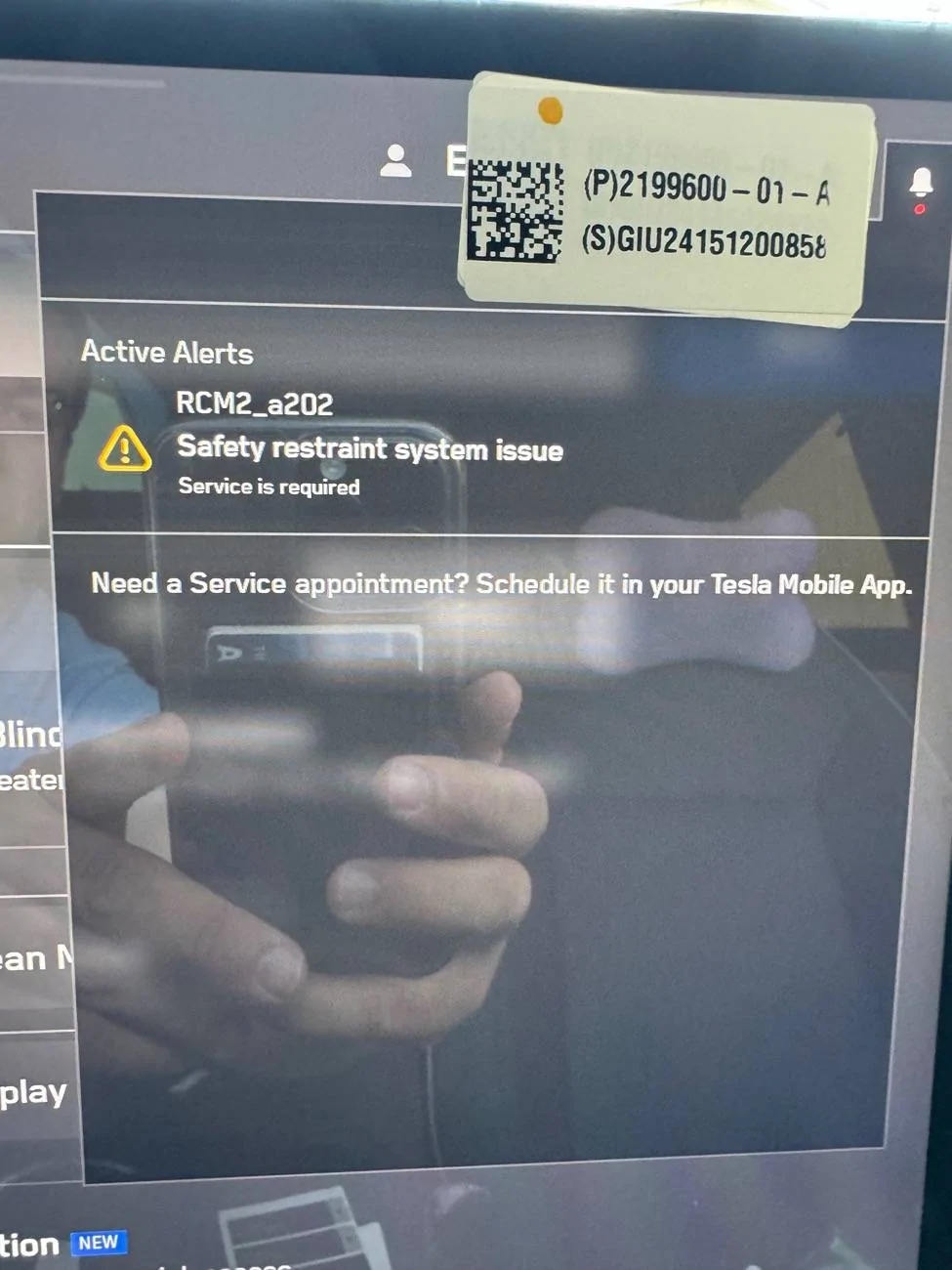

This keeps flashing and driving everyone crazy lol any clue what this is? Anyway we can mute or silence it?

I have same issue, every once in a while, I can get a drive in with no beeps or warnings, other times it goes off every 20 seconds

Did you take it in for service?

I have the same issue for months now - still waiting on service. SC told me bring it in - they estimate 2 days and no loaner. I’m going to wait for all at once I have like 11 other issues for them to fix.
I usually just yank the seatbelt hard then it went a way.
i believe it is a big safety issue. I told my wife not to drive the truck until I get it fix.

I had the same issue back in June, it’s related to a faulty sensor for the airbag and SC ended up replacing entire drivers seat. Once they replaced seat haven’t had the issue come up at all and we are now into September with 5k miles
