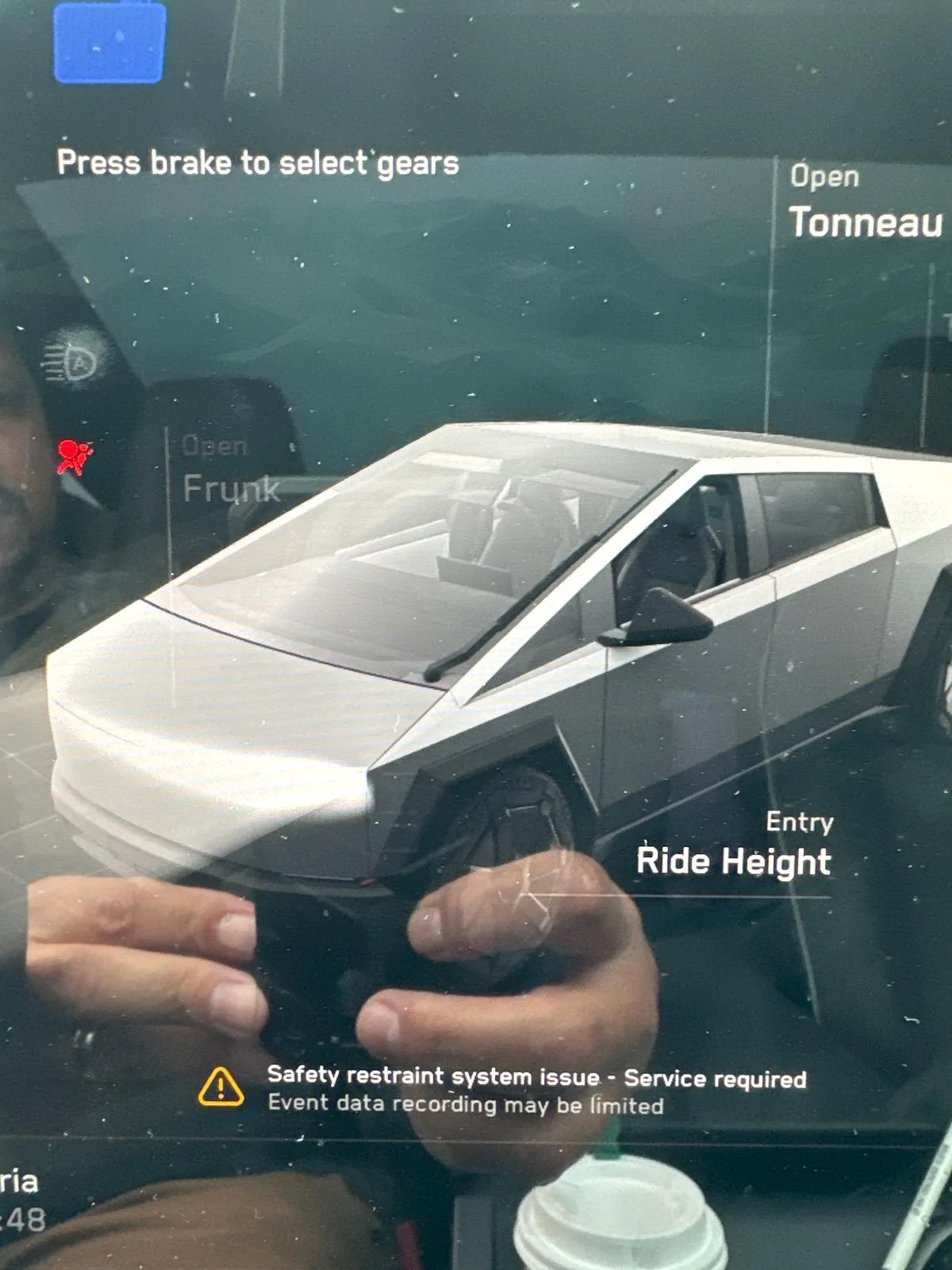

I got this error message:
Safety Restraint System Issue - Service required Code: RCM2_a365
I just hope this is not rodents eating the cables like on my model Y before I installed recipients soaked in peppermint oil underneath the frunk. The airbags are disabled…

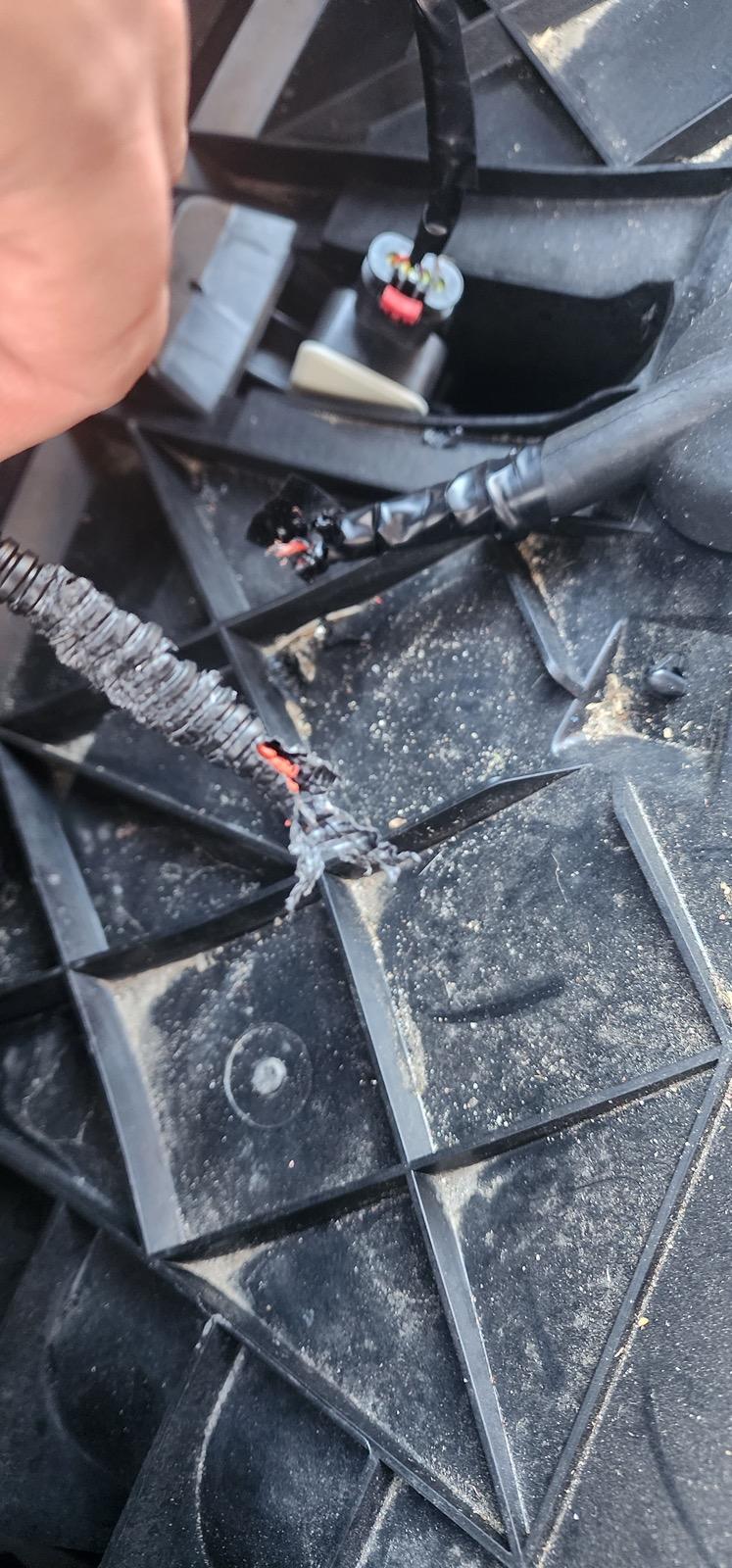

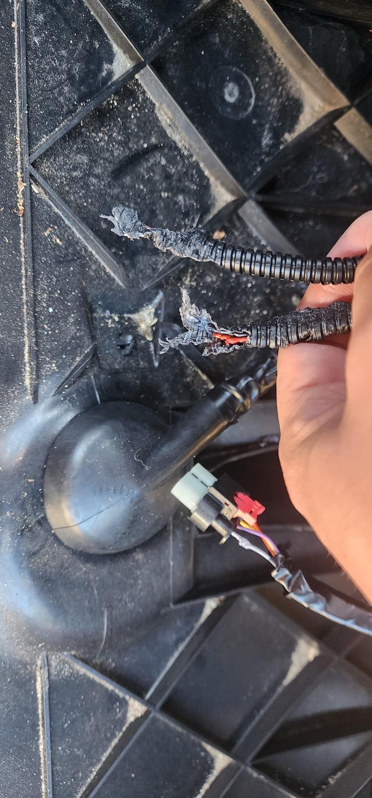

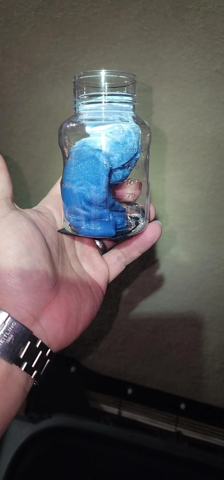

Ohh, sorry, yes, recipients filled with a cloth soaked in peppermint oil. I attached those with zip ties and cover the cables with pepper rodent tape made by Honda

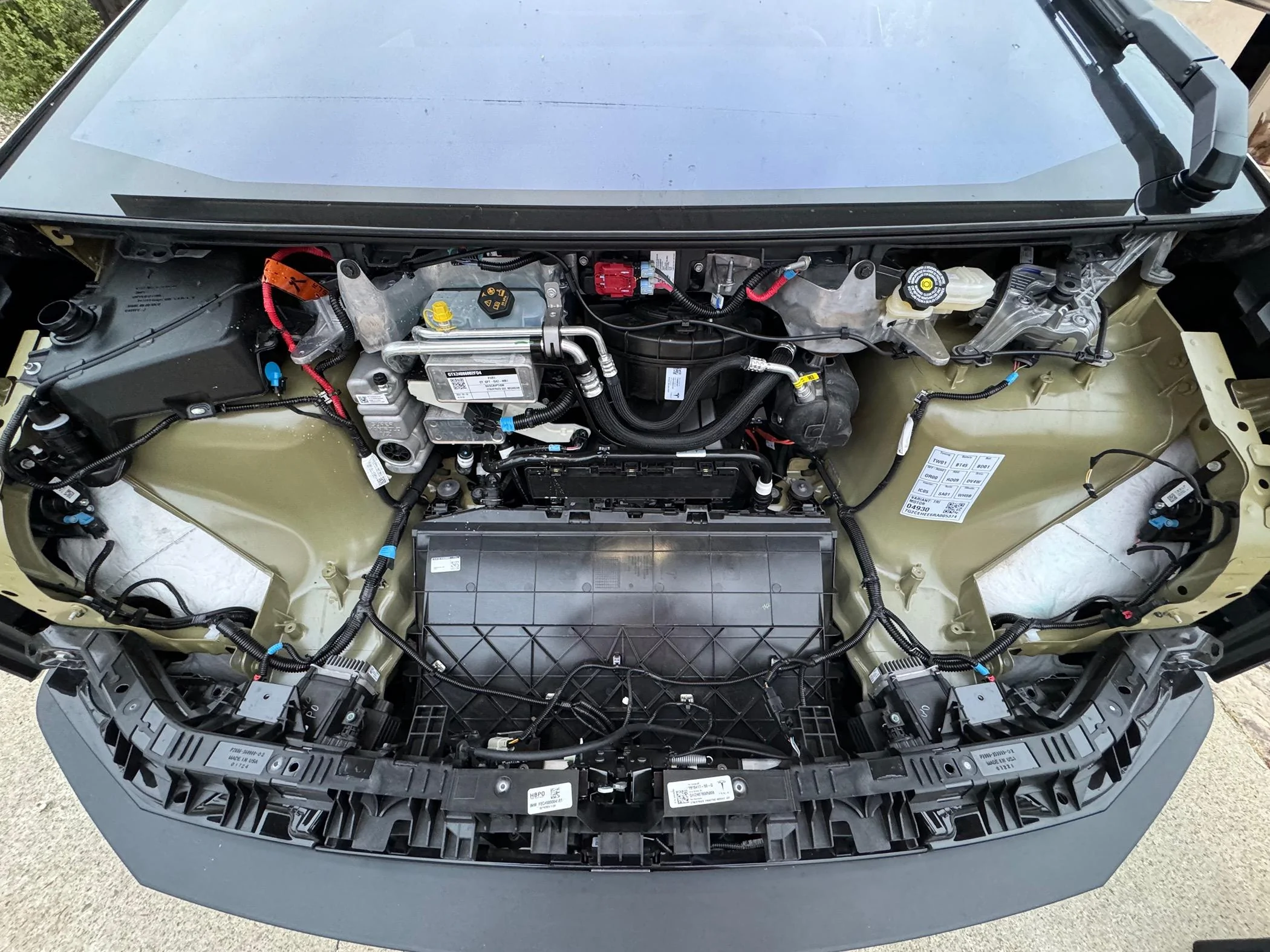

I removed the frunk of my truck and find no traces of rodent damage:
