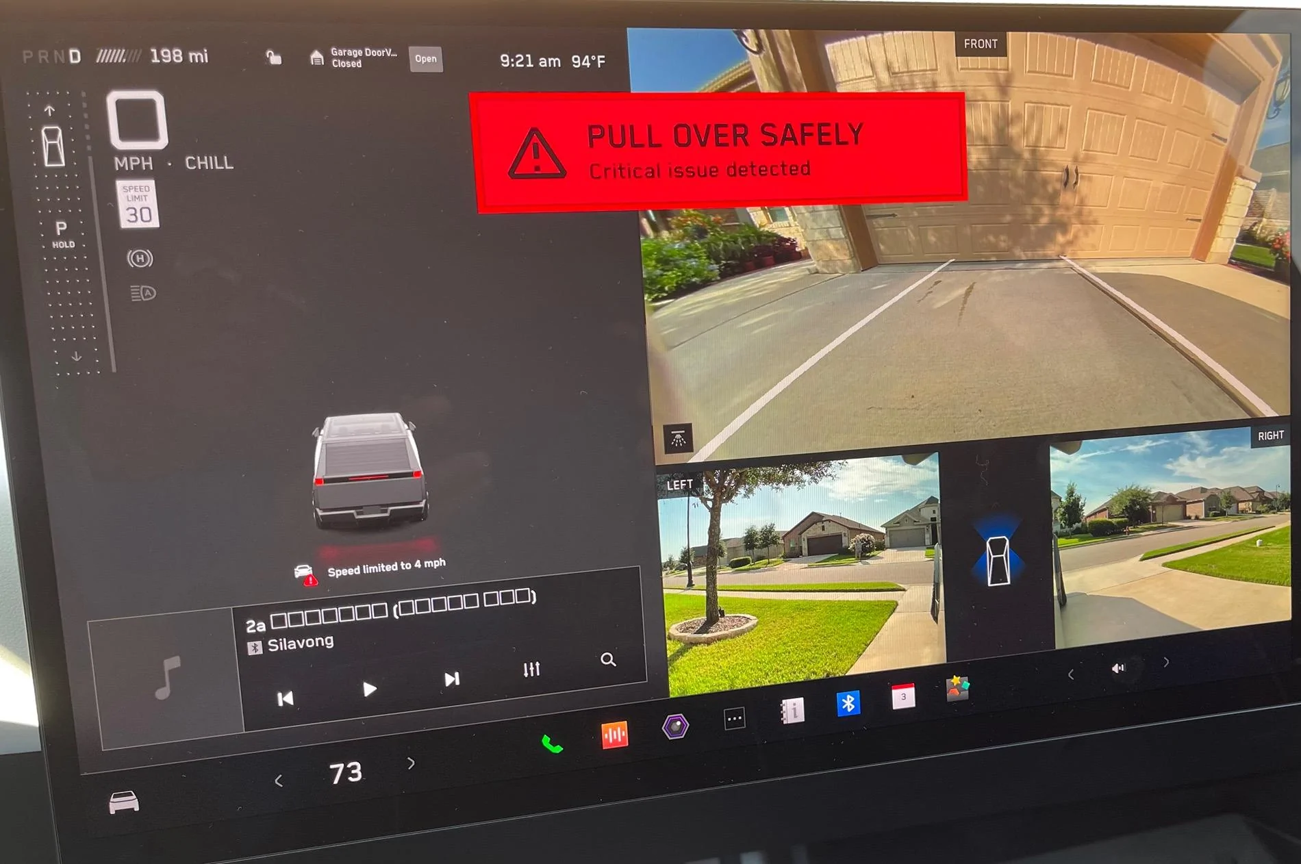

Date: Aug-03-2024
Tesla Model: Cybertruck Foundation Series
Vin# (last 6 digits): 02006x
Odor meter: 545 miles
Age: 4 weeks (28 days, delivered: Jul-5)
Software: v12 ⁦(2024.20.9 1a02147be9af)⁩
Issue: The red flashing message “Pull Over Safely. Critical Issue Detected”
Details: This is a data point of CT FS issues in our CT Owners Club Forum; and this is not an insult message to Tesla engineering. The CT ran fine yesterday. This morning I backed it out from garage and surprisingly found the issue (see photo); and here are my main actions:
Calm and patiently read the pop-up messages and followed (without any good results) > Called the Roadside Assistance > Rode the tow truck to Tesla Service Center > Drop off the CT > Pickup a loaner Model-Y and drive home > Waiting for updating messages in Tesla App (The estimated service time is 1 week).

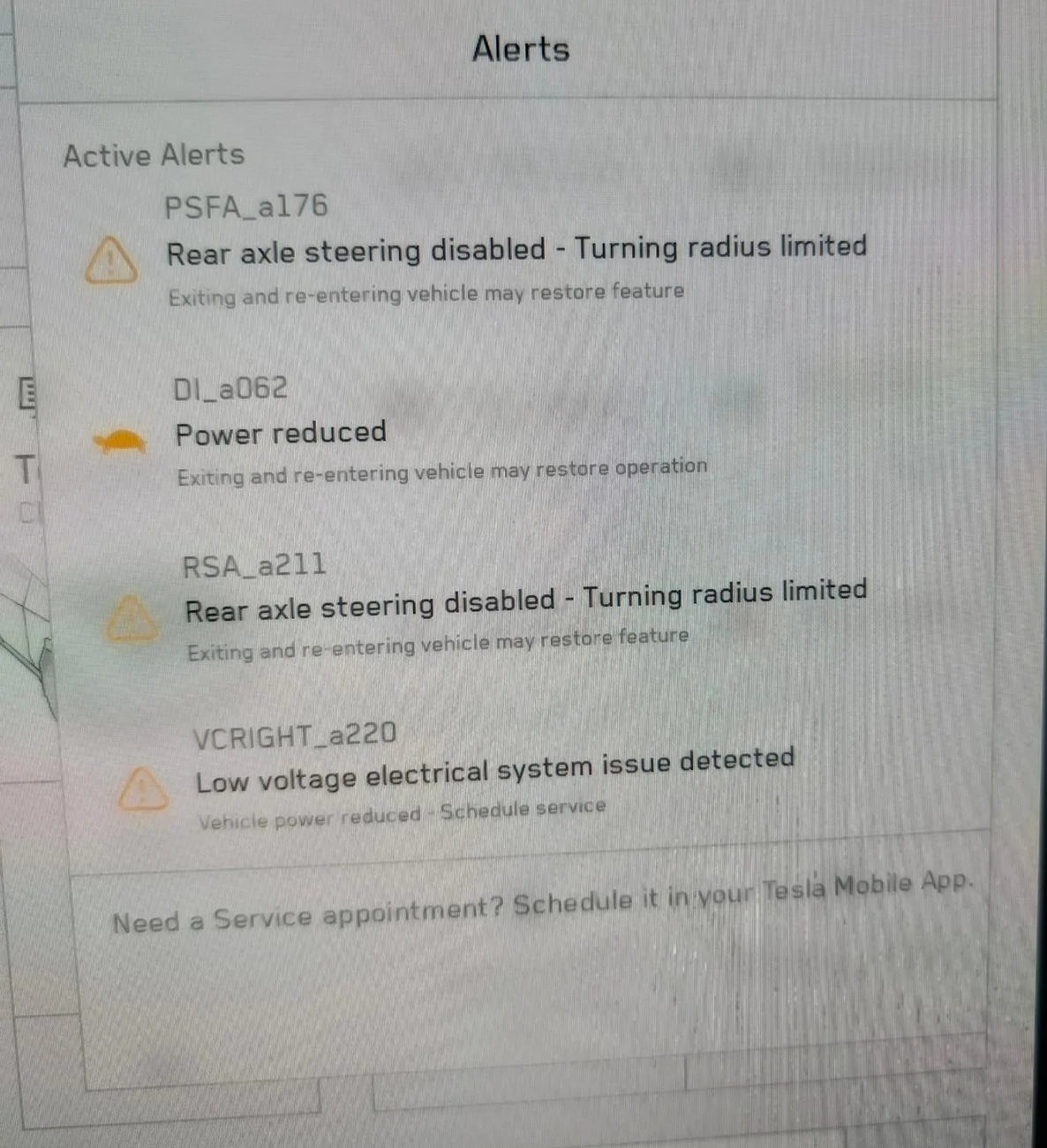

Picked up my Cyberbeast a week ago. Drove it on Monday to get it wrapped. When I went to pick it up later in the week, I received the same error. Rear wheel steering disabled, along with some low voltage error, speed limited to 4mph. Unfortunately, I couldn't make the error to away, so I needed to be towed to Tesla service.
They are saying it should be completed later in the week. Didn't even put 50 miles on... I am hopeful that Tesla can fix it quickly and that it's smooth sailing after. Just posting for reference. VIN is in the 27xxx range.
