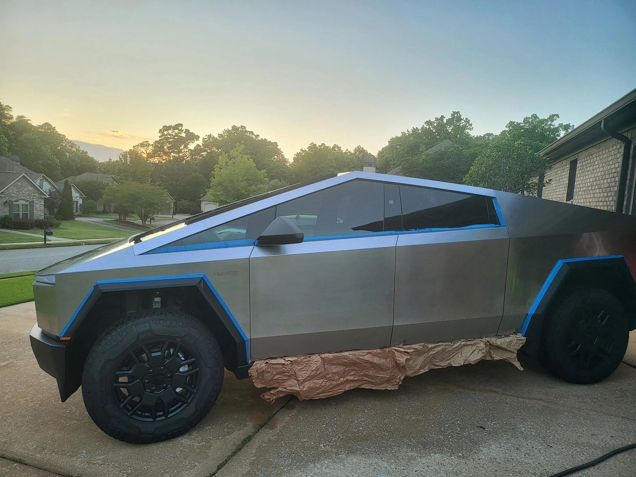

Review updated... "OO7" is armored in ProTectaClear on his driver's side now. Thoughts, experience, problems and solutions discussed.

I've noticed problems with dark spots showing up the next day. So not a fan of the general procedure detailed here at all... In my case they seem to have been caused from the glass cleaners, and/or other high alkaline cleaners.
It's important to rinse after whatever you try, very well.
I would suggest you try any tests on the frunk first instead of the doors. It's easier to get it back to normal it you want to remove an offending result later.
I used a very diluted Citrisurf (80% water) to get the dark spots off the second time it happened and then rinsed it well and dried. - perfect.
The wash Zaino makes, Z-7 is very good, especially if diluted greatly. I've used the rest of the Zaino system on other cars, but the rest of the premium system is really for clear coated cars. The mild wash they make works great on Stainless though.
I agree, a good rinsing and wash is necessary before applying the ProTectaClear. I use Dawn Dishwashing soap ? for mine and dry with a chamois before applying. Will find out what it looks like in the morning after it dries. Looked great after application.
