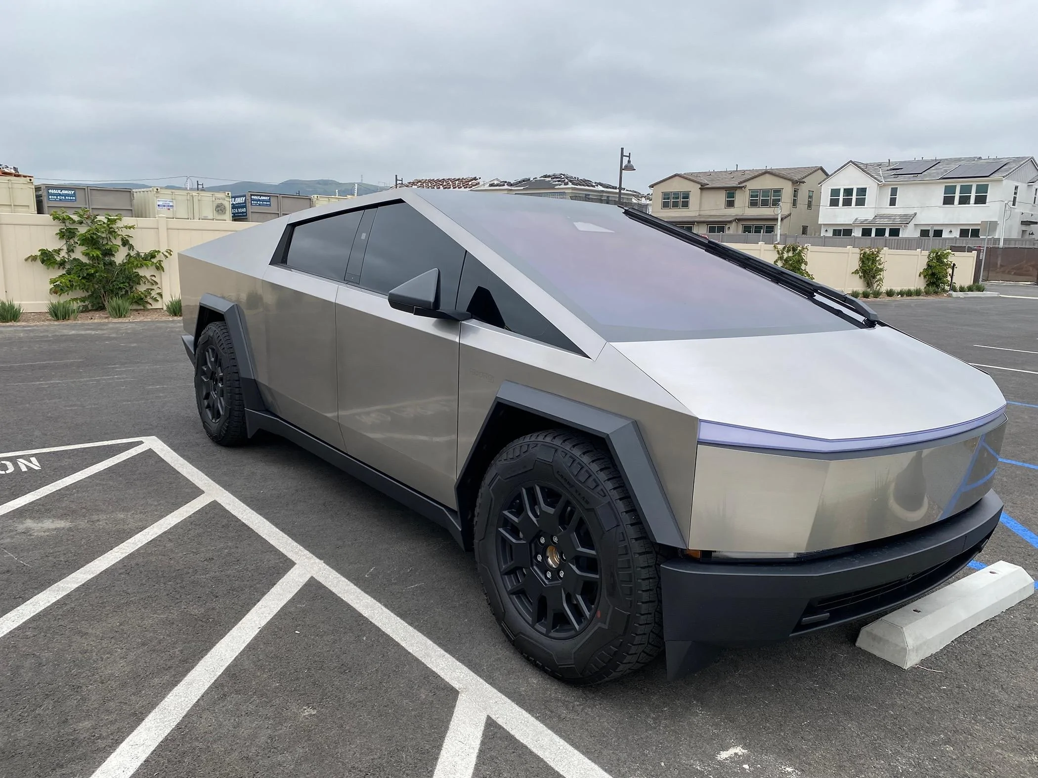

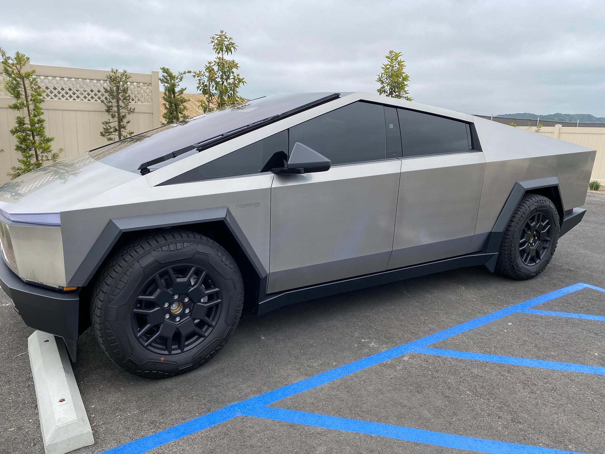

Here are a couple photos. Maintained the stainless character well. I opted not to over polish the truck before application. It does look unlevel at times after application, but does seem to level out pretty well. There are a few spots I can see a ripple, I will probably hit them again with a new applicator sometime in the future. Curious to see how well it washes now. I plan to let the truck sit 4 days to cure well before driving. Not sure this is necessary.
