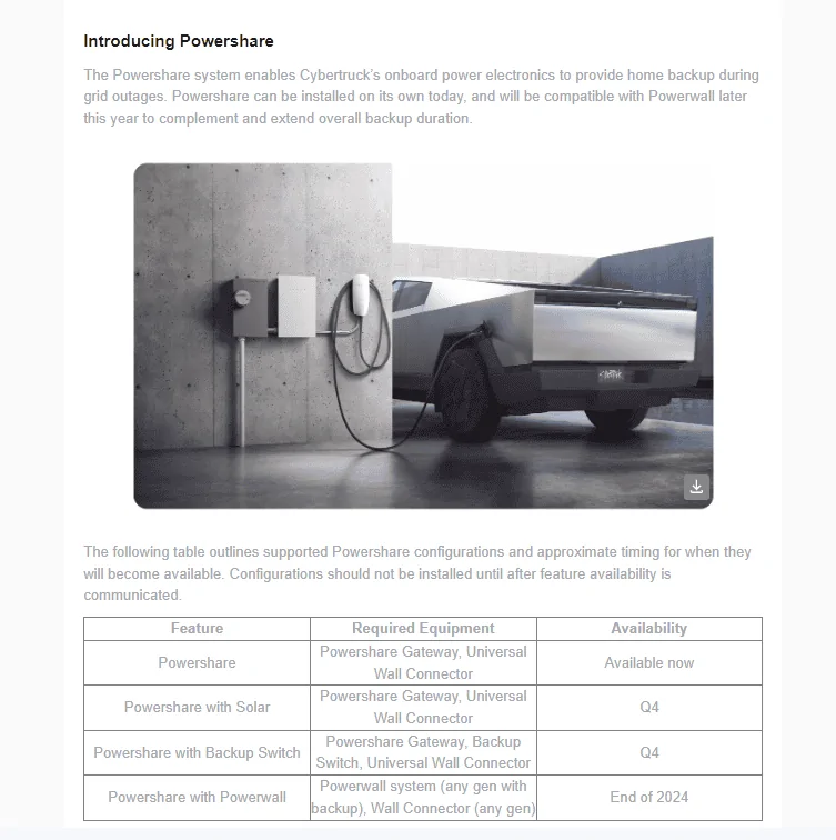

I have encountered many people that have questions about the Powershare feature, what is currently required for install, and how it works.

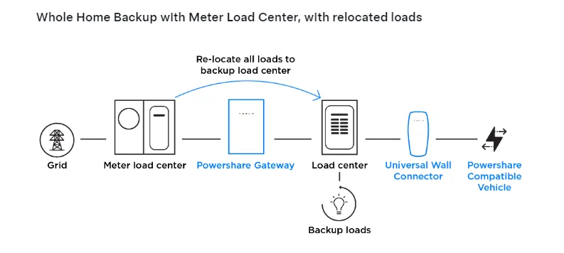

At the time of this writing, to use the Powershare feature, a Universal Connector and Powershare Gateway must be installed. No other gateway or connector will work. Also, the home cannot have A/C coupled solar or battery. The reason being that Tesla has not yet fully developed the metering required to monitor frequency shift during an outage, which would potentially cause a hazardous direct short. This will change as hardware compatibility develops.
When using a Gateway, the loads that are being backed up will need to be moved from the existing electrical panel to circuits within the gateway or to a new load center connected to the gateway.

As always with Tesla, the best is yet to come. As they develop the required hardware and software compatibility across their components later this year.
One of the biggest improvements in home energy is Tesla's Backup Switch. The Backup Switch is an islanding contactor that is installed between the utility meter and the utility meter socket. This isolates the whole home in the event of a power outage and negates the need to move all of the home circuits to a backup load center as shown above. It has been approved by some utilities in the US and many people in Southern California are awaiting SCE approved implementation of the Backup Switch. This will reduce Powershare/backup installation cost drastically.
Here is a timeline of expected configuration availability from Tesla
I hope this helps.
