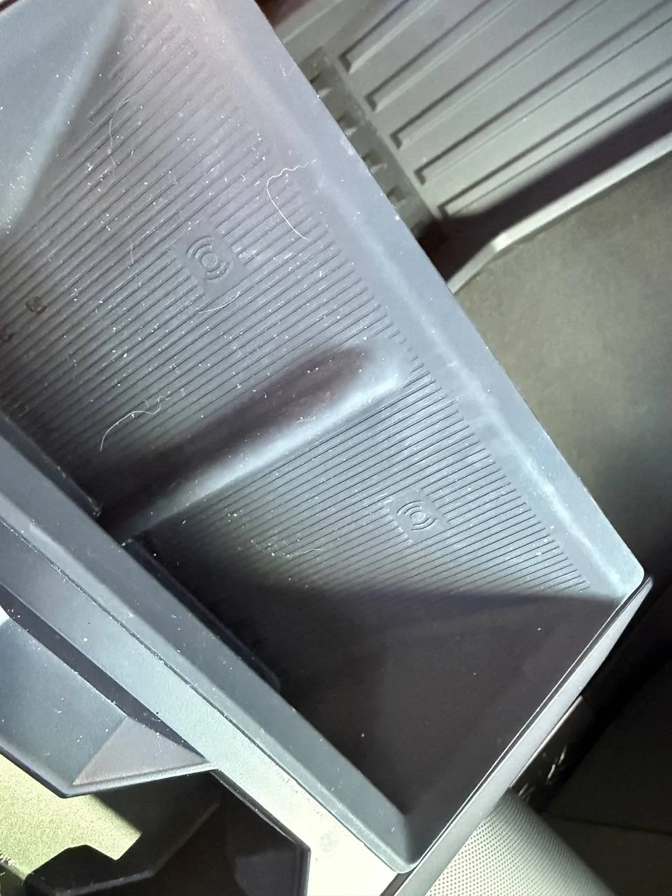

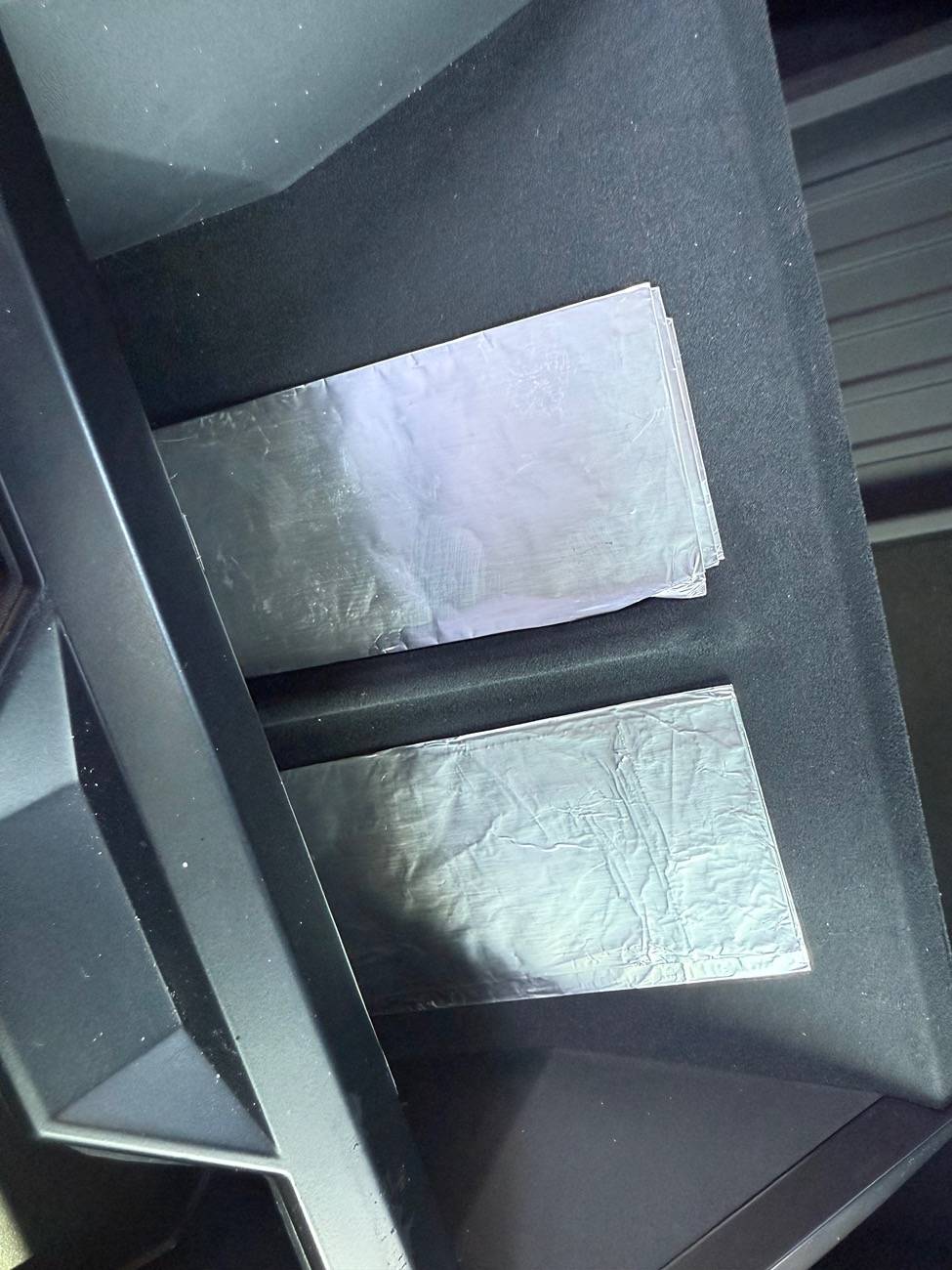

Get a silicone insert for the wireless charger and fold a little aluminum foil between the silicone insert and the charger. This will essentially disable the wireless charger. Don’t make the aluminum too wide on the driver side and the key card will still work when needed. I wish there was a better way but at least this allows you to drop a phone in without it getting overheated. Better off getting a magsafe charger for the display.
