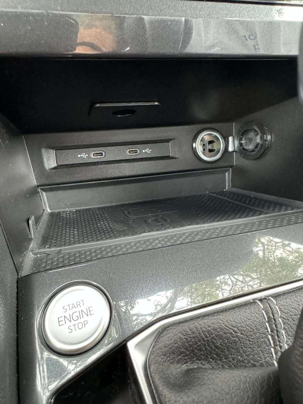

GonePlaid
Mar 12, 2024
30
Sonoran Desert
2018 P100D X, 2024 F-Beast CT
Tesla Roadster 2nd gen Phone Charging - iPhone 15 getting super hot IMG_5666
I thought this solution was interesting. Not only did my Iphone 15 not overheat but it has an AC hole/vent directly above it that I could feel cool air coming out of because apparently this must be an industry issue. This was a VW rental.
Really wish Tesla would be put more thought into something that is such an important element for our lives these days.
