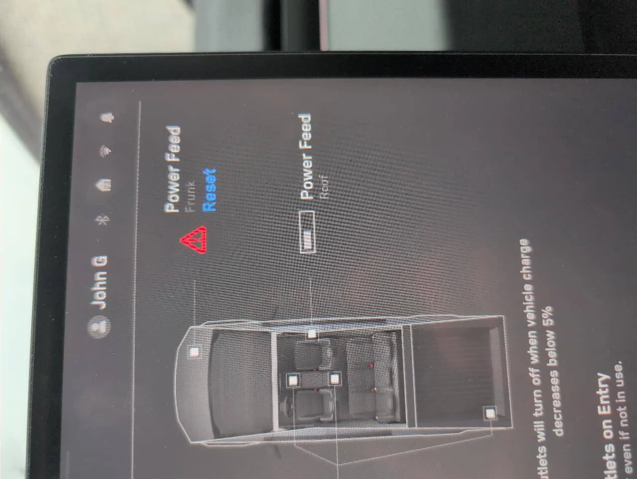

I installed my light bar a week ago and I haven't noticed any Hiss sound from the speakers. Ordered from Tesstudio. I also just installed the power running boards from Tesstudio and run into a problem. Both accessories Tie into the BUS connector in the dash on the passenger side. I'm not sure you can stack these together. Because I get an error on my Frunk power switch (Where the running boards tie into). SO they are not working at the moment. And so far Tesstudio has been hard to reach regarding this issue.

I've done a lot of research on this and I think we need a BUS splitter or Y. Because daisy chaining both of these in between the factory plug I believe is causing the problem. It is not affecting the light bar, just the steps.

generally agree with your assessment, but not sure if these companies will be sending anything like that any time soon.

I'm assuming that the hissing is coming from the DC-DC step down converter?? I've seen recommendations to put it into a Faraday cage to reduce the radiated noise.
