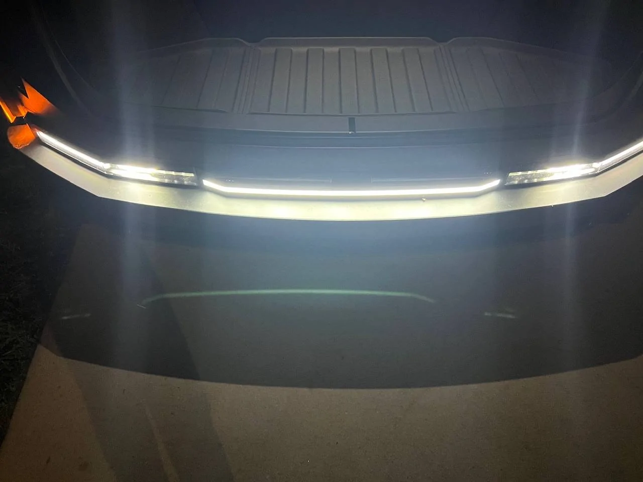

I saw a new bumper light bar come out last month and decided to give it a try. It’s sold by a few different Tesla shops but looks like every one is from the same factory. Either way, it’s a quality light that matches the stock lights nicely and gives a cool new look.
The install was easy - it does require some disassembly of the frunk liner and a little bit on the passenger footwell. Included in the package are all the wires and harnesses that are plug and play with the stock connector.
One thing is it does stick out a little bit further forward than the stock plastic piece so it is a bit of a tight fit to hit the fronk switch.

I’d say the intensity matches the stock light strip on the outside of the main beams. No adjustment for brightness.
Not sure how much install would cost…it took me about an hour. I could probably install another one in under 30 mins now.

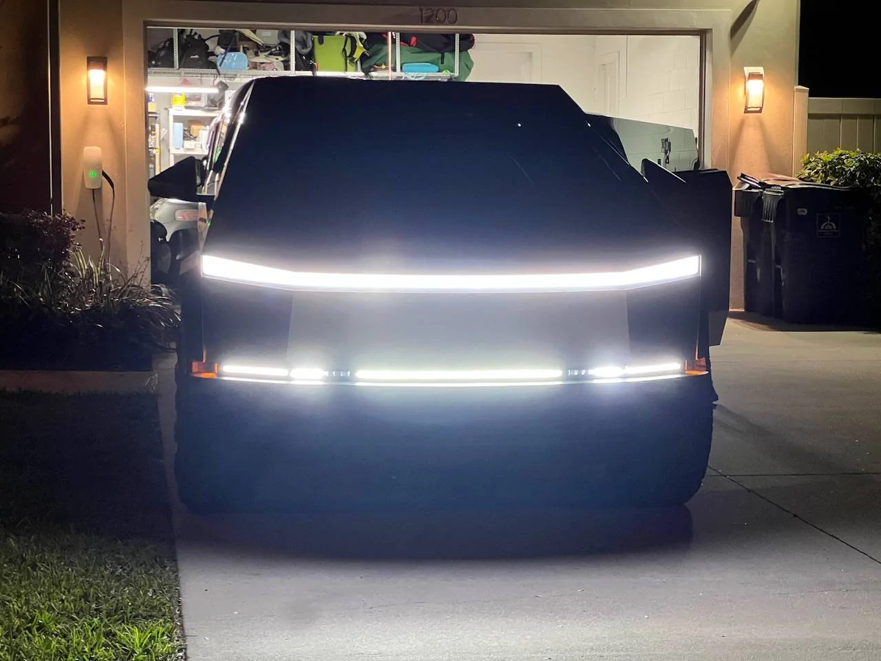

Those look better than many of the other light bars.
Are you able to see each LED or is it similar to the CT’s bar with a light diffuser layer? It doesn’t look like you can see each LED from the pictures but I can’t tell if that’s due to the camera exposure.

It looks very similar to the stock Tesla light bar. The diffuser does a good job making it hard to see any individual LED.
One interesting function is during the light show the light bar would remain on the entire time despite the left headlight going on and off with the show.
