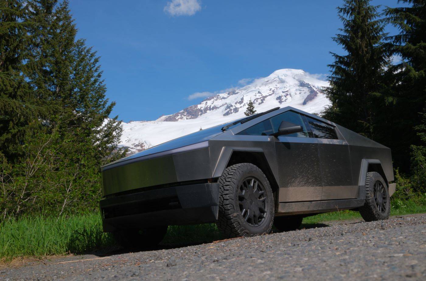

That looks like a clean and shiny truck. You must wash it all the time.
That's pretty funny!
It's actually very dirty and mud spattered, it just doesn't show up very well because the metal reflects light through the dust and mud. The snow reflects a lot of light too. It hadn't been washed for two weeks (except I clean the windshield whenever it's dirty with a long-handled tool), and the bodywork had three days of off-roading on it by the time I got stuck. It does get cleaned up by the rain because I park it outside 24/7. Here's a photo taken three or four hours before I got stuck. Even here, it's a lot dirtier than it appears, the metal just wants to shine through! I love it!
Tesla Cybertruck My Cybertruck finally got stuck. Self extracted with manual ratcheting winch (AKA come-along) DSCF0891(1)adsm
Also, driving through sloppy old snowpack is one of the best ways to clean the mud on the tire sidewalls off. And I had been driving through a lot of old snowpack, even before this photo was taken.
I've been saying how easy it is to keep the Cybertruck reasonably good looking since a few months after I took delivery. I just wash it with a bucket of soap and water and a long-handled brush once a month or so. Way easier than my F-150.
